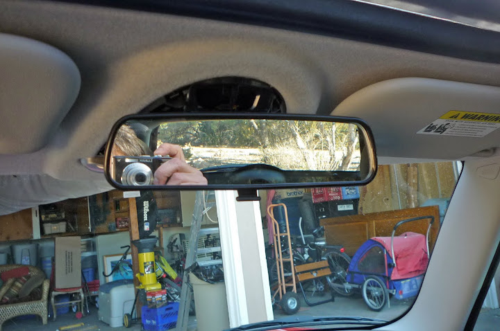

Ah HA! Rearview mirror problem almost solved??
Originally Posted by AustinS
I have an '09 convertible and if your coupe's mirror is the same, you are just being too timid. It does just take a twist and it comes right off.
What I don't understand is: what do you do then for a rear view mirror? Or do you just use the outside mirrors?
Two options, one is very very easy:
1) Buy one of these:
AMAZON
or
AMAZON
It's a tiny mirror you stick to your glasses/sunglasses which apparently (believe it or not) gives a nice rear view (I''ve never tried it though I've had an new unopened unit here on my desk for months for bicycle riding).
Of course this means the driver needs to be wearing sunglasses or RX (or clear) lenses...but hey...might be a really nice, cheap solution.
2) I'm still working on this one.
I bought a $15 day/night replacement mirror from a Pep Boys Auto Store...
from holding it up by the overhead switches, it looks like it will mount nice and high and completely out of the way of the view thru the windshield.
Yesterday I took apart that plastic shroud behind the overhead switches, looking for a nice firm mounting point...so far, this doesn't look easy...I don't see a nice solid surface.
But...
Mounting this $15 mirror in that spot would almost look "factory", esp since it has the day/night function.
Attached Thumbnails How do I detach the rear view mirror?-img_2509.jpg   How do I detach the rear view mirror?-img_2507.jpg   How do I detach the rear view mirror?-img_2506.jpg

SUCCESS
This is what I did today...took about 4 hours...would take much less time (1 hour?) if I didn't have to figure a lot out. I must say a BIG thanks to cjmadura, as he got me most of the way thru it (he did not install a replacement mirror).
1) removed my rear view mirror,
2) got the remote-receiver circuit board out of the mirror housing,
3) placed it up in the headliner, and then,
4) installed a $15 replacement day/night mirror that is virtually 100% out of the way of the view thru the windshield.
THE VIEW IS AWESOME.
I'd post all the pics and instructions here...but I see that I can only post 3 pics per posting...so I put it all in a Picassa web album...I hope to figure out how to put the whole process here (advice please?).
Enjoy:

awesome job! the pictures/instructions are fantastic. respect your perseverance. glad all your efforts had a happy ending. i know my projects don't always. as for the pics, you can insert them throughout your text using the picture icon and refer to the Picasa image url as i did below. i wouldn't bother, though, since the Picasa album with the labeled pics does the trick perfectly.
