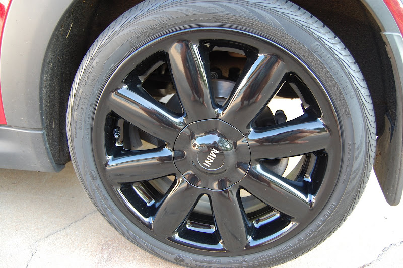

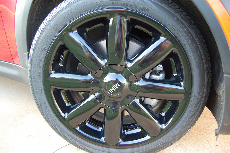

Great question.....I just spent the last week doing just that.
It was lots of work but well worth it.
1. I used red scotch brite to scuff the original finish, then cleaned the wheel/ tire very good to get all the brake dust and tire shine off. (yes I did it with the tires mounted to the rim, not my first choice but did not have any other eay at the time)
2. using VHT epoxy paint, I out a total of 6 coats of black ( that''s 3 coats for each spraying with several days of drying in between) remember to resand between each spraying
3. then re-sanded and applied three coats of dupli-color acrylic lacquer
I'm more that happy with the results....how well will the paint hold up... I have no idea but it looks awesome.
Prep. is the key you gotta get the surface ready and very clean and in a dust free (haa haa) area.
I used about 3 cans each of black and clear about $6 per can. Yes it would be better to have it professionally done but be ready fo pay big $$$, automotive paint and the associated materials are very expensive and then you got the labor on top of that.
HEY wait right there while I go out and take a couple of Pics.
OK I'm back:
Thats dust on the wheels, I cut the grass yesterday and.....well you know

WOW! Those look professional! Great job dude thanks for the advice i might want to do it on my own now i just need to buy some new winter tires for them because their is no way i am driving these "Z" rated tires in the snow and messing up my new wheels.
