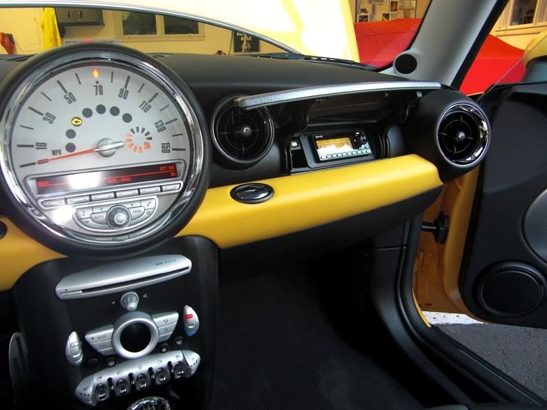

Unfortunately, there was no option for getting an XM receiver in the MINI..since we have 3 XM units (Garage stereo, portable unit and built in with the C6 Vette stereo) thus no way going with Sirius (which as of today is moot since the XM-Sirius merger has been approved by the Feds...will be interesting to see the new subscription pricing ) Not to be denied, I began the research and search... first nothing on the market that is a XM module that would be a 'plug & play' allowing to use the MINI stereo (I have the upgraded version) head as a controller such as with the Sirius unit..would have been great but just ain't out there yet. I did not want to have a portable unit plugged into the aux input/power outlet in the center console...just looks unfinished. So...I think I found a good solution (few compromises...more on that in a moment) Audiovox XM CommanderMT receiver. I purchased online from Best Buy (they price match) and decided to have Best Buy 'Geek Squad' do the install... the Best Buy in Reston has a fellow who is really excellent on installs otherwise I would have been a bit hesitant to go to Best Buy as opposed to a custom stereo shop. So here is the result and can not be more pleased...looks like is came from MINI built in...
Here is the XM antenna (am working on how it can be installed into the base of the OEM antenna).. also the stubby is from OutMotoring
The CommanderMT comes with a 'XM mini tuner, display controller, FM direct adapter, antenna, cables, remote etc and two mounting devices. You can run the signal thru the FM (which is OK sound) or...this is the good part... output from XM mini tuner directly into an input in the center console thus excellent sound quality (just set input from tuner to aux and you have XM). Second very cool thing is the DIN Opening Trim Bezel (one of the two mounting devices included in the kit) fits absolutely perfectly in the "secret compartment" opening...just like it was made for it. Power for the unit comes from the same power source for stereo so XM powers up automatically as with the stereo itself. A very nice clean install...couple of pics>>>
The little white button just left of the XM controller is a garage door opener (just mounted with double sided foam tape..basic but it works) since we did not get the homelink option.
Now to compromises:
-Can not control (meaning channel selection) XM from OEM stereo head...would be nice, but since where the XM controller is located (as seen in the pics above) no big deal. Can see info on controller and if you have a passenger they have a great access to controller.
-XM comes with a remote control which I keep in the center armrest cubby. Since you can pre-program in stations just use the remote to change stations...but since remote is IR and not RF must have compartment lid open...if you are a channel surfer lid would be up most of the time...for me I tend to listen to a particular station depending on mood (60's, Deep Tracks, The Joint, World Audio...quite a smorgasborg of tunes )
Total cost (CommanderMT kit and installation): $250
If you are in the Northern Virginia area the Best Buy in Reston is a good place to go for the install...the young man (aka Geek) is good...very good.
