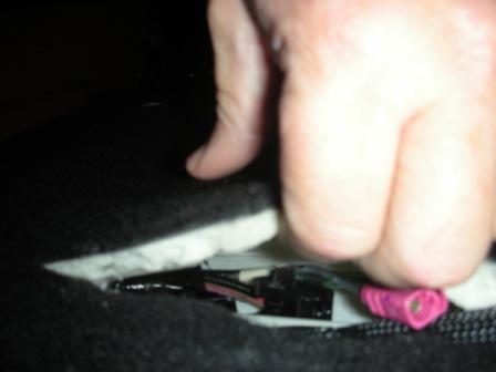

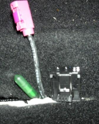

Here is a picture of the Satelite Antenna connection, can anyone identify the others?
Here is a pix of the Sirius Antenna connection. I had to lenghten the slit in my carpet, under the passenger seat about an inch on either side. The cable was taped to the floor about 5" towards the rear of the car. Does anyone know what the other two connections are for?
Attached Thumbnails Satellite antenna connection below passenger seat?-jan-2008-134.jpg   Satellite antenna connection below passenger seat?-jan-2008-136.jpg   Satellite antenna connection below passenger seat?-jan-2008-135.jpg

The other wires are for the same thing, the Sirrus sat radio unit that mounts there under the seat. Those are the power and control wires to it, as well as the fiber-optic music signal wires that go to the head unit.
