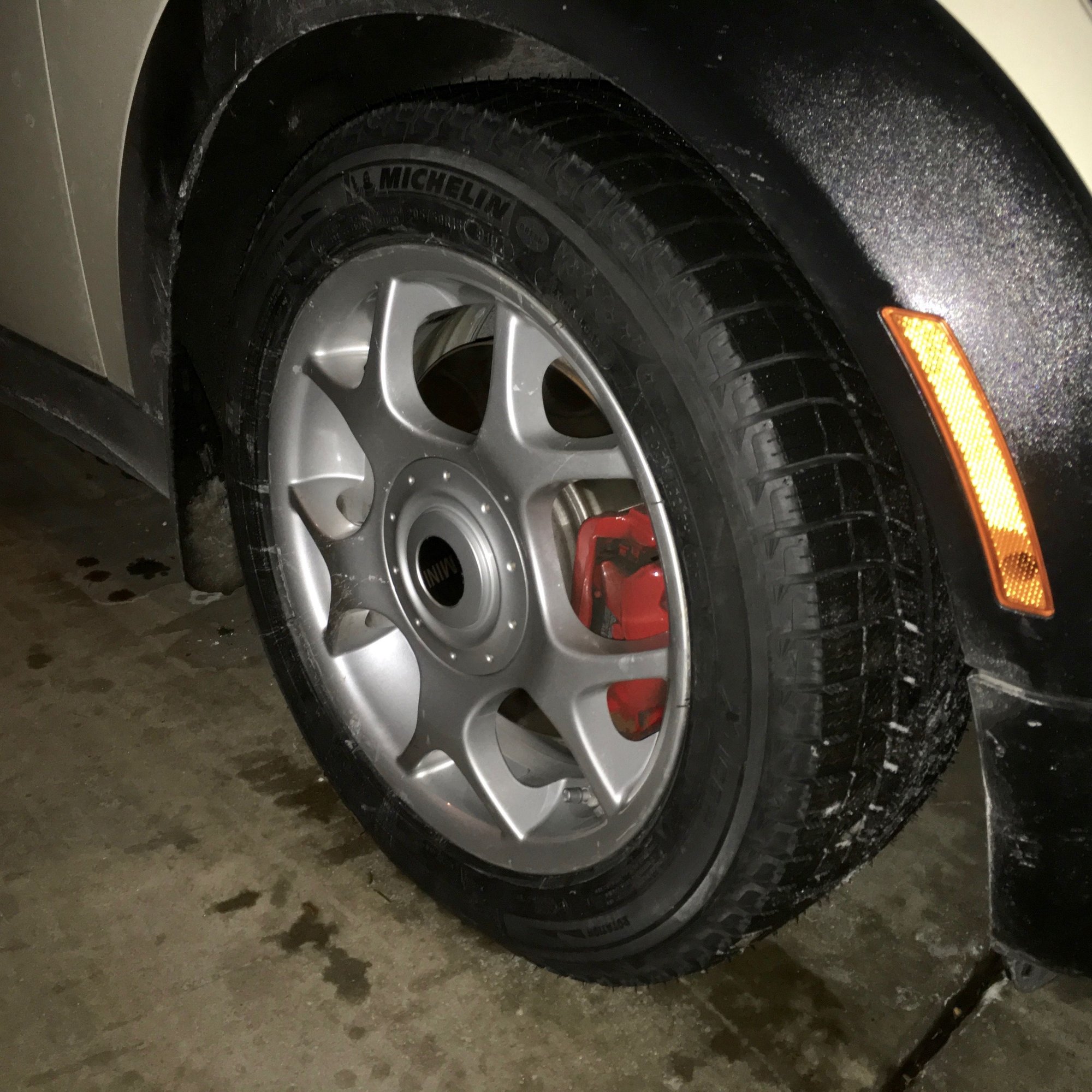

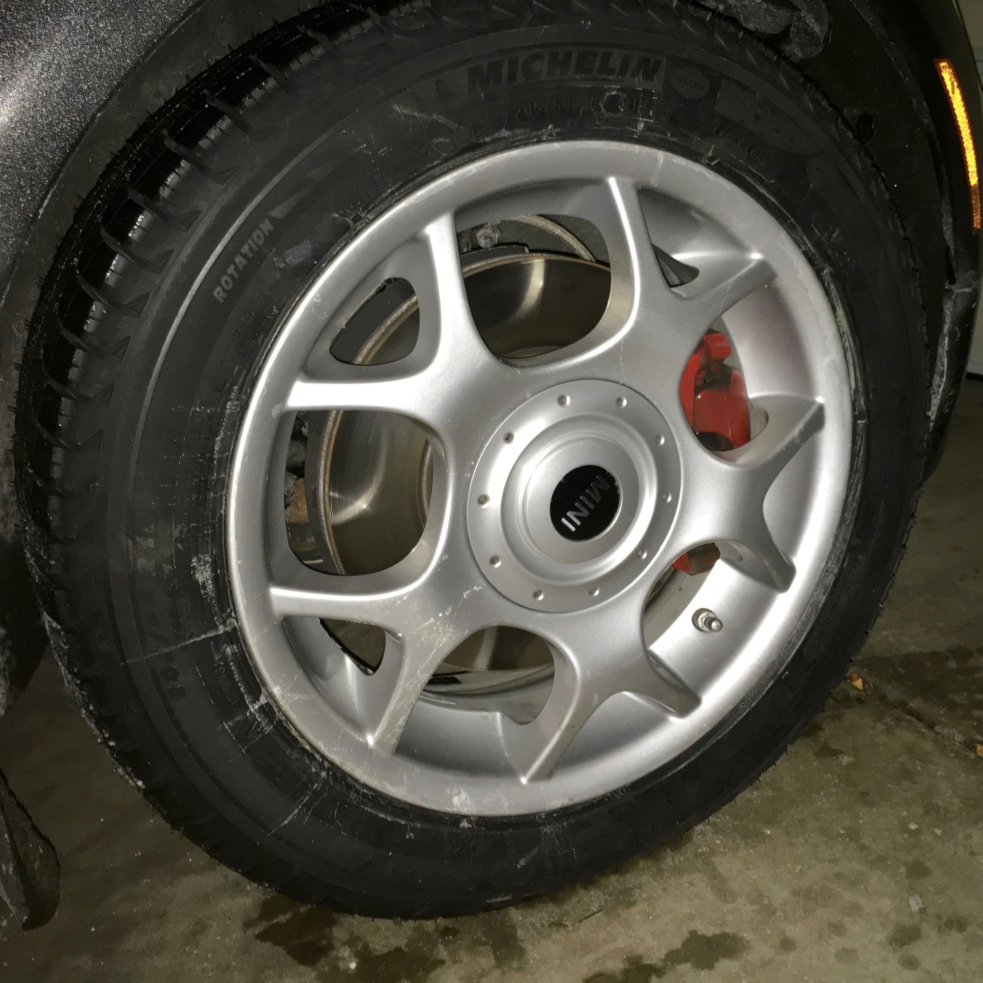

To definitively answer this question...I can say that you CAN run R84 X-Lites/V-Spokes on the Gen2 MINI Cooper S (thus the Gen2 Justa as well). Clearance is tight with the front brake calipers, but they do fit. Just make sure that when the tire shop is static balancing the wheels/tires, they do not use tape weights inside the wheels. Tape weights inside the wheels will hit the front brake calipers and probably cause you all sorts of headaches. If they can put the wheel weights on the inside lip of the wheel, then there will be enough clearance for the front brake calipers on a Gen2 MCS.
Additionally, the wheels will accept TPMS sensors. I purchased a set of sensors with my Michelin X-Ice Xi3 winter tires from Tire Rack, and they ended up being Huf TPMS sensors for $51/each (which is about $10 cheaper than anywhere else).

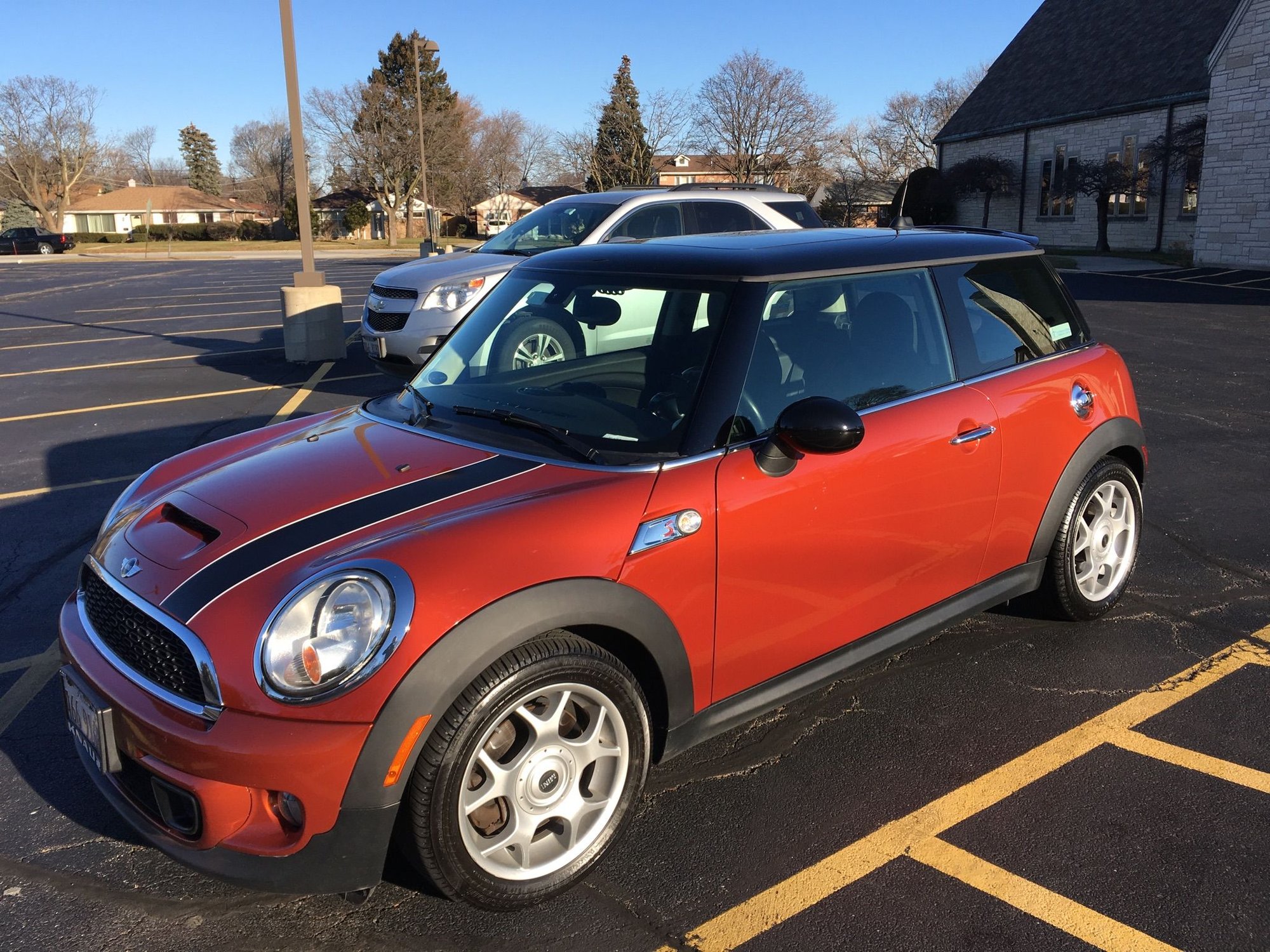

Also photographic proof of R84 X-Lites/V-Spokes on my 2013 MINI Cooper S Clubman...

^Wow, that is a tight fit, but nice! Great winter set-up with the taller side wall (not to mention cheaper snow tires in 16"). Factory lugs, right?
Not that we care much, because we visually inspect our tires, but Discount Tire could never get TPMS sensors to fit in the Compomotives I put on the car. They tried them backwards, a different brand or two, etc, with no dice. Considering these are basically rally wheels, I think the construction is just too beefy.

Yea, its tight, but works. Nice to see the R84's on a newer MINI If you have gen2 JCW brembo brakes you will need a 17" wheel. If you have the rare early Gen 2 JCW single piston brakes, they should fit also. I have 15" spiders on my gen 1 with stock brakes and its tight.

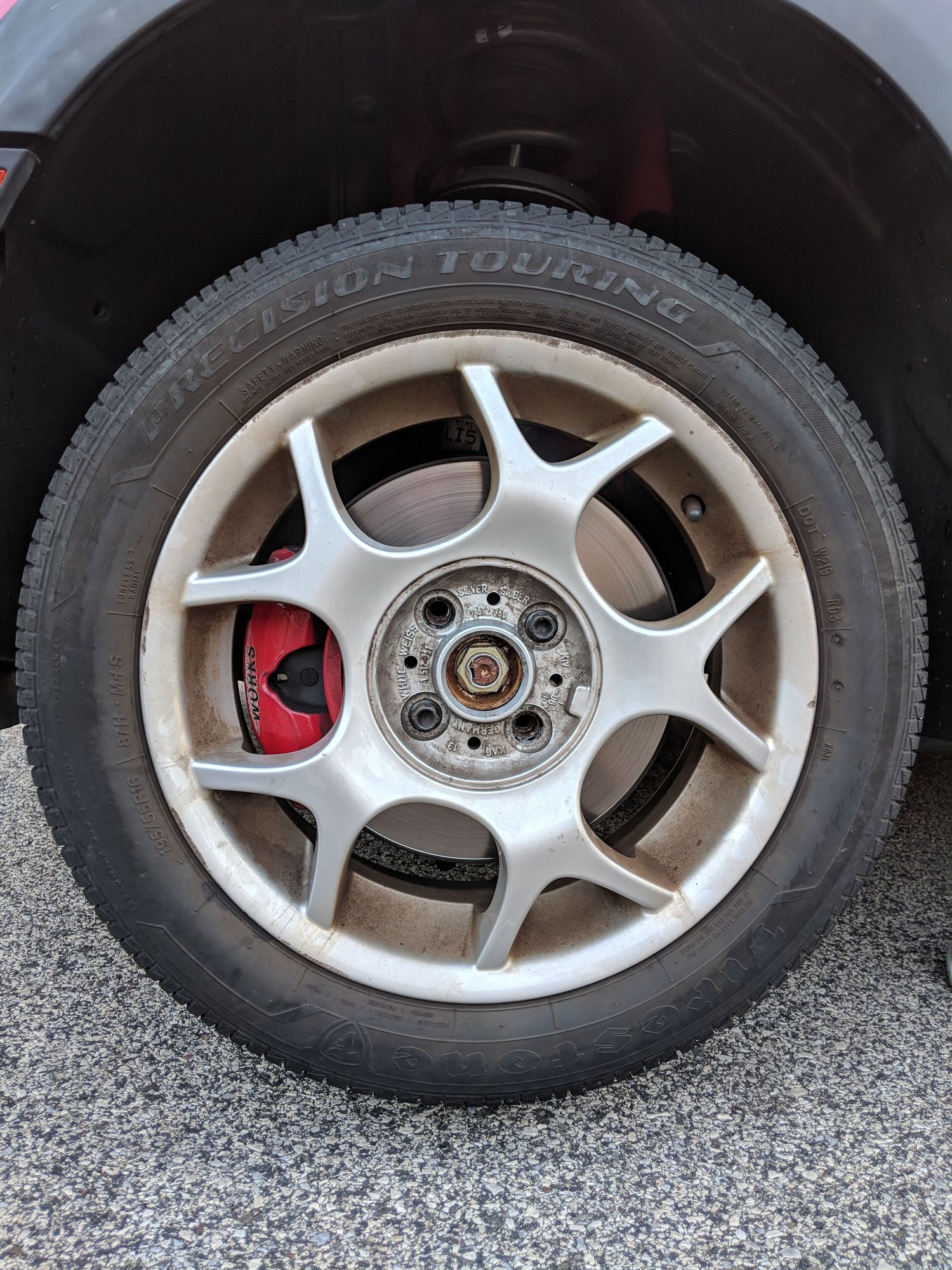

To add another data point, R84 wheels will fit over JCW brakes on the R53. Here are some pics. There is about a penny's thickness of clearance between the caliper and the wheel weight.
