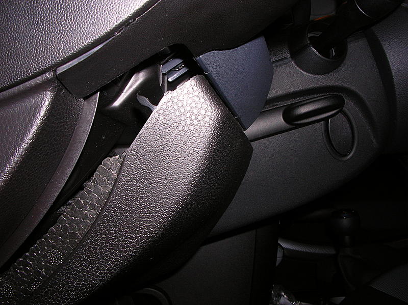

So, I was on my way home from Ritz Camera tonight when i happened to notice that the lower dash under the steering wheel has started to detach from the upper part, just below the left airvent near driver's side door. It kinda looks like something just popped out of place, but i'm not sure. When i got home and in the parking garage, it was too late and with crappy light to take a pic. Hopefully I can get one tomorrow and post so it makes a little more sense.
Has anyone else had this happen? I took delivery of my 08MCS about a month and a half ago. I dont know if it's something that can be simply popped back in or if i have to make an appointment at the dealership.
Any thoughts/suggestions are appreciated.
Thanks.
EDIT: here is a picture...
Attached Thumbnails Dash under wheel starting to detach ... ?!?!?!-dscn2028.jpg   Dash under wheel starting to detach ... ?!?!?!-dscn2027.jpg

That panel has two keepers on tabs. The keepers have to accept the tabs in perfect alignment to hold them; if they're tweaked the slightest bit, the tab will look like it's going in but it actually goes to the side of the keeper and then pops out later.
A good pair of needle-nose pliers, a small flat-blade screwdriver, and a nice trouble light will fix you right up.

Yea, it just looks like a fastener has come loose. I doubt it is anything serious at all.

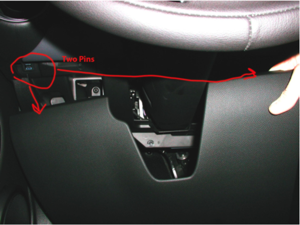

Did you try snapping it back in place? I can't tell from the pictures, but if the fastener there is anything like in the R50/R53, it's just a pressure fitting that snaps together.
Edit to add more clarity:
If you were to remove the three screws on that panel and then pull (really hard) on the opposite side (near the center stack) at the top of that same piece, the whole thing will swing down. On the bottom part of the loose piece, there should be tabs that fit into the bottom of the dash. Then just pivot it back up and snap it back in with some pressure (you'll see where the posts snap into the fitting).
Now if you're super leery about it, then by all means take it in...but it should be a pretty simple fix if you don't feel like going to the dealer.
I added a picture, you can see the circled area...the thing sticking out of the top of the panel in your photo snaps in there. Just make sure everything is aligned right first, and see if it goes back together.

There are 3 screws on the bottom of the knee bolster which generally do not come loose. However, at the top of the bolster there are 2 plastic pins that snap into a receiver. Those pins have a tendancy to break. You can check this by removing the lower screws first and then pulling toward you on the top of the bolster in each corner. Do not pull down but straight toward the driver's seat. Check the pins. If one of them is broken the bolster starts to slip down. Dealer has an easy fix. Just had it done
