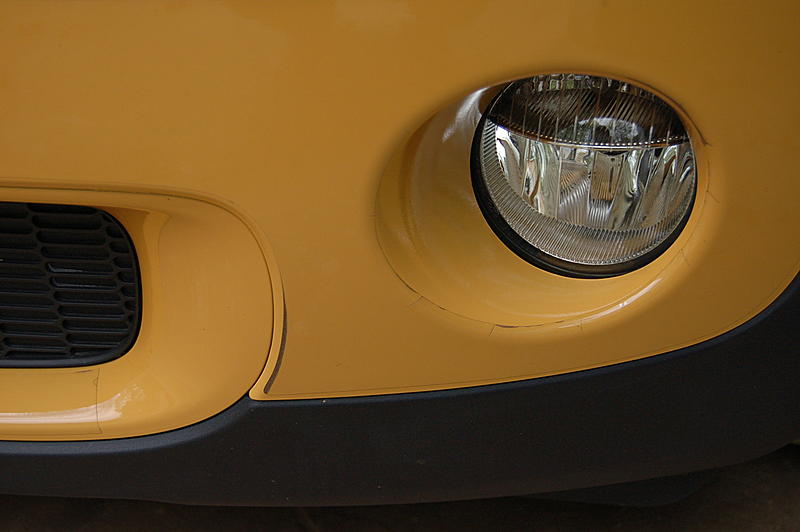

No one gave any long term review on the cheap DIY clear bra so I took a few pictures. I installed DIY clear bra about 6 months ago.
there is a slight shrink on hood part and there are dirts on the edge of bumpers. Actually, I could not wash my wife's mini for 5 months because of severe drought conditions in GA.
so far so good. only spent under $50.
I don't see any chip on entire front hood and bumper

I wonder if you might see bubbles near the fog lights with a pro installation too?

Curious... how do you propose to get the dirt out from the edges where the film didn't adhere properly ? If you pull up on it to clean under there, it's going to just loosen up even more of the film = more dirt under there later.

I won't touch any dirt on the edges. actually, it looks like some shadows
it was only $35 and better than nothing. the film looks thick and it does good job for paint chips so far (I see couple of chips on grill though). since mini has very thin paint, I might see some chips on hood and bumper without the bra.
