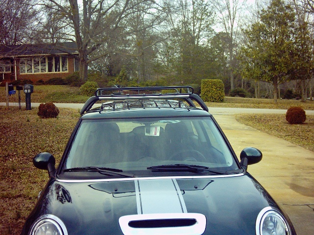

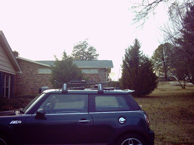

Put the basket back on this afternoon and remembered that I had promised some pics. This is the "large" basket they claim fits the Mini but that some folks have had issue with. The mounting clamps are supposed to mount on the outer two rails on the bottom, were it dips down to touch the cross bars, and I'm sure that is the strongest mounting location for them. Since the Mini cross bars are so short those mounting locations are actually on top of the plastic end caps, so there is no way to use them to bolt through to the channel.
Rather than complain, I simply moved the mounts to the next two inner braces and bolted it down. I make sure to tie loads down to the rack base itself so as to not pull up on the basket as a result, and have yet to have an issue.
