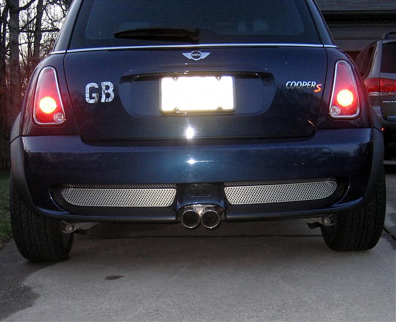

I love the wider wheel look as well
I'm running 18X7.5 PIAA FR-S's and 215/35's, no rubbing at all. The car looks much tougher than with it's OEM wheels
