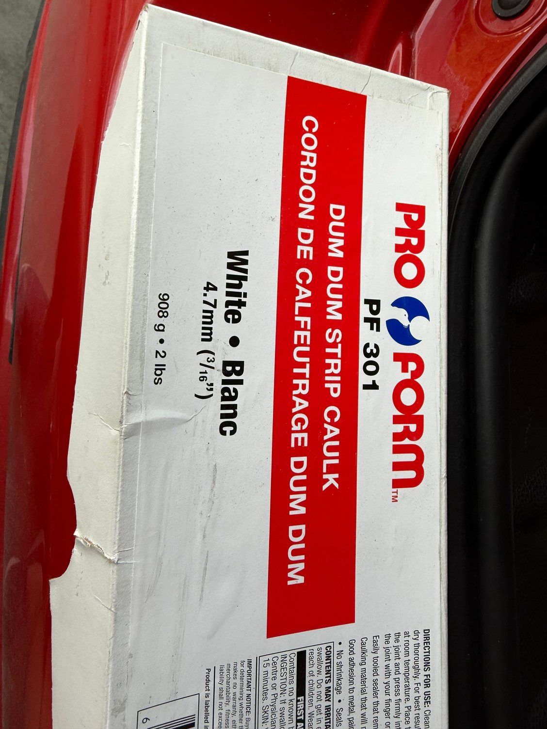

Although we have different models(R58) I discovered water coming into my hatch and pooling in the area under Jack/tool tray
then source of the water were the tail lights
i removed the tail lights and applied Dum Dum Strip Caulk between the body and the lights
reinstalled the lights and no more leaks
that might be the source of your leak
worth looking into

I was thinking of that too but wanted to eliminate the leak using deductive reasoning. So far the leak has been fixed. So far… lol… but I want to replace my tail lights with nice LED lights that aren’t in the pattern of a British flag.
ill be looking into maybe using the product you mentioned over the black rtv for removable items like lights. Thanks 🙃

nice to learn about the Dum Dum Strip caulking. nifty.
