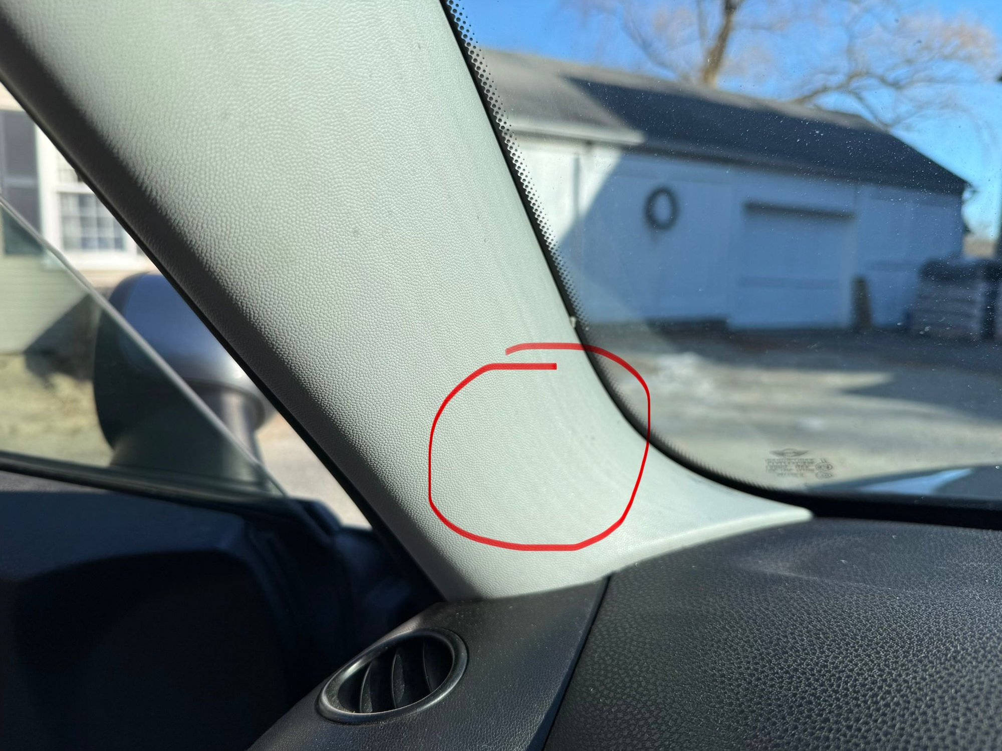

I’ve done multiple searches but haven’t really found the answers I’m looking for.
I have a 2009 Clubman S with NAV and basic audio system with 6 speakers. I am swapping out my lower front door speakers as one doesn’t work. I am installing a set of 6-3/4” components and was wondering if anyone could help me out with the following:
1) Should I tap the tweeters into the mid/high range speakers or the mid/low ranger speakers? Why?
2) What have people found to be the best placement for the tweeters? I know the factory H/K’s in in the A-pillars, but should I place my tweeters in the upper door panel sill? I’m not an audiophile by any means and just want good sound, but if I’m doing this, I would like to do it once. I’m not replacing my A-pillars, either.
The speakers I got should work well with the factory radio (93.5 db and 4 ohm) as I am not replacing the radio at this time.
I’ve attached pictures of the possible locations.
Possible door panel location.
Factory location.
Factory location.
Thank you!

Hello,
These are the parts of the a-pillar for the Hifi system. People use these and then install an aftermarket speaker system.
https://www.ecstuning.com/Search/Sit...h/51432756767/
https://www.ecstuning.com/Search/Sit...h/51432756768/
