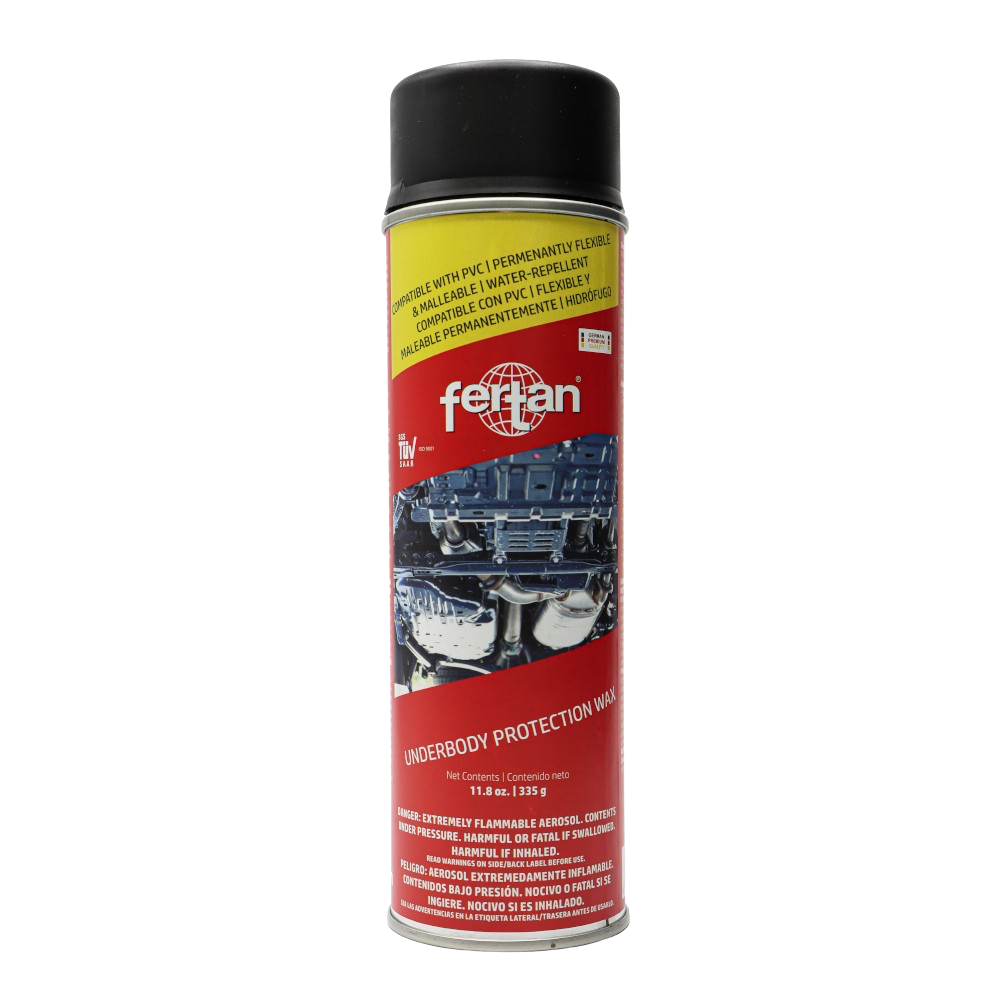

Those nuts and bolts under the hood, either replace them or treat with oil or grease. Some people like to use that wax spray they use on underbodies,
This is what they use to repair the body rust also. https://www.ecstuning.com/b-fertan-p...0ml/22220~ftn/

Have you heard of Evaporust?
I showed a picture of of the door seal at our club meeting. He said Evaporust does not attack anything but the rust.
The previous picture of the door seal could have been taken of my car.
The gentleman that talked about Evaporust swears by it.
Our other cars are American and between 96-108 years old. So I am very interested in how to stop the rust cancer.

Nope just the fertan stuff that's made in germany. https://www.fertanusa.com/ Attacks the rust. That might be the American version that you are talking about?

It seems that Evaporust and FerTan might be the same stuff, Different name.
