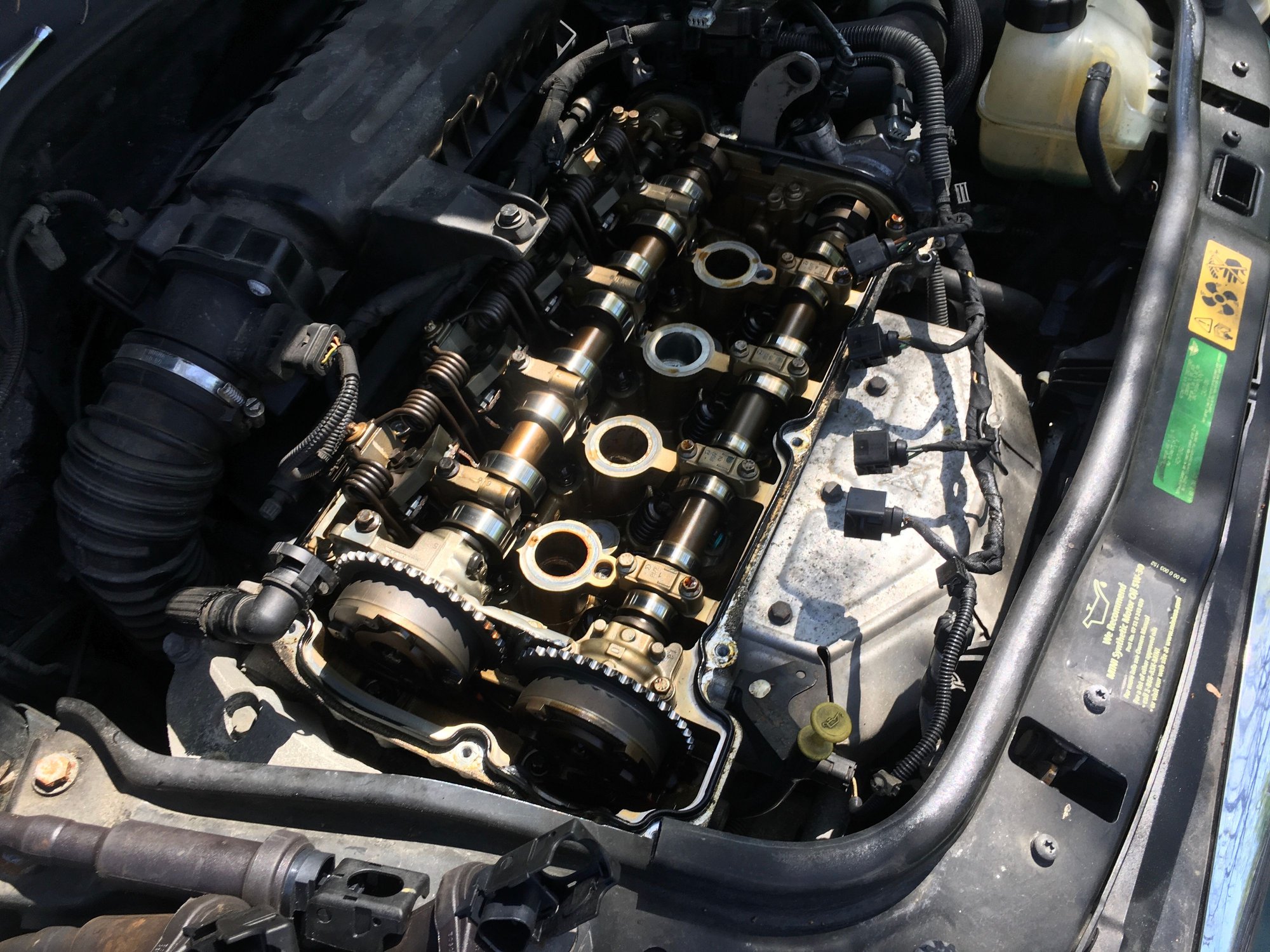

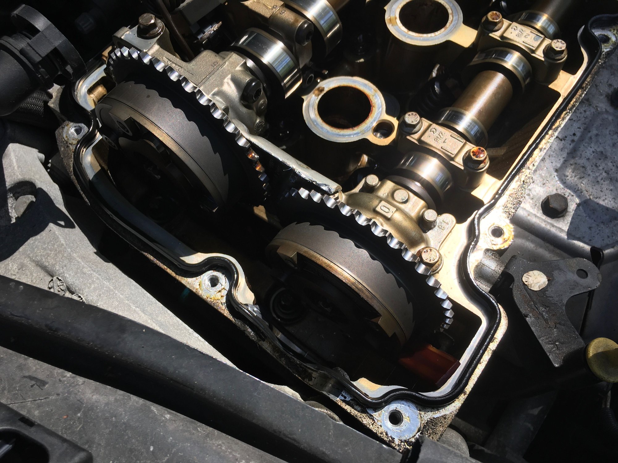

Got the chance to pull the valve cover yesterday, and the chain is completely off the sprockets. Also looks like there's some damage on the metal guard behind the sprockets.
Before I knew what was happening, I tried starting the car a couple times after it initially stalled, and the engine cranks with no resistance, which leads me to believe that the chain is piled up somewhere inside, not interfering with the crank. But there have definitely been numerous revolutions of the crank with the camshafts not moving.
For now I just put the valve cover back on until I decide whether I want to start going through the process of repair or just let the whole thing go. Thanks for any suggestions.

You've surely got some bent valves, depending on how hard the engine was working you might have some cracked pistons. You also might have some scored valve seats in the head.
decisions are:
  • rebuild the engine (I would do it if you think you're going to keep it for a long time)
  • source a good used engine (I'd do that if I was going to keep it for a while, changing the timing chain on the way by)
  • sell it as is
