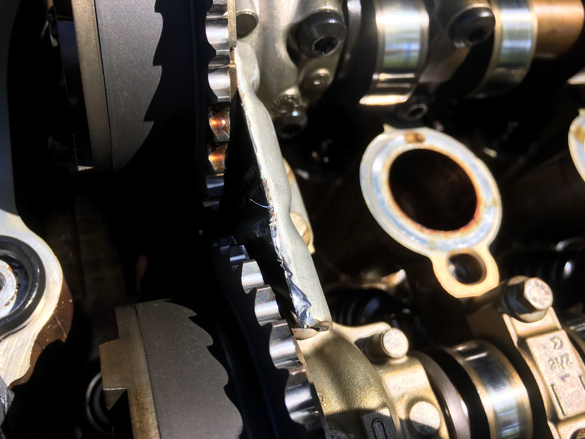

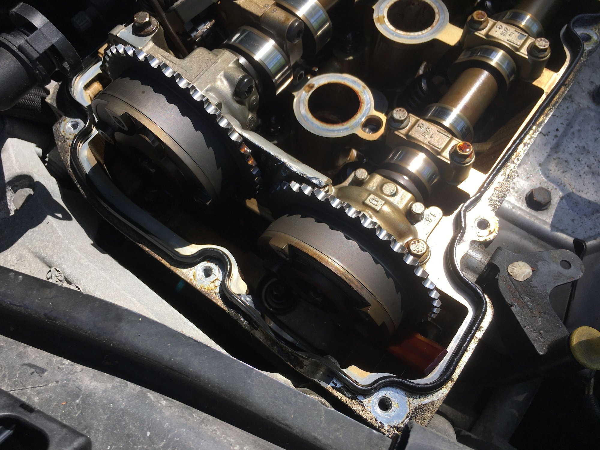

Well, I finally got the time to pull the valve cover, and the chain sure did snap. There's also what looks like a sheared metal piece between the cam gears, can anyone tell me what that is?
The interesting thing to me is that it cranks fine. When the car originally stalled, I tried starting at again and the engine sounded exactly like it does when you're starting it, except for the part where it doesn't start. I would thin the chain would pile up around the crank sprocket and cause resistance.
In any case, I suppose the next step is to pull the head and see exactly what I'm dealing with, here. If anyone has any suggestions on how best to proceed, I'm all ears.

Dang... That hurts. What I've always been afraid with the timing chain :/
I even had the dealer told me once that they don't change timing chain when I asked how often one might change it.
I'm no expert at that level though I would think the chipped metal is from the chain flying off at the moment it snapped.
I hope you find answers. Best of luck!
