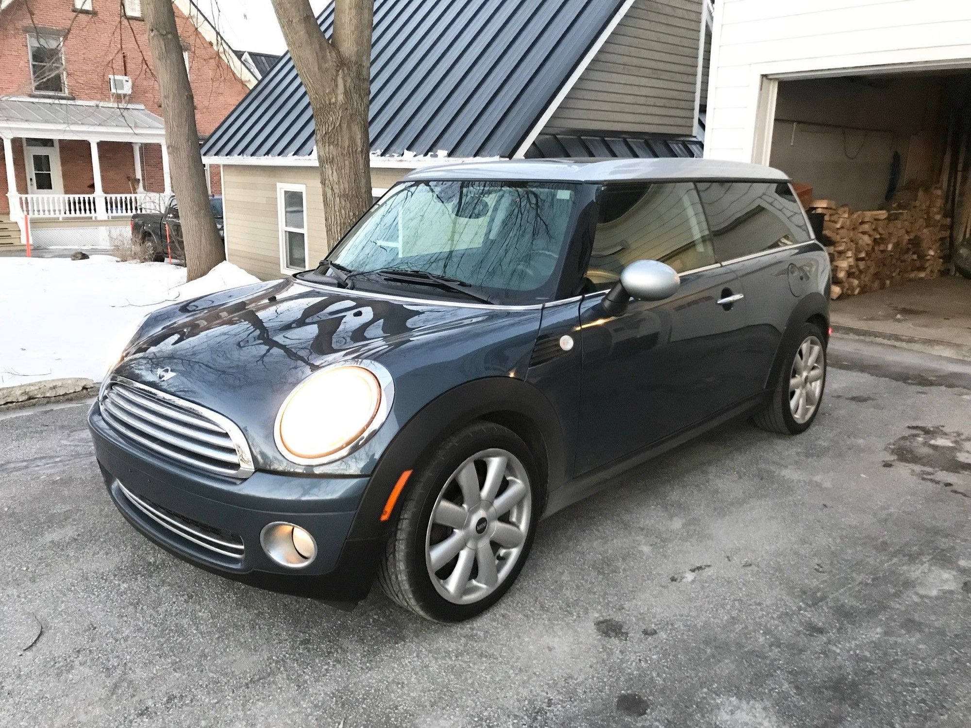

Hi all, I took the plunge and bought the 2010 Horizon Blue Clubman. I had it inspected by a BMW/Mini specialist garage and they noted two minor oil leaks at the vacuum pump and the oil filter housing. The tech suspects the gaskets? He said he wouldn't recommend performing any repairs at the moment, just to keep an eye on them. The leaks haven't begun to drip onto the ground. He also said that there is no apparent noise coming from the timing chain. No other ailments mentioned other than a missing antenna and a little bit of rust forming on the inside of the barn doors (hope to have that remedied in the spring).
I personally find the engine a little noisy and have taken a video that I might like to put up on here for your opinions. Other than that, the car seems to pull a bit to the left and right at low speeds over uneven roads/ruts. On smooth surfaces or at higher speeds, it drives straight. It's got cheap Chinese-made run flats for now. I'm having the winter tires put on this week. If it were up to me, I wouldn't bother this late in the season but they are required by law until March 15th. I'll have the alignment done at the same time and hope that solves it.
Here it is!!

Very nice! Enjoy it and welcome to NAM

Control arm bushings are very likely the cause of the right/left pulling, especially at high miles and 12 years of service
