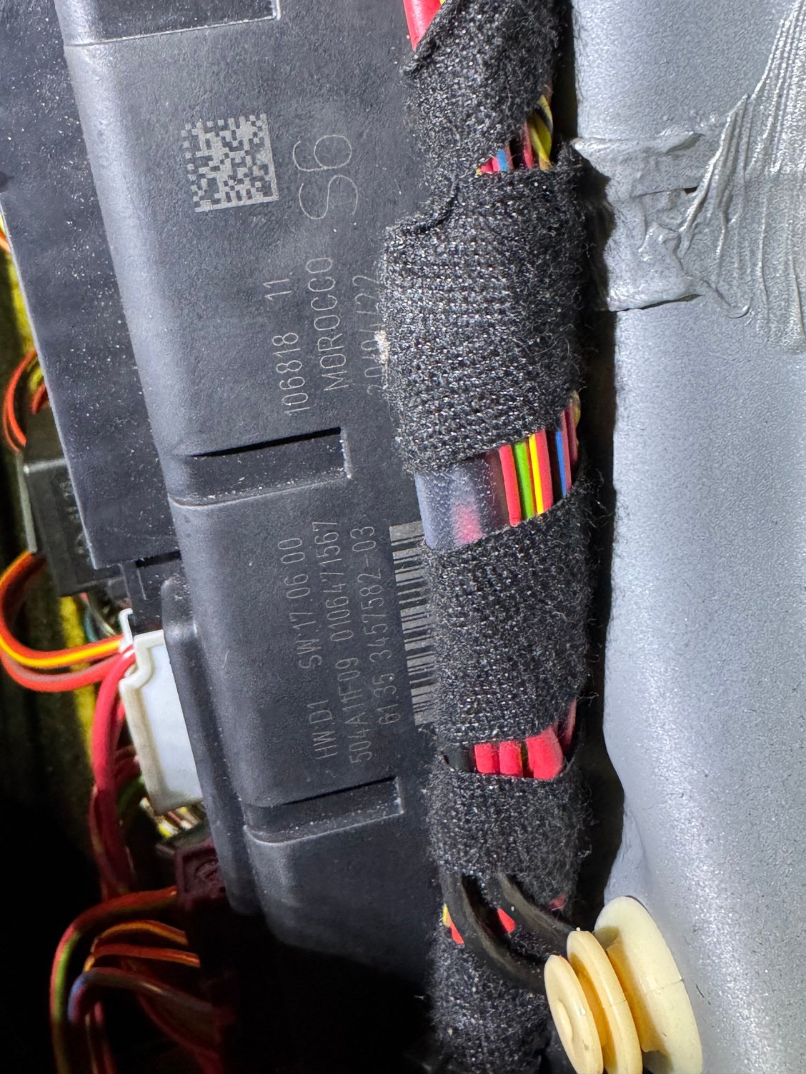

You need to check the JBE. I was having issues starting which lead to the JBE fuel pump solenoid. After initially taking the JBE apart and resoldering it things seem to be working as normal.
A month down the road the issue reoccured. So, I replaced the JBE with one from a R56 gave me all the symptoms you are describing. If you look on the side of the JBE (you may have to remove the plastic panel) you will find
the JBE part number. My original was L4/R55 The spare I bought was a L4/R56 which only has a hatch and one wiper. Which explains why only one door and one wiper works.
I'm reworking my original JBE to resolve the barn door issue, otherwise I'll need to find a way to run power to the left side barn door.

I'm hoping someone here can share their wisdom because I have the exact same problem with a non-runner Clubman project I picked up recently. The car had sat for almost a year, and in that time the sunroof drains clogged and water got in, destroying the JBE in the process. I bought a new one from WMW and had it programmed. The car fired right up after its long slumber and now I'm tidying up other things that were broken or neglected. After replacing the sunroof cassette, I turned my attention to the stuck door. It took awhile to figure out how to pop the left barn door manually, but I eventually got it. I just received a new door actuator from ECS Tuning, but unfortunately that's not my problem. I tried both the old and new actuators using the passenger side connector and both work properly. After reading this thread I tried the rear wipers - surprise, the passenger side wiper doesn't work!
I separated the connector at the driver's door handle and probed for voltage. One pin has 12 volts present, so I jumped the two terminals together with a paper clip. My logic was if the handle was faulty the actuator would click. No love there either. I just checked the labeling on the sides of both the old and new JBEs, and there's no labeling suggesting either goes to either an R55 or R56. So, I'm appealing to the collective wisdom here - what should I do next?

Hi!
Were you able to resolve this with the R56 JBE?
I just bought the clubman and was having these issues, pulled the plastic trim and found out I have a R56 JBE fitted!
Now wondering whether I need an R55 one or whether this can be modified.

Hello,
https://www.ecstuning.com/Search/Sit...h/61353457582/
They are shared, MINI just puts the main model on in. 61353457582 is the part number on that one. See it fits your R55 Clubman.

I can confirm, after trying about everything, latches, handles, switches.
It is the ECU. I reprogrammed mine, and now it all works.
So in my case the driver side barn door didn't work and the passenger side wiper didn't work. Someone mentioned this is a symptom of the car thinking it is a R56. Bingo.

I was literally down the same rabbit hole. Replaced latch, after digging it out, replaced handles etc. It's the code. Somehow, after a dealer service, the car thought it was a R56. I bought one of those $100 code readers on eBay. And I gave up. Those interfaces are real bad. But after the 12th attempt I found a toggle for left hand door switch, and the door popped open, so I knew I was on the right track. Somewhere in there, there is a setting to reset ECU. I did that, and all works. Both doors, both wipers. Sorry I cant be of better help, the interface is so bad I cant recall where I found the ECU reset setting. Good luck!
(LAUNCH Creader Elite 2.0 Scanner for BMW/Mini)
