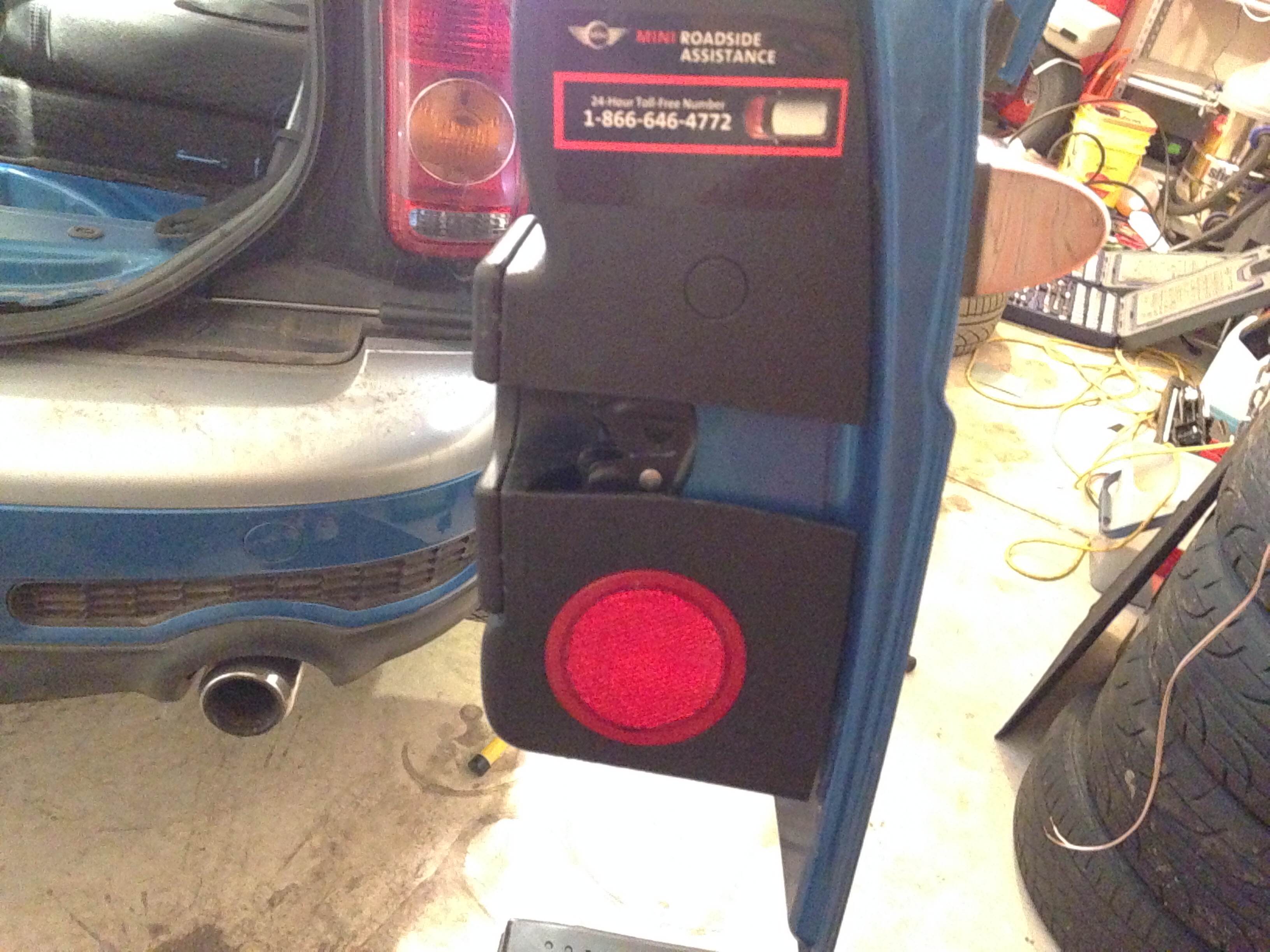

Ok, so I finally got a new motor ordered. Once I had the new one in hand, I could see there is a spot for a cable to attach for a manual release.
Knowing what and where it was I was able to pull the inside panel off the door and pull it out enough to reach in behind and get to the latch to get it to release. I used a punch, but a long reach, skinny flat tip screw driver would probably work best.
You just have to get it onto the release (where the cable would go if there was one ) and push it towards the back and it'll release. Once I knew exactly what I was looking for it only took a couple minutes of poking around to trip it. Then the motor is 2 screws & about 90 sec to change .
These pics show the release and where you have to catch it with a screw driver / punch:

And a view as installed in the door. This is the part you have to do by feel reaching in behind the door cover. Come in through the top. You can kinda sorta see a little bit down from the top, but it's mostly by feel.
--Dan

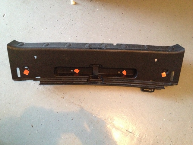

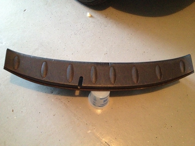

Great images from the manual. Yup #3 broke and is very difficult to get at. I ended up breaking the sill trim a little but there really is no other way to get the latch open. its just a small break to allow the striker (4) through.How to manually open barn doors-img_0406-640x480-.jpg
The sill panel has four pins that are fairly easy to remove. Once they are out just give it a good pull and it should come free. How to manually open barn doors-img_0408-640x480-.jpg
Once that is out of the way, it is possible to get to the latch. It was easier for me to take the screws out and then I was able to pull the latch to one side and jam a flat blade screw driver into the latch and pop the latch open. the latch is on the drivers side and very difficult to get to. Once the door is open it's not too bad. I'm waiting on new parts but I figure I should have the whole thing back together in 30 minutes or so.
