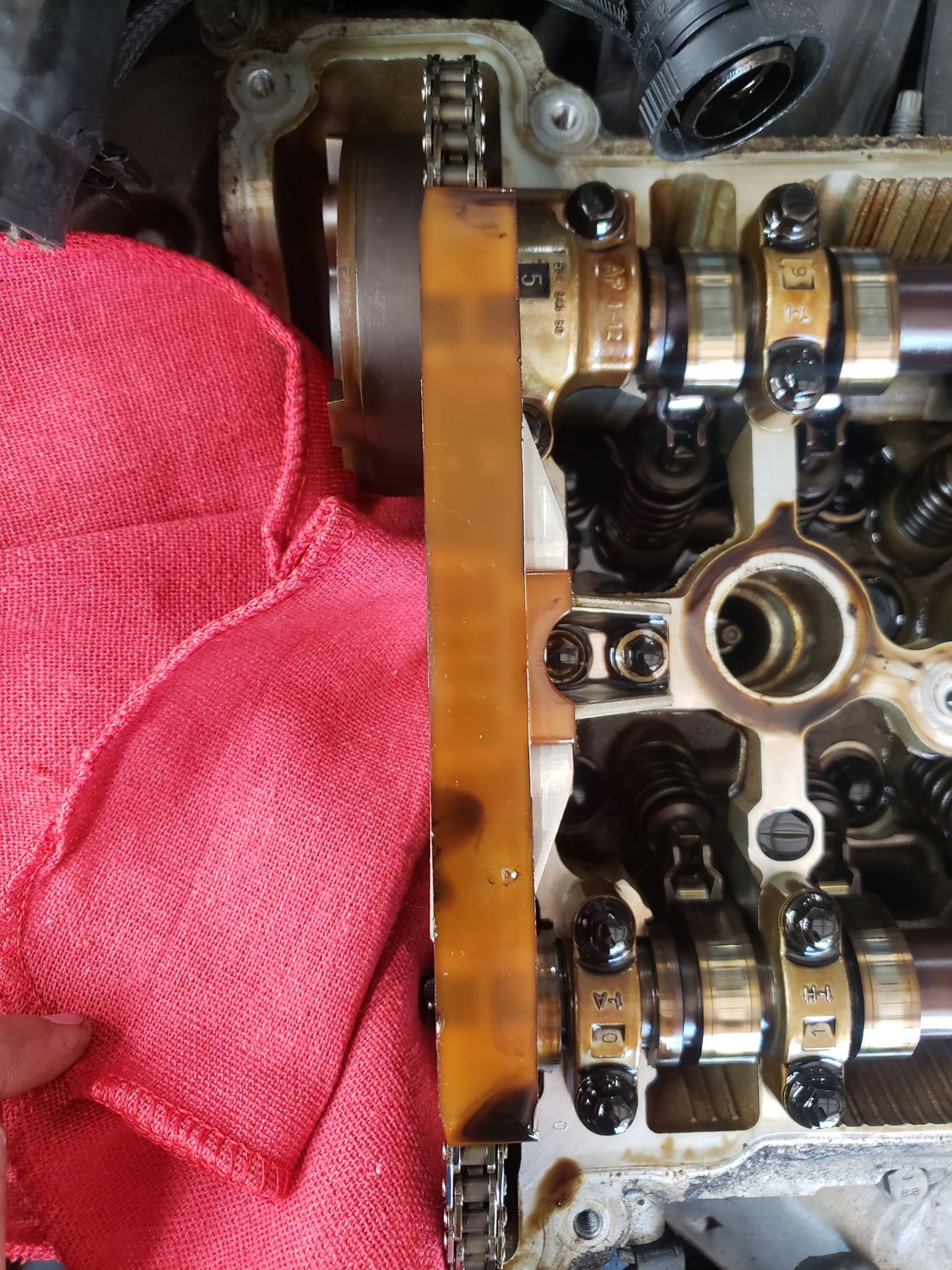

So the long of the short is, I heard the rattle...yes the death rattle. Or so I thought. I came on here went through the forum and clicked through the youtube links, listened to several folks rattles that were confirmed to be the death rattle. I felt confidant that mine was not as bad as some others, but I didn't want it to break either and I have time now whereas I am about to go back to school and will not have time to fix this fairly soon. So I ordered all the parts and found the Cam/Crankshaft timing chain lock tool from another NAM member for sale. But today I started to tear down since my hours are limited every day only to find a perfectly intact top guide. and as far as I can tell the rails look perfect as well. Should I risk tearing this the rest of the way apart only to possibly f*** it up or just replace the leaking valve cover gasket and try to return/sell the tools and parts that I ordered and won't be using?
Any thoughts would be greatly appreciated. The guide also appears to be a newer version based on my searches. The rattle is only at low idle and only when it first starts. I am beginning to think I misdiagnosed it and wasted a bunch of money on parts and tools.

Pic of top guide
I couldn't figure out how to edit original post on my phone.
The second photo is marks that appear to be old in the back of the head from a chain but as best I can tell not this chain.
I called mini before I started all this and they couldn't confirm if the timing chain had been replaced and said mine wouldn't be covered under recall.

depending on the mileage and since you already have what you need for the task, I think you should replaced it because sooner or later it will have to be done. Also, what seemingly may look like a perfect guide, it might be cracked and held in place! Also, for sanity check, remove the tensioner to see which version it is. the very first one was a two part tensioner, the second version was a 78mm and now the latest is an 82mm.

Thanks. I shoved a borescope down in and I can't see any damage to the timing change guides. I did check and this is the newest version of the tensioner, machined head and 82mm.
Are you saying even if it has all the newest version tensioners and guides that it will most likely need to be replaced? The car only has about 85k miles on it.

that's good news...since this is the new version and the guide might've been replaced a while back, you might still have another 50k before the next service...The problem lies when people don't keep up with the oil changes which in turn cause the infamous death rattle.
Also, keep in mind that the noise can also be generated from the vacuum pump. there is a youtube video of a guy who deleted it and shows the before and after noise/sound comparison.
