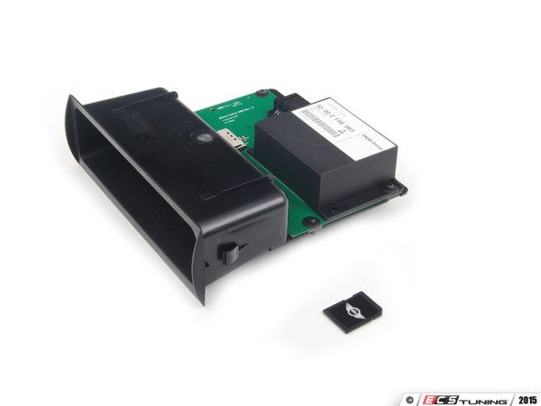

Be recently purchased a Mission Control Retrofit kit for my 2011 Clubman S from Way Motor Works, and was contacted by them to assure that I have the connection for it in my car, so I went out to my car and took the whole passenger side of the dash out and couldn't find any connection at all! My car is a 10/10 build and from what I understand they stopped putting the connection in sometime in 2011, which should mean my car should have the connection, but it doesn't! Has anyone retrofitted it or know where the cable is exactly, I'm pretty good at missing things in plain site so it could just be me, but I looked for a solid hour and couldn't find anything. Any help is appreciated.

My car doesn't have connected, I've had a Clubbie with connected before and Mission Control was part of the app. I'm talking about retrofitting the one that goes where the secret compartment is, there is supposedly a cable back there but I can't seem to find it.

You mean this ?
65902159967
Retrofit Kit Mission Control
http://www.ecstuning.com/Search/SiteSearch/65902159967/
Install PDF attached/
Did you get that ?

Yes, that's what I got, but I can't figure where to connect it, there's nothing behind my secret compartment.
Old Jun 2, 2015 | 07:00 AM
Posts: 36,758
Likes: 2,548
From what I see on the install PDF is the wire harness comes with the kit and then the harness goes from the new box to the stereo and that's it ? Did you get that full kit ?

Ohhhh... All right, so, the cable comes in the kit, it's not already in the car, and yeah I got the full kit, so all is good. Thank you so much ECS!

yea , there was two ( one on super sale) for MINI that already have the Mission control. Just a box and the card 65902154719 .
http://www.ecstuning.com/Search/SiteSearch/Mission_Control/
and
The full retrofit kit: 65902159967 which come with the install stuff.
Should have contacted me on the part or went to our site and I could have helped you.
That wire harness that comes with the main retrofit kit is nla.
