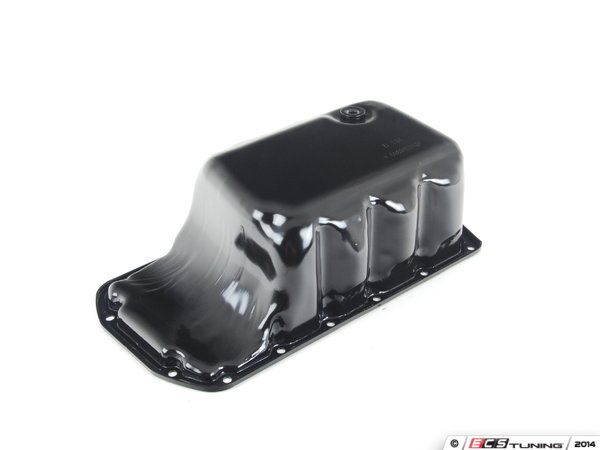

They did change the plug during the oil change just the gasket/seal as the damage was found during the service. Just ordered the Drain Plug, Jack Pad, and the fastener assortment as there are some missing fasteners under there not all from jumping the parking bumper. Will paint the pan and install the plug when everything get here. This car has the Hyper Sport Aero Kit and boy is that front end low. We have to learn not to pull so far in the parking spaces with curbs or bumpers. Is the oil Pan steel or Aluminum ?
Tom
Old Apr 14, 2015 | 08:19 AM
Posts: 36,758
Likes: 2,548
Its steal last time i checked.
Oil Pan W/ Drain Screw Plug & Washer 11137550483
http://www.ecstuning.com/Search/SiteSearch/11137550483/
and the gasket is either the paper one or MINI is using the adhesive gasket seal.
11137565928
http://www.ecstuning.com/Search/SiteSearch/11137565928/
