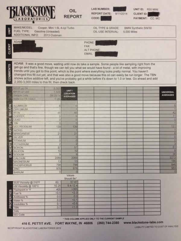

Blackstone OIL results
Ok, to back up most of my beliefs I sent my oil in for testing, including the test to determine how much additives are left.
I have 7500 on the car, changed oil at 1500 ( my dime ) and 2500 dealer freebie, so 5K on oil. All wear was good and right on for averages, no water or anti freeze and less than .5% gas. I broke my car in like I planned to run it.
Lab says 2-3K more life left and by golly thats exactly what my cars computer says.
So my wifes 2011 which says she can get 12-14K is BS , The lab don't lie, about 8K max on full synthetic oil.
Overall happy with results and glad the newer cars get a reasonable and correct reading on how much life is left in the oil.

here is the best I could figure out, took a pic and uploaded to photobucket

looks like the mcs's have a lot more iron wear than the base coopers. different engine & turbocharged, but still

maybe that iron is from the turbo bearing itself. I think we can learn alot from sharing these oil results. Much better than the other oil arguments.
I'm just glad to see my initial thinking on 8K oil changes is proven sufficient, anyone going more is just asking for it. And like I have stated before, more frequent oil changes won't hurt a thing but your wallet.
I do 90% city driving BTW. Installed JB+ at 500 miles and did first change at 1500, I think getting the first change when the metal wear is high is important, I would not try to get a full 8K out of the first run. Just my opinion.

Thanks for sharing. Yours looks pretty close to my second interval, and we didn't even use the same oil. My OCI #2 was with Motul X-Cess. I'm nearly at 20k and going to run another interval of RedLine 0w30.

I just saw the report you posted and they basically say this straight out:
“Go ahead and add 2000-3000 more miles to this fill, then check back.”
They say run the same oil 2-3k more then retest. They figure you are still running the same oil, i.e. have not done a complete change.

There's a check box on the form to indicate that it was changed when the sample was made. If you don't check it, they assume you're still running it (ie. you sampled without changing it).

They know I did NOT change oil, just sucked out a few ounces from dip stick.
