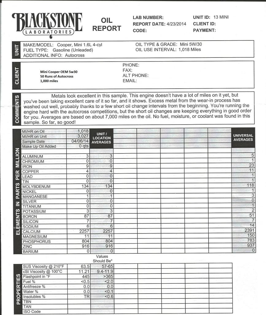

One thing to note - the Mini 5w30 is, as people speculated, fairly thick as far as 5w30's go - and is thicker than the ZROD 10w30, which is known to run a little thicker itself

Old Sep 12, 2014 | 11:07 AM
kyoo's Avatar
kyoo
Joined: Oct 2012
Posts: 2,631
Likes: 72
OEM Mini Fluid

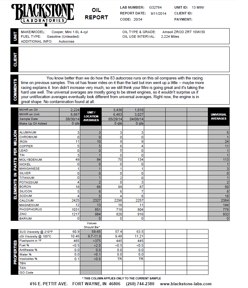

Old Sep 12, 2014 | 11:10 AM
kyoo's Avatar
kyoo
Joined: Oct 2012
Posts: 2,631
Likes: 72
Amsoil ZROD 10w30 - 83 runs, 2,224mi

i followed up with the increase in wear in Tin on my last sample, and basically they said that it's usually a sacrificial coating on a bronze part, so I may have slightly more wear there than usual. anyone else have tin in their samples on any meaningful level?
