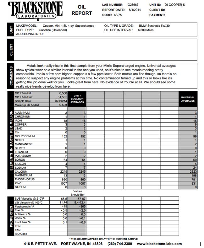

Appreciate seeing this stuff, can give some peace of mind knowing the wear numbers are doing ok even when you're running the car hard in competition. Looks like you would be fine going to longer intervals, even with autocross, with the exception of the tin in the last Amsoil sample.
I know this is under 2nd gen but I recently got the first analysis done on my 2006 JCW (R53) to see how OEM oil is holding up on a 6,500mile interval with a couple local autocross events:

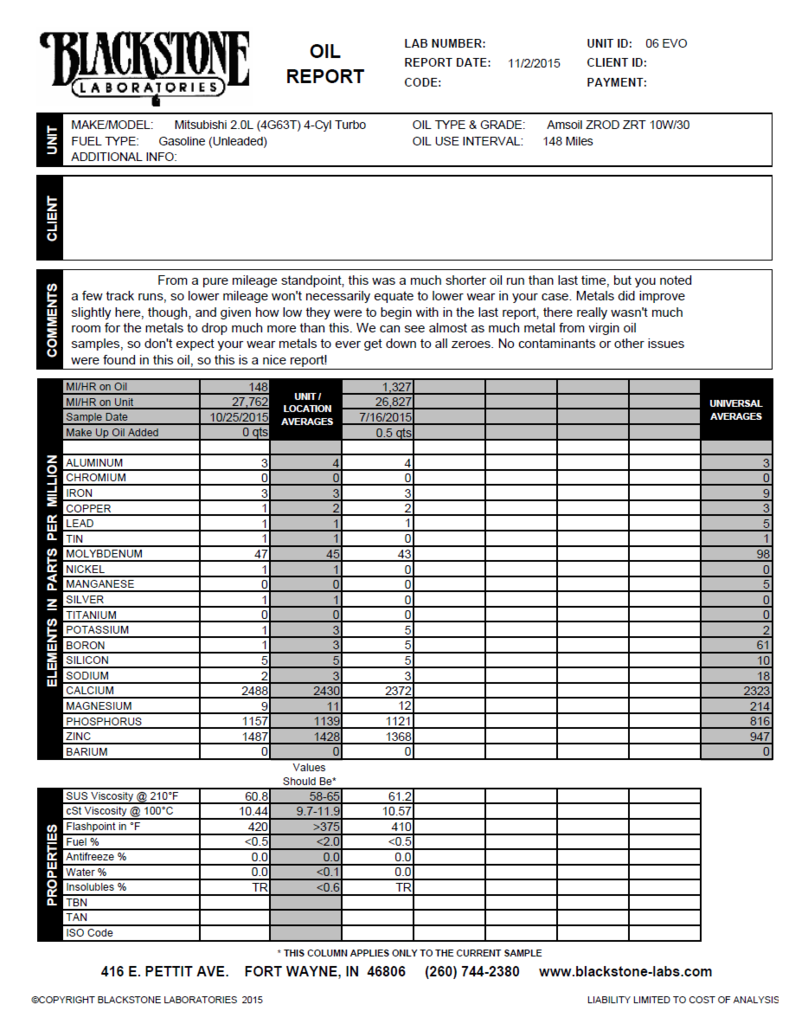

taking this chance to also post another UOA - this one of my Evo:
write up: http://r56hs.com/2015/10/25/evo-uoa-3/
Name:  Evo%2010252015%20Amsoil%20ZROD%2010w30%203x%2020m%20PDX%20%20148mi_zpsm0xddflv.png
This is my Evo - 4G63 iron block. 300hp of turbocharged, awd madness - and yet, much, much lower wear levels than the Mini. Even with the track run, iron wear is very controlled. A few trace elements, but not much different than the Mini there. Very happy with the results for the Evo. Note also, very very good filtration - even though the air filter is an open air cone filter, though I do have a cone filter sleeve covering it as well. Equivalent to the Mini's closed box, and in some cases better.
