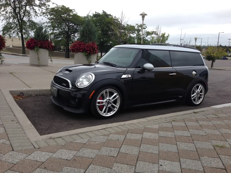

+1 for Michelin PSS 215/45/17. They fill the wheel gap aesthetically better too!
