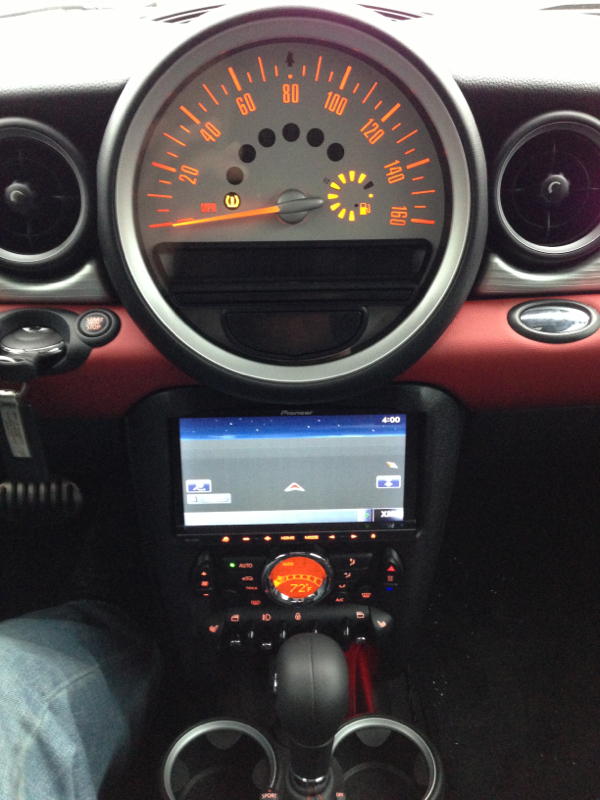

Couple pics.

Nav screen

looks good!! did you use the PAC or Metra axxess interface to keep MFSW functions?

I used the metra stuff. They were great to deal with. I emailed him about using all their stuff and they said that they hadn't tested it yet. I told them I wanted to give it a go. He sent me the pin outs that they had and what to test and look for. It made everything even easier than it would have been. Came out great and worked perfect.
I will admit it is a lot of work to get in there and get to it all and its a challenge to make it all fit but it does. I even managed to hide my XM receiver in there and use the factory antenna. i am really pleased. Sound is so much better.

Total cost not including the head unit was 210.00. It took me about 25 minutes to wires solder and shrink tube the head unit to the metro wiring harness. It took me about an hour and half to take the dash apart, I could do it faster now that I have done it once but I was taking my time. There are two wires that need to tap into the harness for the steering wheel controls, 5 min with some posilocks. Then you have to run the memory wire over to the fuse box. The instructions said to go to the battery but I used an open spot in the fuse panel that has permanent power to it. Again like 5 min. Hiding, tucking, squeezing a little and putting in all back together about another 1.5 hours. So about 4 hours total time and a little over 200 bucks. I am really happy. If anyone needs any help please don't hesitate to reach out to me.
