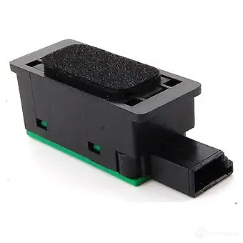

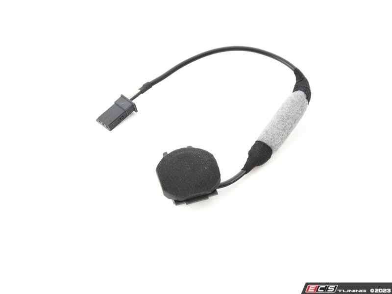

Moving the mic from the right side to the left does help a bit. Don't know about removing the dust screen.
This is all I have:
The OEM Mic - GSM R56 2007+ And R60 -11/2012
http://www.ecstuning.com/Search/SiteSearch/84316938762/ES201082/
Then there is the:
Microphone - ME49
The one from the R60 11/2012+ / R61 platform
http://www.ecstuning.com/Search/SiteSearch/84109263744/ES2672869/
From the older mics set ups. R50 R52 R53 MINI Full Bluetooth kit Microphone - Netz/PCN
http://www.ecstuning.com/Search/SiteSearch/84318380319/ES201094/
BMW (Original OE) 84318380319 for sale online | eBay
And the Mic from the R57 / R58/ R59
Which might have a better pic up due to the noise on convertible models. I don't know if its a disc type or not. But it does fit on the bump grille located on the top steering column in those models.
http://www.ecstuning.com/Search/SiteSearch/84109167397/
Looks like they have the same or similar connections.
Thanks and hope that helps.

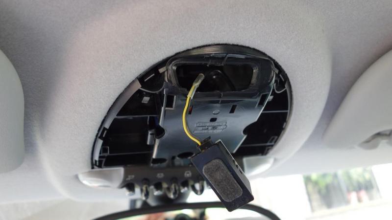

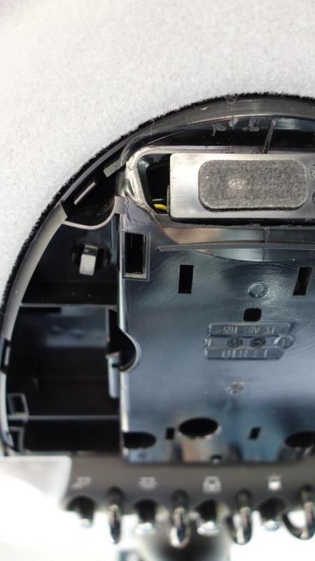

Moving the mic to the back (where the motion detectors are when you have the alarm) is 10 x the improvement of moving the mic from the r to the L side. Just so you know.

Can you show us where in a pic?

Here you go...... Simple fix that makes some sense. I'm working on a better microphone....might even try earthing this one first - think the circuit board is not used in a 2 wire install like mine.

I might try that! I'm subcribed to this thread. I want to hear what other people's fixes are so I can try them! Thanks so much!

Works like a charm. 👍. 5 minute fix.
