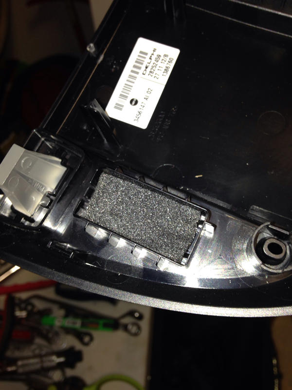

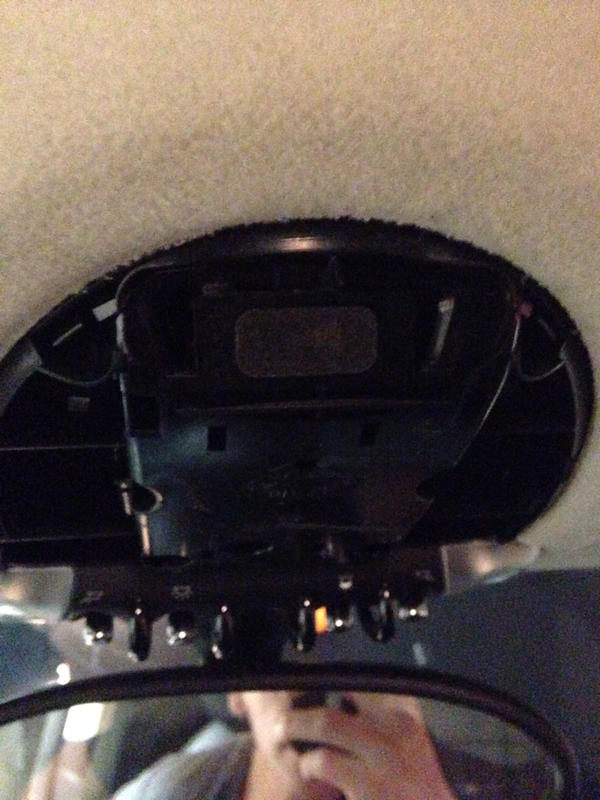

I moved my buddies MIC to the center, trimmed the center divider and wrapped it in foam. His daughter said it sounds like a normal phone call!!!
My car has the motion detectors so all I could do is move it to the right and add foam to cut done the sensitively. Mine is 20% better
