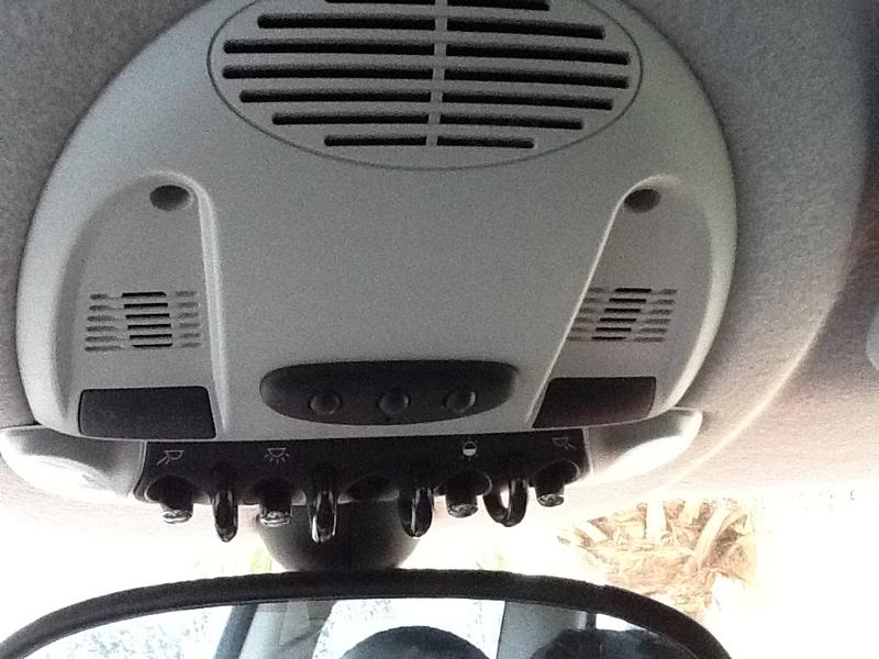

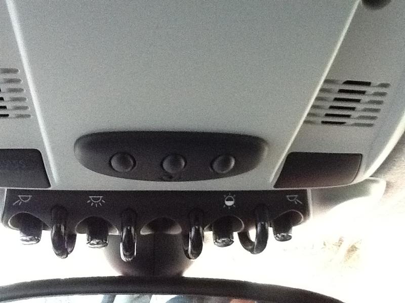

Finally got around to it. A couple of pics. Bought it on eba.. took me almost 3 hours with some writeup found elsewhere in the forum. Came out pretty decent, I think. Sorry for the poor quality but took the pics with the ipad and the camera is not very good.

After I got everything apart like in the Valentine install, I cut away a piece of the black trim piece(the one you see after you take the gray one out)right in the center roughly the size of the homelink part. I did this because I attached the homelink to the gray piece very much like the write up of the R53 install, and then when you put everything back together you will want the homelink box to pass through the black piece.
I used a drill bit to make four holes big enough so the homelink buttons and the light went through but the ones on each side need to be big enough so the tabs that hold the homelink trim piece to the homelink box go through too. These are the tabs that were melted on the R53 writeup( at first I did not want to use the melting procedure but ended doing it because its the most secure way to attach it)
Another thing is when everything was done I noticed that the rubber buttons were not long enough to activate the transmitter effectively (the gray trim piece is thicker than is looks) so I used a hot glue gun to glue some little plastic pieces that I cut from the scrap material that was left over from the black trim piece that was cut first.
The cables I used were the ones I had for the hardwire kit that came with my radar. Used the purple cable for power.
I'm sorry if this doesn't come accross well, it is difficult to explain it without pics, plus probably my english its not that good.
Keep asking questions, I'll be glad to help.
