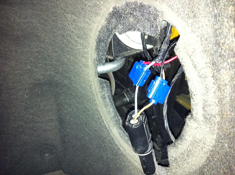

Old Aug 21, 2010 | 10:16 PM
m050120's Avatar
m050120
Joined: Jul 2009
Posts: 15
Install Photos
This was too much to resist. I ordered the LEDs and 8 waterproof Terminal splice taps (I always prefer to have extras) (superbrightleds.com PN WST-184) on Wednesday night. They got here on Saturday and with a little coaxing, I was allowed to put them in tonight. The total with shipping was $29.80.
Including gather tools (caulk gun, headlamp, wire-strippers) going down to the garage, fumbling around a bit, fussing with placement, and applying marathon (his) and half-marathon (hers) stickers to the rear badge holder, cleaning up and coming back in the house, the whole operation only took about an hour.
I've attached some photos. (This is my first time posting photos, so I hope they come through okay.)
Basically, I started on the right side. Turn your wheels all the way to the right to get better access to the access cover for the driving lights ( in hind sight, you might be able to get to it better by turning the wheels to the left to access the right side, maybe someone else can comment on that.) Open the lower cover by turning to the left about a quarter turn and reach in and grab the bulb and loosen it a quarter turn and pull it out. I had to cut back the tape holding the wires together a few inches. Pop the hood and lay the light strip on the bumper, thread the wires down and fish them out through the hole. I trimmed about 6" off the LED wires. Use the fasteners to connect the black wire from the LED to the brown wire. The red wire from the LED goes to the white with blue wire. (On the left the black LED still goes to the brown, the red goes to the black with green). When using the splice taps, make sure the metal clip really bights down into the wire.
Put the bulbs back in and replace the access covers. I used clear silicone caulk and put down about a quarter inch bead. Pressed the light strip into the bead. We centered the lights in the available space. With the hood closed, the lights are held in place, so when we closed it, we made sure they were where they were suppose to be.
We are very happy with the results. For less than $30 and an hours worth of time, this is a great mod that ANYONE can do!
If anyone has any questions, or wants any more photos, PM or e-mail me and I can send them.

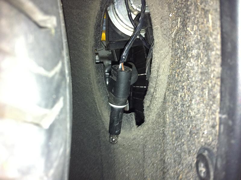

Old Aug 21, 2010 | 10:25 PM
m050120's Avatar
m050120
Joined: Jul 2009
Posts: 15
Btw
I used the cool white (WFLB-CW24). I also added a shot of the driving light bulb as it came out originally.
