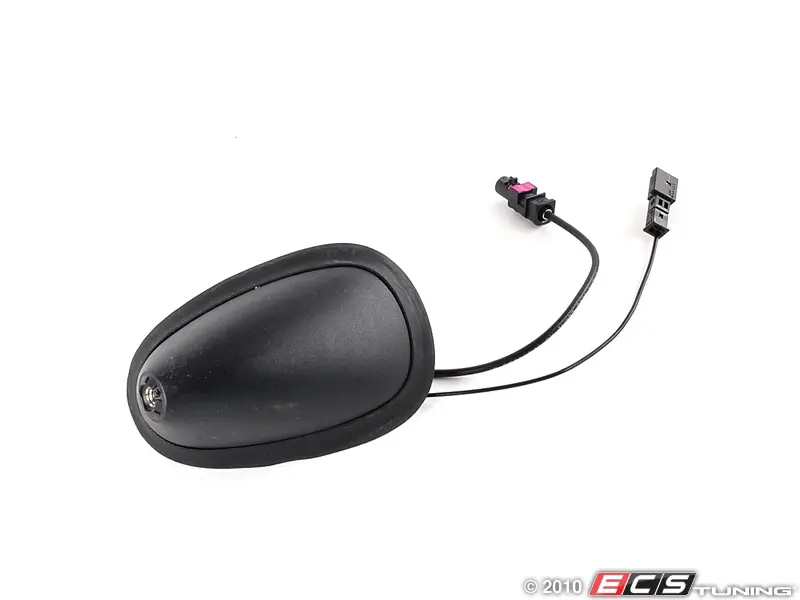

I had an antenna base on my R52 gets salt under it and rust out. I had to replace the unit. It corroded out the unit.
It tend to get water and gunk under the seal on the R52 since its up front on the car.
https://www.ecstuning.com/Search/Sit...h/65206929760/
Thats the NON navagation above.
This unit below is the Navigation Screen version, if you have it.
https://www.ecstuning.com/Search/Sit...h/65206931565/
