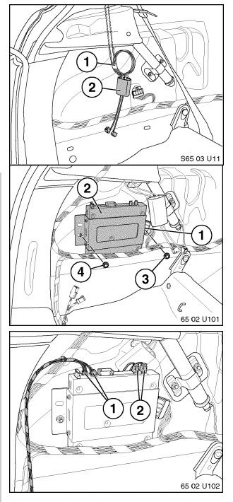

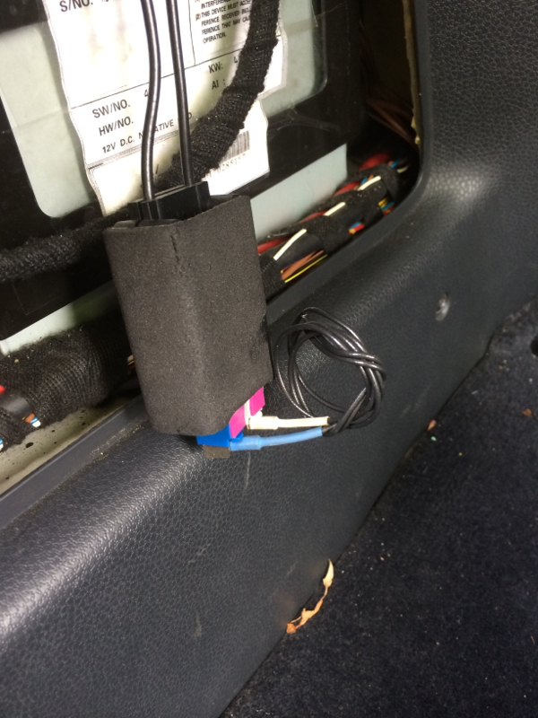

in the instructions there is an "ALC Module", whatever that is, which plugs into the Satellite receiver. in my car, its plugged in to the receiver, but the wires are cut on the other end.

(the ALC Module is #2 in the top graphic, absent from the middle, and the wires for it are #2 in the bottom, plugged into the Sirius receiver)
So that module is either a filter, a bias, or a diversity module.

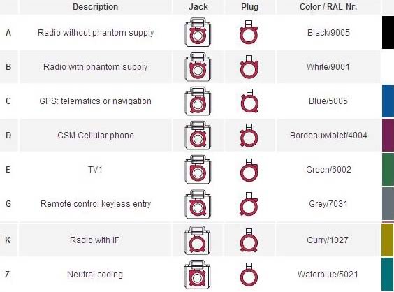

The connectors are FAKRA. You can buy FAKRA cables on eBay. You can buy the right colours or you can buy a pair of uncoded. Depends on what is available.
The question to ask yourself is why the wires were cut and why the AMFM was unplugged. Did the PO install some extra antenna system? Or go from a window to a roof mount for better reception? Or did he install an aftermarket HU and AMFM amp wasn't biased and he couldn't figure out why? Basically is SIRIUS gonna work when you hook up the ALC?
