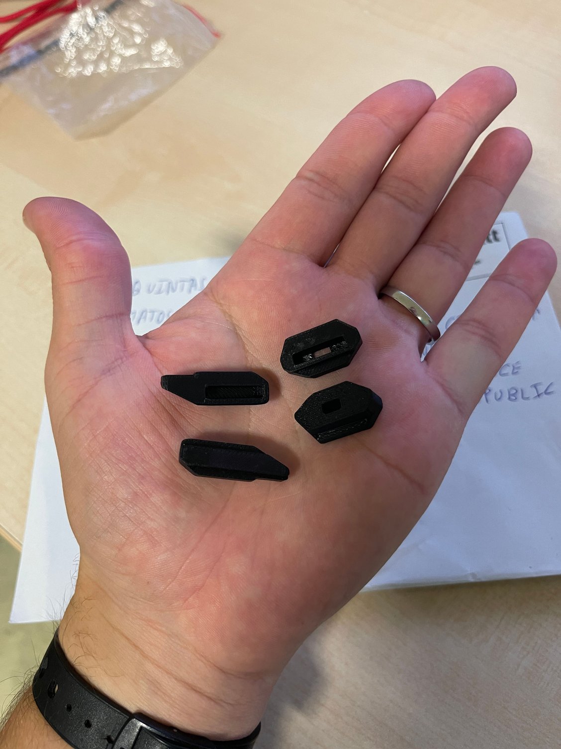

The 3d printed pieces below as requested, i can print them at request in ABS 80% which i think it's best.
They are working fine and they are tight-fitted, i got the originals for the LEFT SIDE CABLE still aswell for sale if anyone wants for 300€ + shipping. (including the cable of course, LEFT side complete set part of 54347174761 .
I'm not trying to profit off anyone with this, i tried for many months to buy or find 3d printed pieces of someone, could not find any and my R52 was scraping the back headrests for 1y+, so... i finally found a good set of cables with clips and all the work to print them and design them with a model that works.
I fitted mine with these clips, even though i had the original cable & clips. (only have 1 set now as above)
So, i'm selling the bellow for 50$/€ a set for the 4 clips with guaranteed replacements if any of them break. (been working for months in 2 cars currently, 2 more bought and no bad experiences yet)
I can also refund the money if for some reason they don't work for you or you break them.
Contact me privately for these, the price is fixed since i pay the shipment worldwide.
Instructions on how to replace will be sent together with them or privately. (the actual replacement process i find easier without disassembling the fabric) , i can also post here if you are interested, not rocket science, but the way i like to do it.
Thank you all.

there it is! Looks pretty good. Arrived within 3days from Portugal. I will try to assembly next week

One more data point. I ordered a set of the 3D printed roof slide parts from NotThisMind.
They arrived in the US after about 7 days.
They look good and seem like they will fit.
I am keeping them as backup, until my worn pieces finally fail.
FYI
