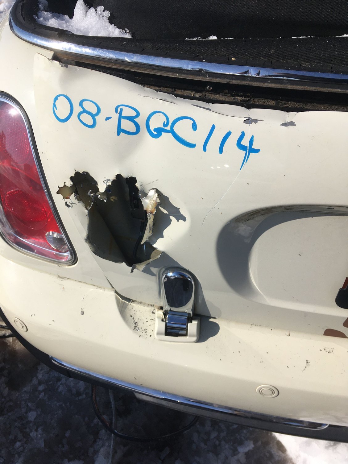

I’m in a junkyard RIGHT NOW (Saturday morning) to get a roof of an R 52. I can’t get the trunk / boot open!
the fuse box along with the drivetrain is gone. I tried to hook up a battery anyway but there is no positive cable!
is there a manual release???
I watched a YouTube video that showed no release under the rear seat. I tried to remove the bottom of the rear seat to take a look but it will not budge!
I removed the boot trim and tried to jumper the wires but can’t get that to work.
im not above destroying the boot to get it open.
any help while I’m 1.5 hours from home in 20 something degrees??

Got it. It was ugly

For anyone reading this in the future there is a pull handle (bent metal rod) attached to the underside of the back seat. After removing it fish it down behind the right back seat back, hook the glow-in-the-dark handle and pull.

the bottom of the rear seat would not budge! I didn’t think a pull handle would be there but I was running out of options. This information above is no where that I could find. I looked for a long time!
There is one other way...

For security. You can lock the boot with the roof down. With the pull handle under the back seat, the pull handle could easily be reached by a would-be thief. I guess they thought that thieves wouldn't be bothered to use the rod to fish for the handle. If your boot was full, you're screwed...

When the roof is up you can reach down behind the rear seat past the parcel shelf. At least, thats how I did it. First time I hooked the seat back release and folded the rear seat down for access, next time I got the handle directly. It seems that the wires get frayed going through the rubber conduit so eventually its not uncommon for the external trunk release to fail as a result..

Good to know that you can reach down through there. The roof was down on the car but the sunroof was closed! I'm not sure how it got in that configuration. I released the hydraulic pressure and was pushing it up and down during the removal but I didn't know the seats folded down until I got in the trunk! Newbie mistake!
