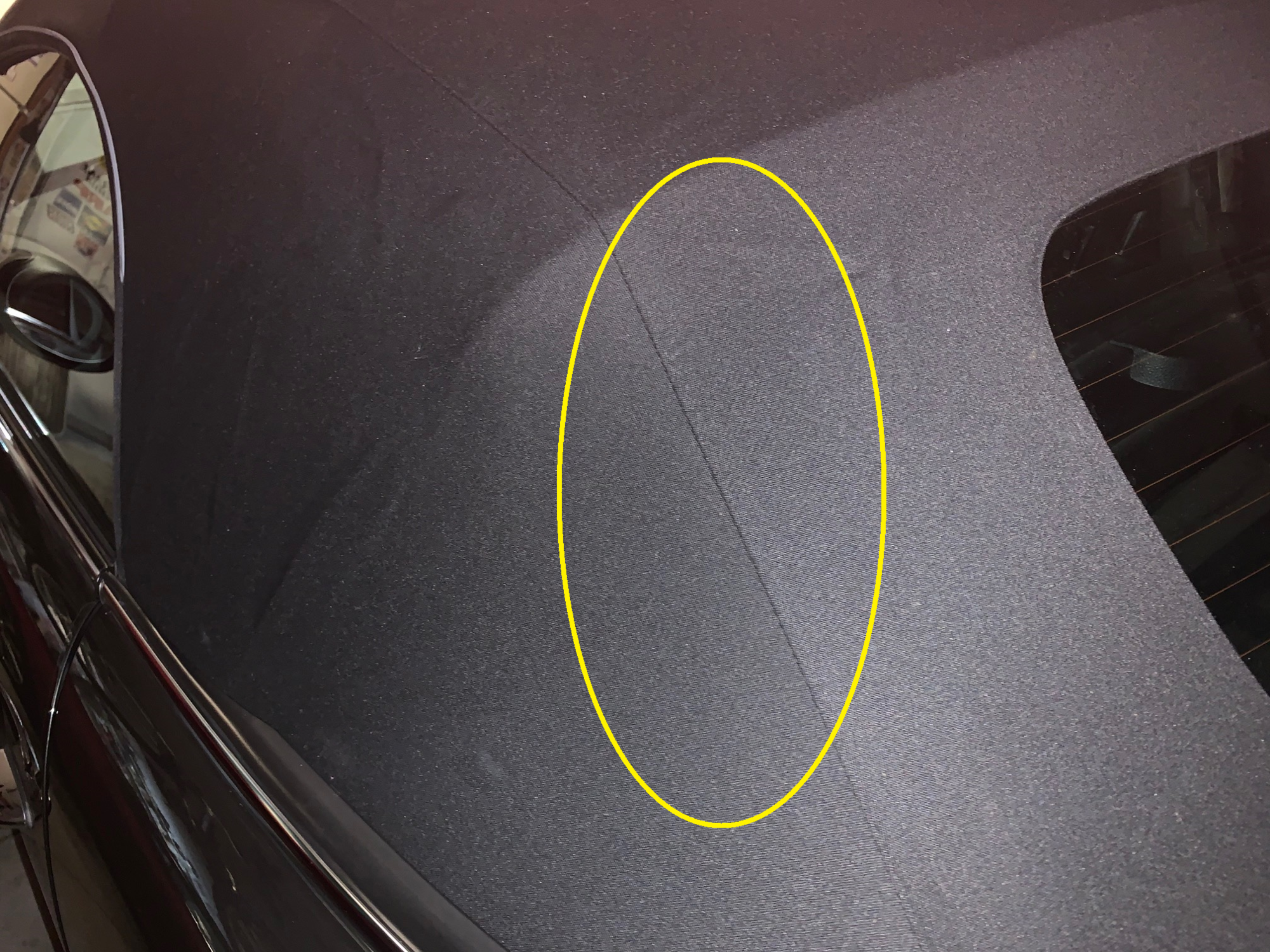

There is a vertical white line on the top. What could be causing this.

Old May 12, 2020 | 10:41 AM

From the picture, it looks like the top is separating at the seam.

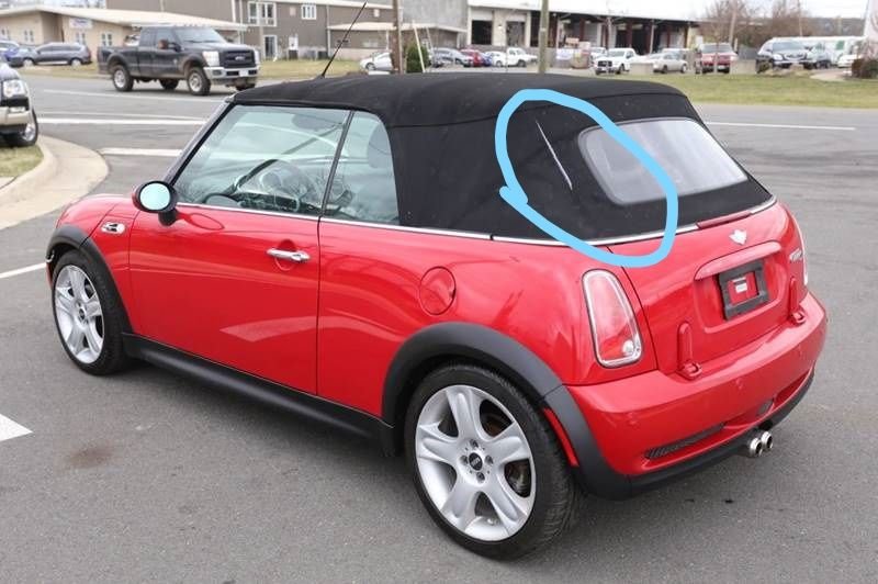

Old May 12, 2020 | 12:17 PM

Just looked at the top on my car because I remembered there is a "pleat" somewhere on the back corner. But that fold or pleat is below the area that shows as white on yours. On my car that area is a seam, no white is visible. I agree with njaremka that the stitching there must have come out. Not sure why there is white showing though. I don't see any white on the inside or outside of my car's top.

Agree that looks like the seam in the top is coming apart. This picture is of my R59 top but the construction of yours is very similar in design ... note the seam <which is not sewn ... but heat sealed (glued)>
here's yours
I would not drop the top until I had this looked at by someone who knows rag tops .. that's probably NOT a dealer.
Dunno where you are but around me there are shops that specialize in convertible top repairs and replacements.
It may be possible to sew or glue the seam.
Replacement tops are readily available but they are $$ as cloth tops always cost more and that's b4 installation charges ....
https://www.topsonline.com/model/Con...r_S_(R52).html
<Robbins has a VERY GOOD reputation for replacement tops and Haartz Stayfast Cloth is the material used by most manufacturers with cloth tops.>
This source site also has a list of recommended installers that may help ....
##it happens ....
that's a R59 roadster with the window having come away from the top ...
<my top was replaced by the dealer under warranty ... they did NOT do a good job and I complained ... second try was better but not 'excellent' ..... stay away from a dealer for this kind of work unless you KNOW they will sub it out to an expert>

Thank you and yes, I am considering purchasing. I have not made it to the dealership yet as it is 4 hours away from me. The car is a 2008 with 87,000 miles on it. I found a top online that is 775 plus shipping so I have that figured into my bargaining.
Again, thank you for your reply. I am hoping it isn't a separation, but just a mark on the picture.
