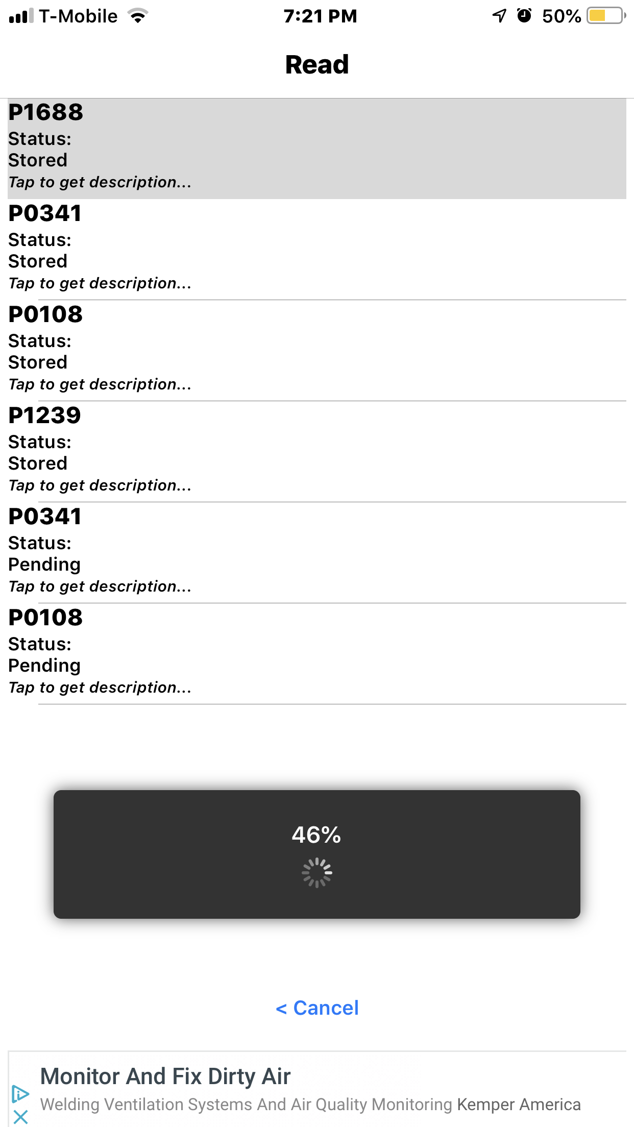

Today I got my hand on a scanner, I found these codes. P1688
P0341
P0108

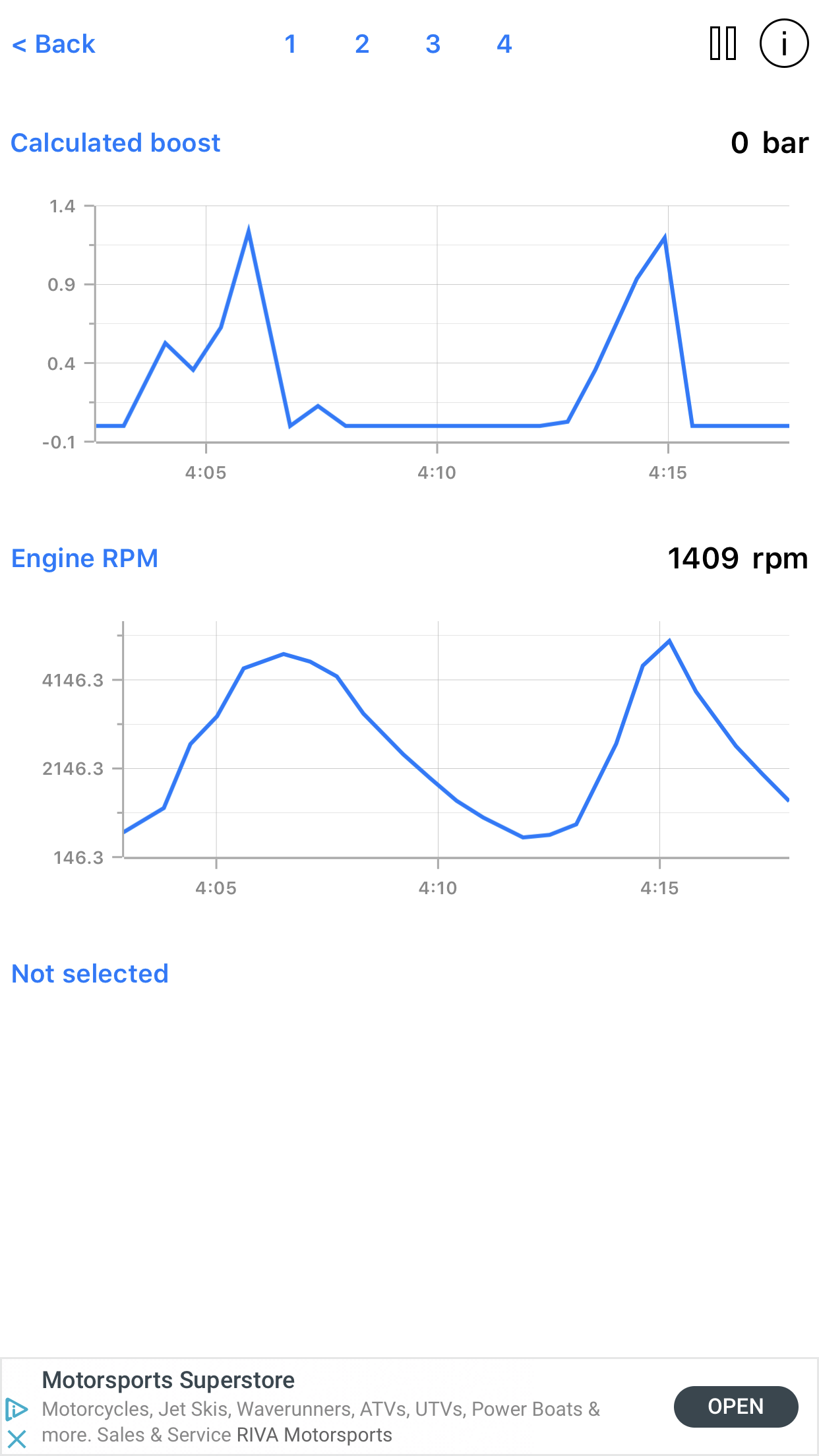

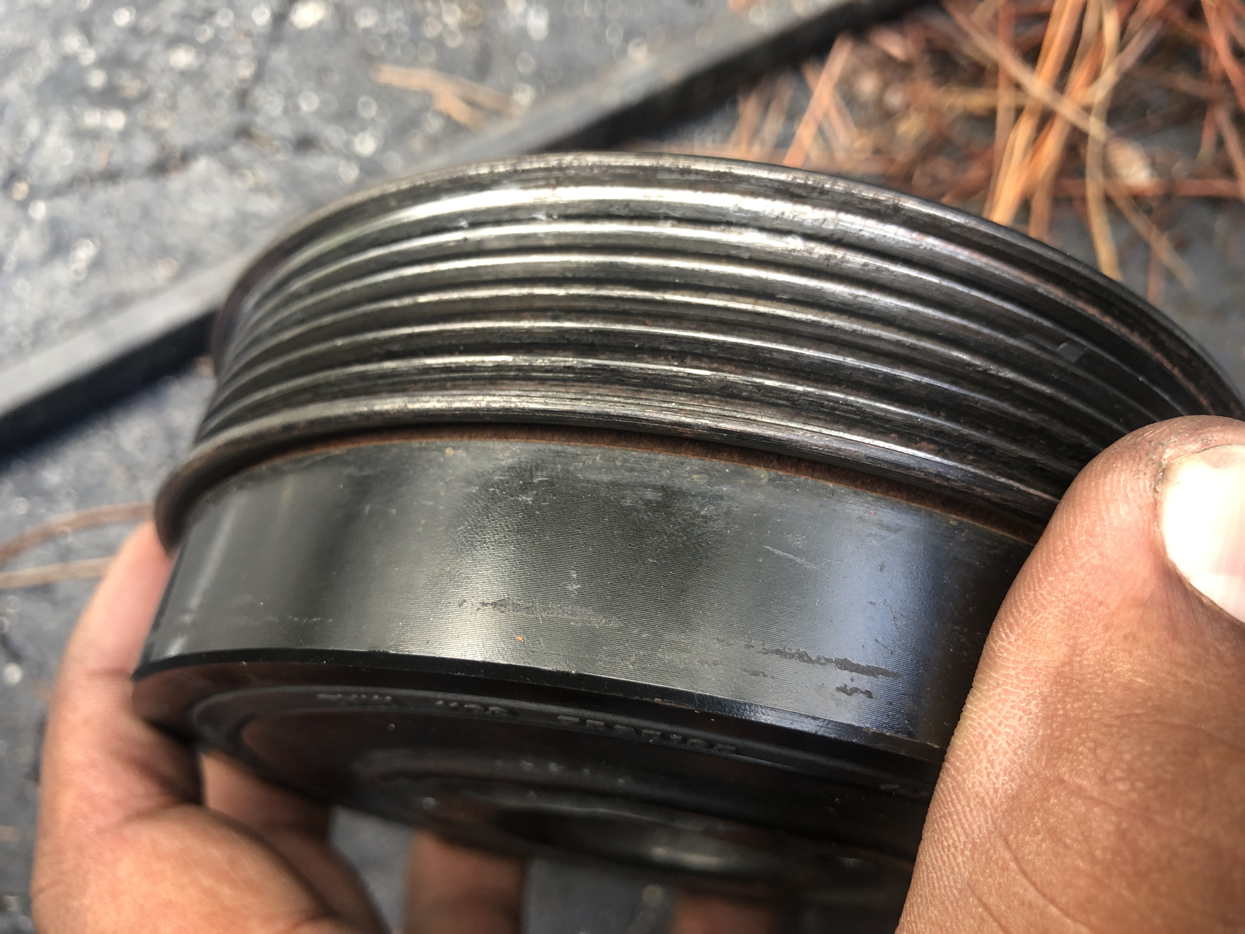

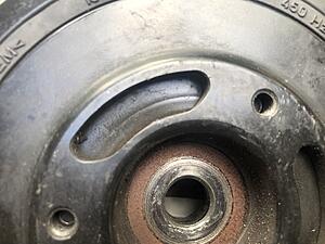

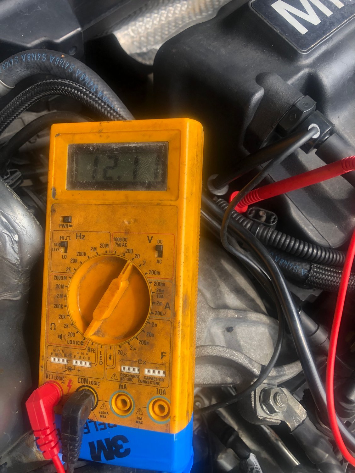

Well i changed the pulley the old seems like it has some play and must have been slipping but I can’t spin by hand. I changed the crankshaft sensor and the map but still no luck. I put the old map back in. I still have the codes even after clearing and reset, and car still have no power. I just remembered that I changed the thermostat before all of this stuff started and maybe I damaged the map grey vacuum line.
Ill post some pics and a video of what’s going on.

I ran the car and checked.
Battery voltage on the first wire, ground on the last.
And a varying voltage on the signal wire.
I’m stumped, the only thing left is the most far fetched.
Could the the car have jumped a tooth on the cam gears?

If I am remembering correctly the 2.5 volts are low, but I guess there is a possible reason for that. ( I was pretty sure around 5+ volts is what I read, the last time I checked one.)

The 5v reference signal is low at 2.5 volts....something is drawing the power down.....leave the meter connected and start unplugging engine sensors until the 5 volts shows back up on the meter....when that happens, you found your problem
