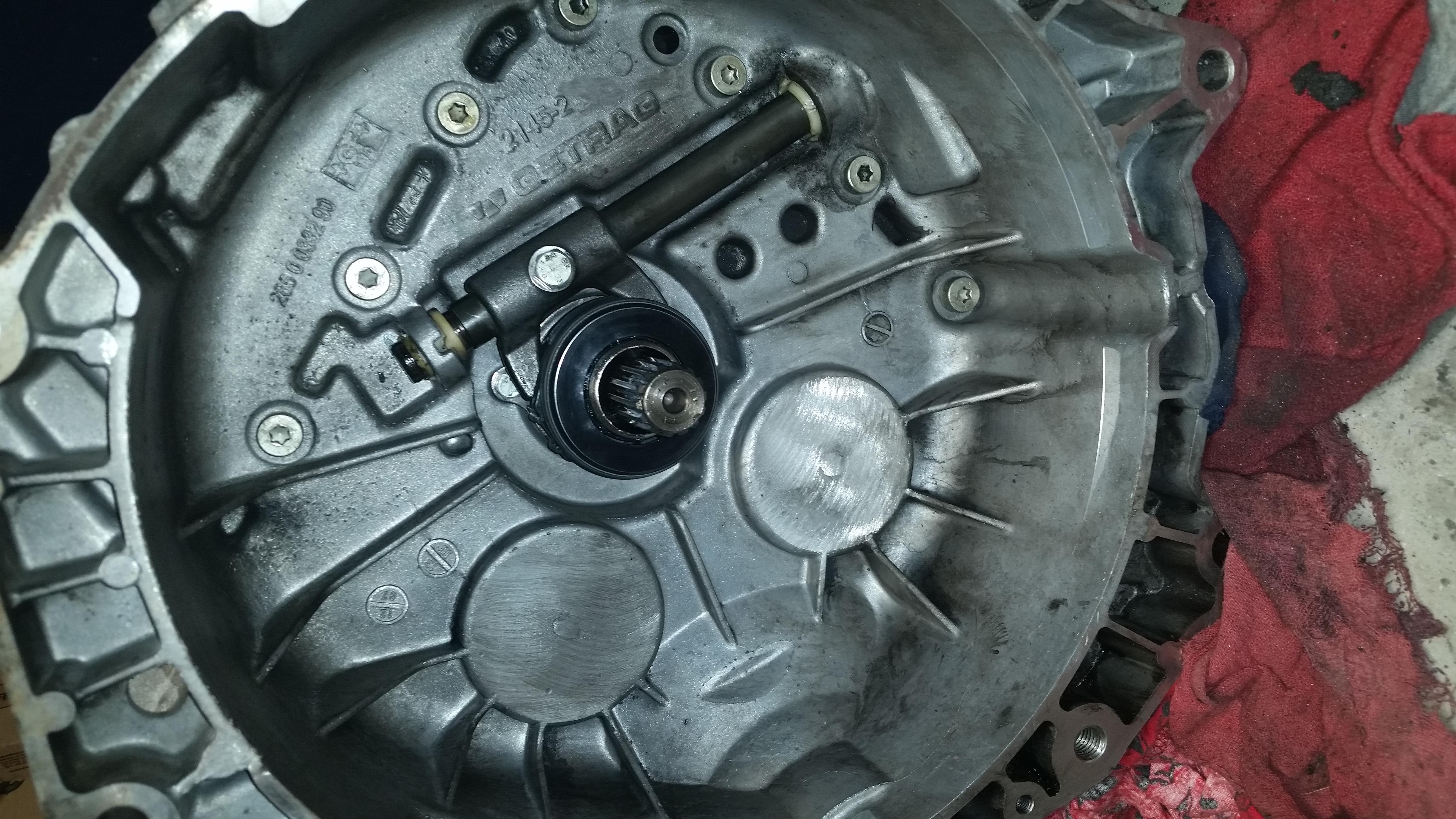

Here is a little history on my 08 ragtop S manual trans... I got this for the grand total of $2200 with transmission issues... It started and ran great... No clutch pedal and it made a loud whine when running at idle... I started it in first and got it going... I shifted it without the pedal by matching the next gear to the correct speed... So it worked... It was solid, for the most part... and included a colony of ants... UGH!

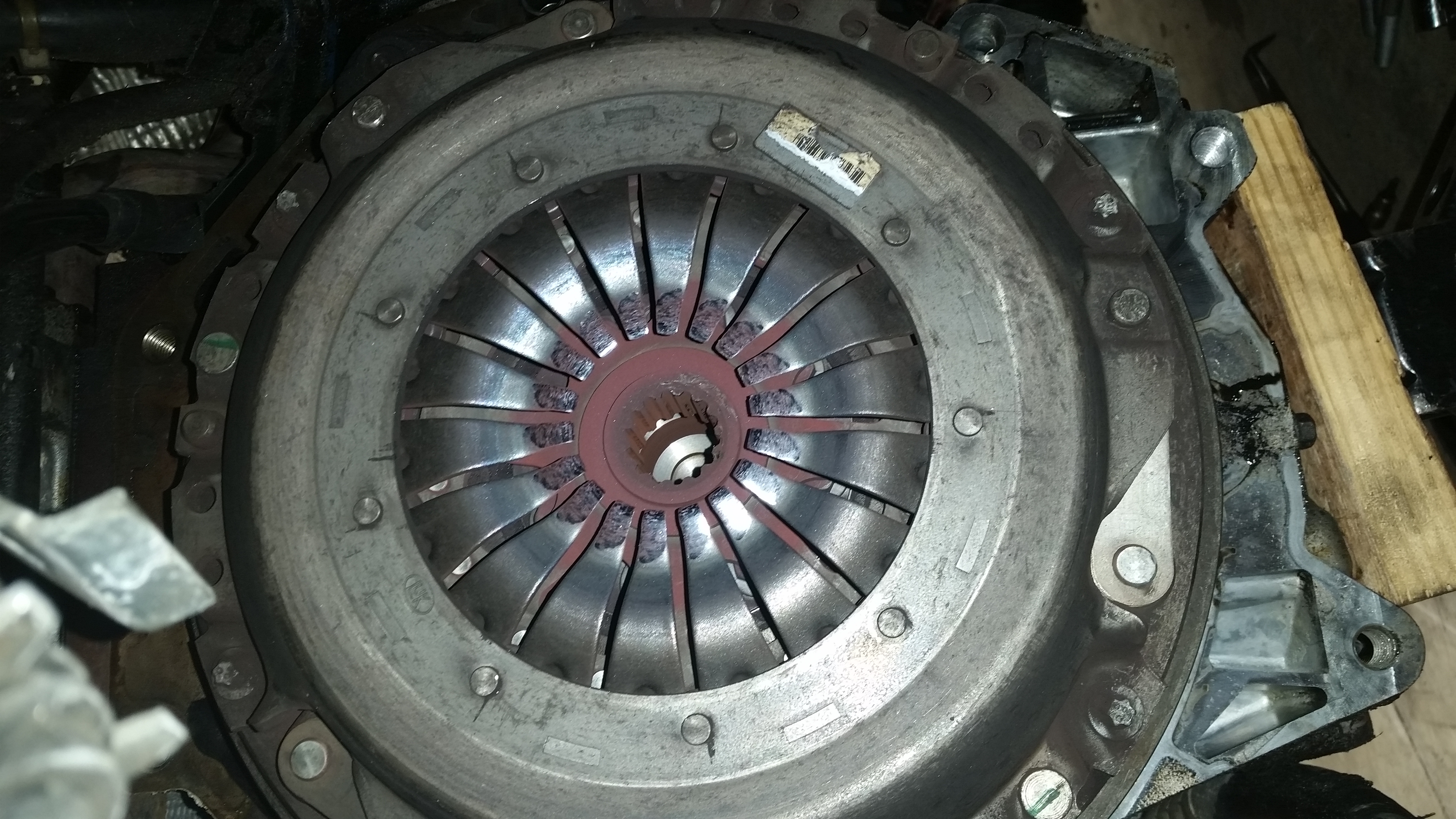

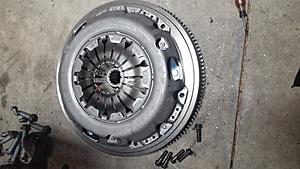

I got it home and pulled the trans... Melted throw-out bearing...
New clutch and solid flywheel combo that saved two pounds...

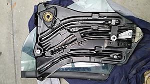

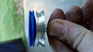

Pass rear window regulator was wound up around the spool... I pulled it apart, straightened the bends in the wire rope and wound it up again... It broke the blue wheel, so I fab'd one quickly out of aluminium... Not my best work, but it is hidden...

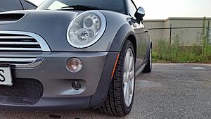

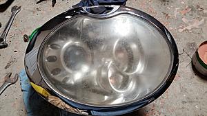

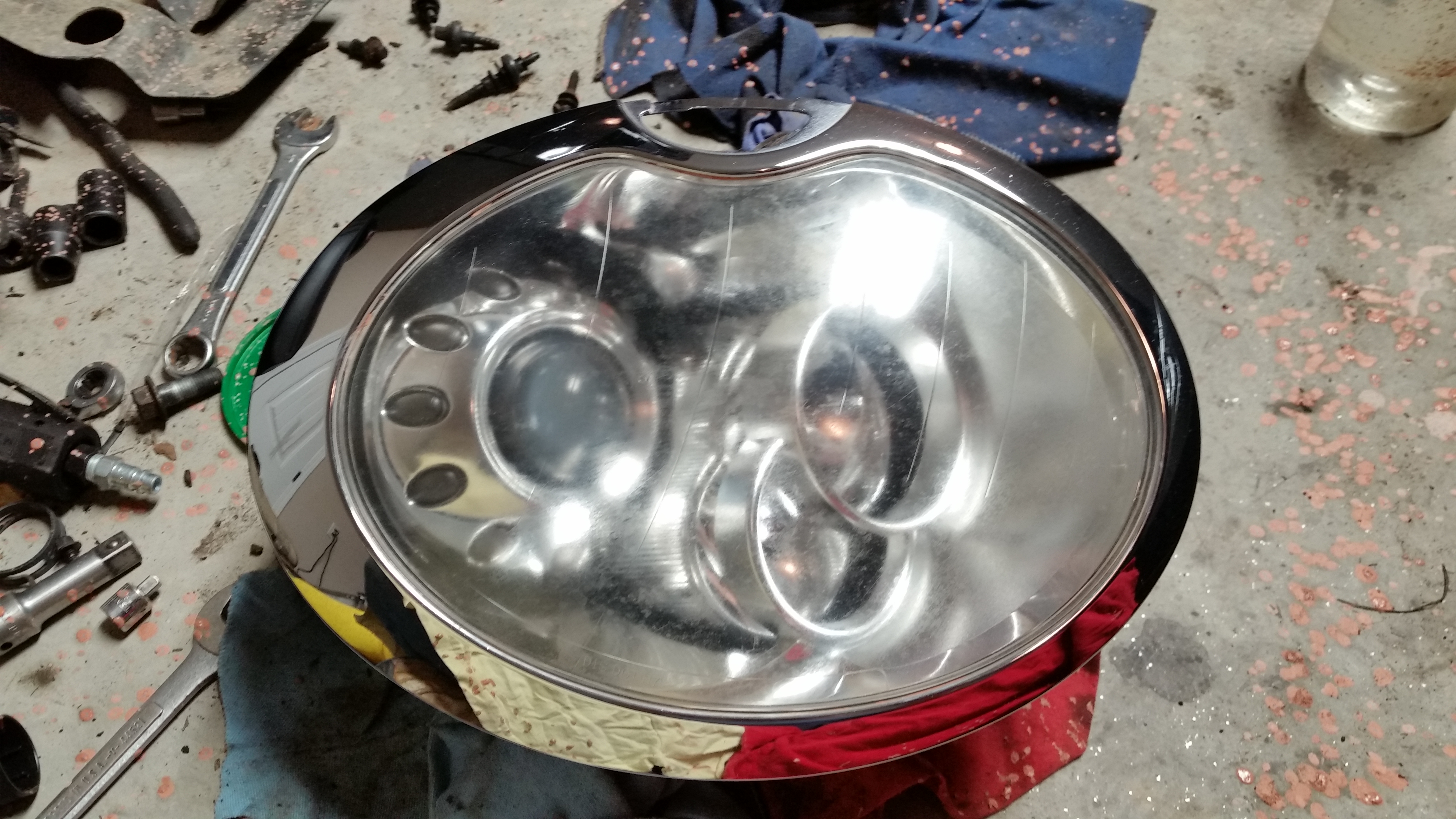

Headlights were hazed over... A little rubbing compound and time on them got them better... I need to do the 2000 grit sandpaper then repeat the rubbing compound...

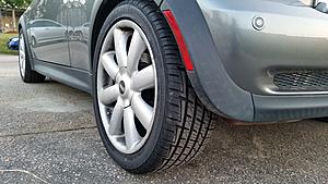

One more thing I wanted to mention... I looked thru the posts on tires and decided to go with the NON RunFlat tires... What a world of difference it makes!! For those that might be worried about being stranded, I'd say play it safe and go with the RFT.... But I have a few different individuals I can call to come save me (return favor as such), so I am going to see how things go... I've also not been plagued with a blowout that would render the tire unrepairable... I've had one pick up a couple nails, but the little light should indicate I need to check them ASAP or sooner... A can of goo and a small compressor should save me in dire circumstances...
I was going to go with the OEM size, but taking a closer look at the RF snow tires I had on the car, going one size wider was almost a positive thing to do... I went with the Firestone Firehawks AS in 215/45/17... I'm very impressed with the smoother comfort and far better grip!!! I'd like to add that the responsiveness the MINI has probably saved it's life, if not our lives... The emergency lane change definitely kept the car scratch free!!! I'm sure I would have survived, but probably banged up if I was in something else... So... Happy motoring!!! Here are some pictures if I can get them to post...
Cheers all!!

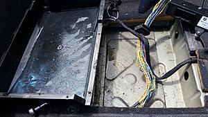

I'm sure that this K-bus connection under the passenger front seat is only for convertibles. I have a 2004 S hardtop, I pulled the front seat from it and there wasn't anything under the carpet.
Fairly certain that being a convertible that both our cars leaked at some point. My carpet and insulation was very wet under there
After I removed that OE style connector and soldered all the wires together, the following items started working again in my car:
Power top, rear parking sensors, chime for the key left in ignition and when you hold the key close to ignition switch, navigation system started to work again, and maybe a few other things also.
The only things that don't work in my car now is the key fob buttons to lock and unlock the car, and the garage door opener system in the inside rear view mirror

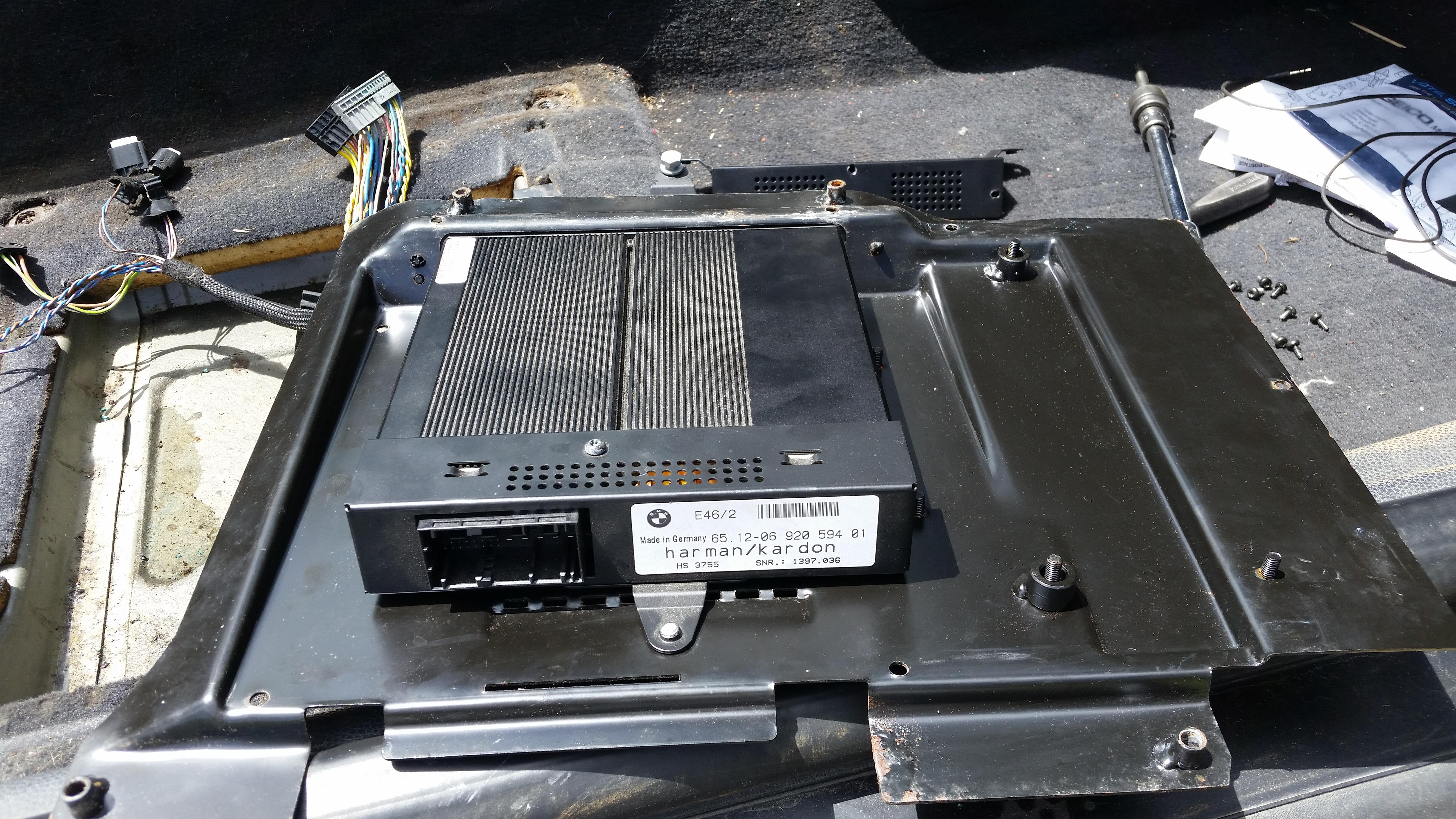

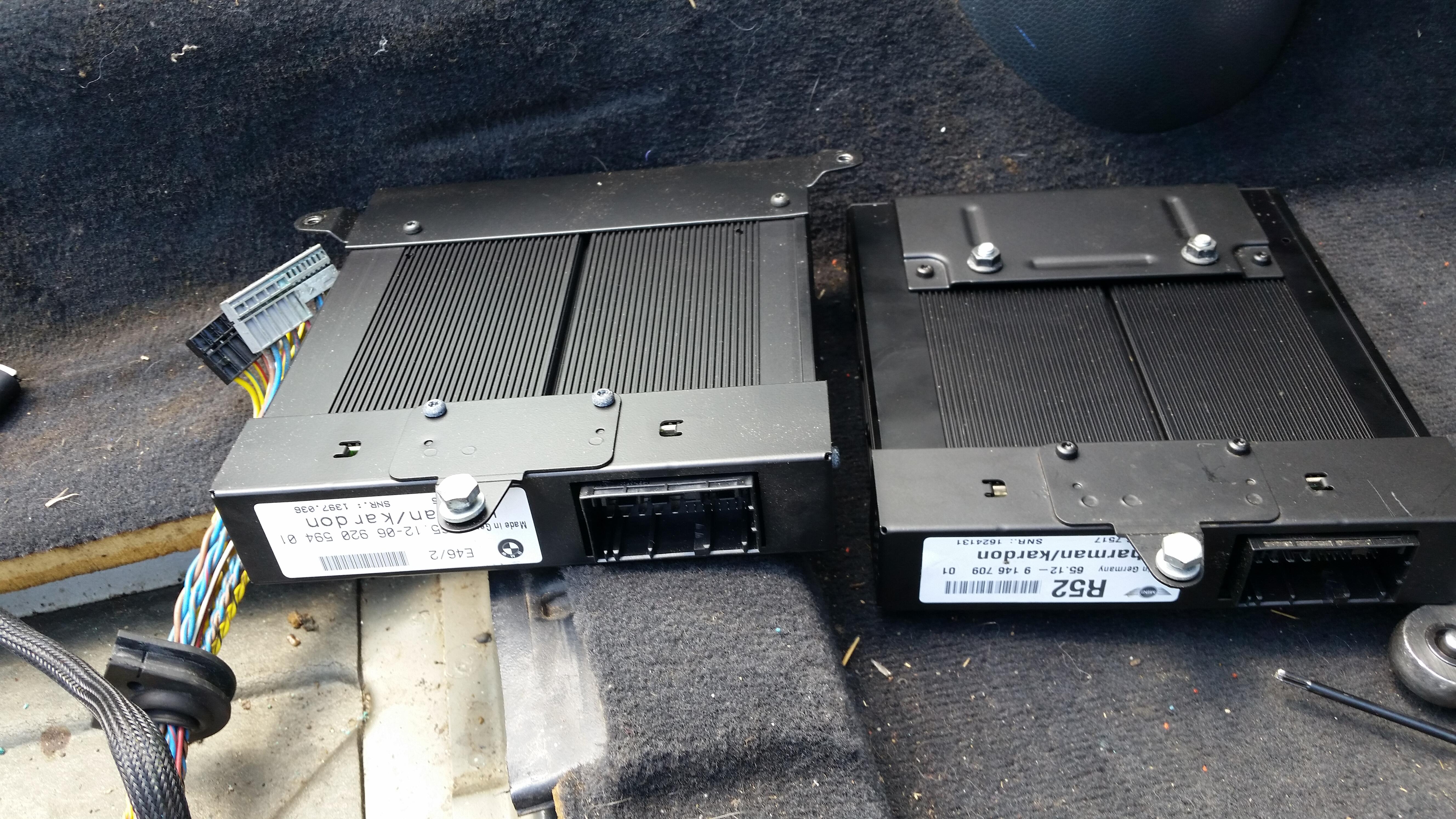

Amp option...
Good day everyone!!
Well, it has been some time since I got on here... My restore has progressed once again after the motor replacement... I over did the performance part and stressed out the #3 rod bearing... It destroyed itself and took out the crank and rod... New bearings did not prove worthy... Okay...
So, I found a good parts car in the YPIY (you pull it yard)... I pulled the trans, half shafts (my boots were toast), cup holder, super charger (spare), and a few other odds and ends...
I had a spare E46 amp from my son's project... It looked exactly like the mini amp... Even the plug is the same...
So, I did some pinout comparison and got it to work...
First, I had to swap the rear amp end cover so the mounting would work... See pictures... I also got rid of the water collection tank... If your top leaks, water will find its way to the amp storage and short it out... The mini's amp is solid state... The E46 amp is not... It might get hotter, but getting rid of the tank opens up some more air flow and will allow any water to drain... So, I think it will last longer...
You have to swap some pins around... And change four pins from wide spade to needle pin version...
Here is the list! Pins in xx move to new spot xx...
1 to 22
2 to 23
11 to 33
12 to 34
13 to 11
21 to 12
22 to 32 (X)
23 to 31 (X)
24 to 21 (X)
25 to 13 (X)
31 to 42
32 to 41
33 to 40
34 to 39
The ones with (X)'s are the ones you need to change... Almost all BMW connectors have the same pins...
There is one drawback... You lose the steering wheel controls... They are connected to the amp... And the fade is also controlled thru the OEM amp... But all speakers work...
The amp might fail, but the E46 amps are dime a dozen!! Not $125 for one, if you can fine one!
Oddly enough, whatever chemicals in the carpet get rinsed out when water finds it's way in, they corrode the connections... I doubt clean water would do it... Well, my power wire (of all the wires) decided to corrode and break...
Let me know if you need some pins with wire or whatever...
Cheers all!!!
Attached Thumbnails 08 Ragtop Cooper S restore!!-20200420_141939.jpg   08 Ragtop Cooper S restore!!-20200420_141944.jpg   08 Ragtop Cooper S restore!!-20200420_142027.jpg   08 Ragtop Cooper S restore!!-20200420_142101.jpg   08 Ragtop Cooper S restore!!-20200420_142448.jpg
08 Ragtop Cooper S restore!!-20200420_142459.jpg   08 Ragtop Cooper S restore!!-20200420_142516.jpg   08 Ragtop Cooper S restore!!-20200420_142913.jpg   08 Ragtop Cooper S restore!!-20200420_142003.jpg   08 Ragtop Cooper S restore!!-20200420_143118.jpg

The EWS did not have signal due to the corrosion and wire breaks... So I searched... If I "reseeded" the codes, it might fix itself... It did work... Took some time to find the place in INPA, but it finally appeared on the right hand side of the screen under engine.dme. Shift F6.... Then choose Reset (F2)... Cycle power and it should clear out...
Okay, so pull the white/red/yellow wire (K-bus wire) from the connection that usually fails or the amp connector... And if you loose synch, use INPA to "reseed" the mods... Oh, any rear window issues are also found above... I made my own gear to replace the plastic one... No further issues...
