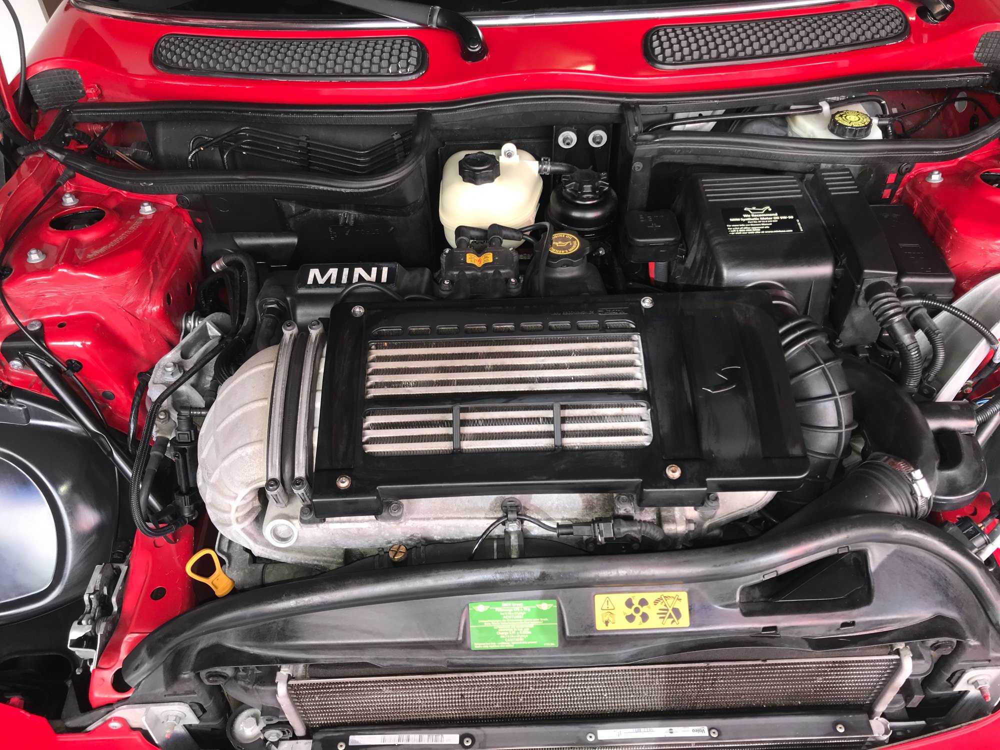

My girlfriend’s father was a 747 pilot for Pan Am. She loved him very dearly, and he left her his Chili Red 2007 Cooper S Convertible. I’m an amateur mechanic, and I’ve created this thread to document its restoration.
The car isn't in terrible shape, but it definitely runs a little rough. In work to date, the air filter was absolutely filthy and replacing it and the spark plugs greatly improved performance and my girlfriend is very happy with the improvement. The plugs looked pretty good when I pulled them, so I think it was a clogged air filter that was robbing performance. The car shakes quite a bit on idle, and so my next project is to replace the engine mounts. After that, let's see how she runs and troubleshoot what may be remaining.
I'll begin with what's been done and what remains. I'll update this post as my "to-do" list through the project:

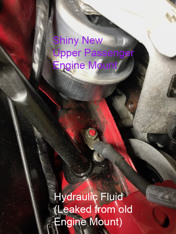

Last night, I replaced the two engine mounts. It was much easier than I thought. I couldn't tell if the bottom mount needed replacement or not, but I replaced it. But the top passenger side mount was very obviously in need of replacement.
The attached photograph shows a lot of black goop that leaked out of the engine mount. Once the mount was removed, it was easy to see the difference in how the top bolt would very freely wiggle on the old mount and was stiff on the new one.
After installation of the two mounts, I test drove the car and immediately noticed a very substantial difference! The vibrating and shaking were all gone. I still have some squeaks and rattles to deal with, but the constant vibrating is gone!
QUESTION: There is a third mount, which is the Transmission Mount. Is there a way to determine if this mount has failed? Is replacement recommended for a 2007 Cooper S R52?

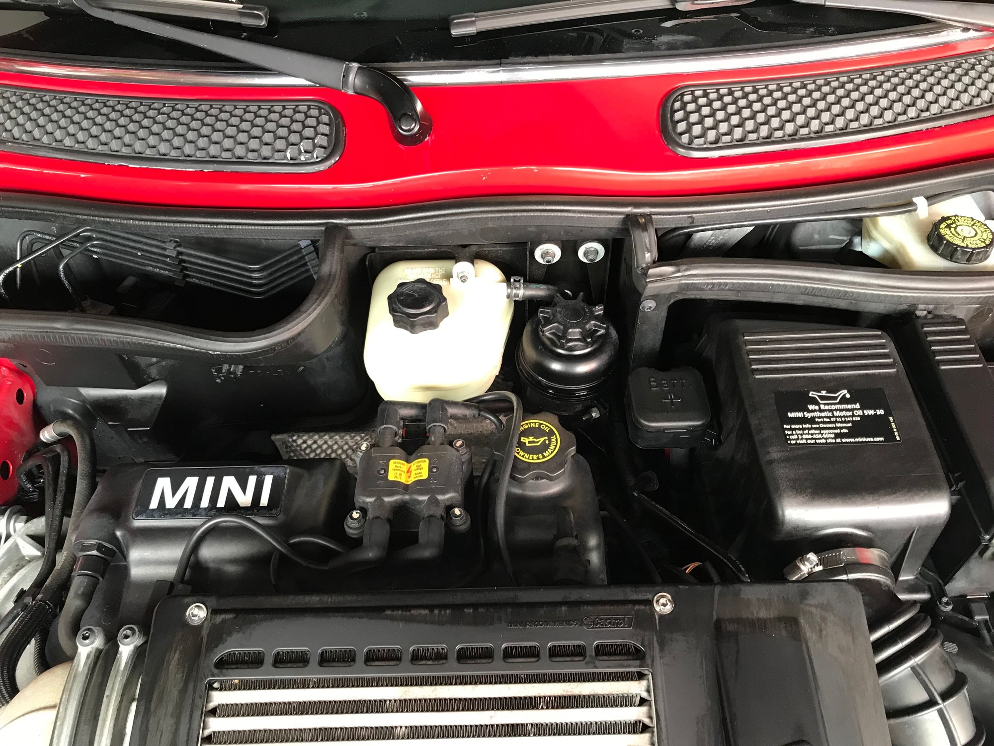

I noticed two things that need attention under the bonnet if you can let the new owner know. First, strut tower plates need to be added to prevent tower mushrooming and second, replace the plastic coolant expansion tank with one of aluminum. The plastic one WILL split at the seams eventually and we all know things like that will happen at the most inconvenient time and place.
Thank you very much! I appreciate all the tips.
I replaced the coolant tank last November (with another plastic one...) and I checked the strut towers, and I think they’re ok, as you can see in the photo, but I’ll mention that he might want to add some plates. He’s not a home mechanic, so I’m not sure. The power steering seems to be shot, and I let him know about that up front.

The strut tower defenders are easy peasy. Remove the nuts, lay it on and replace the nuts torqued to 25#.

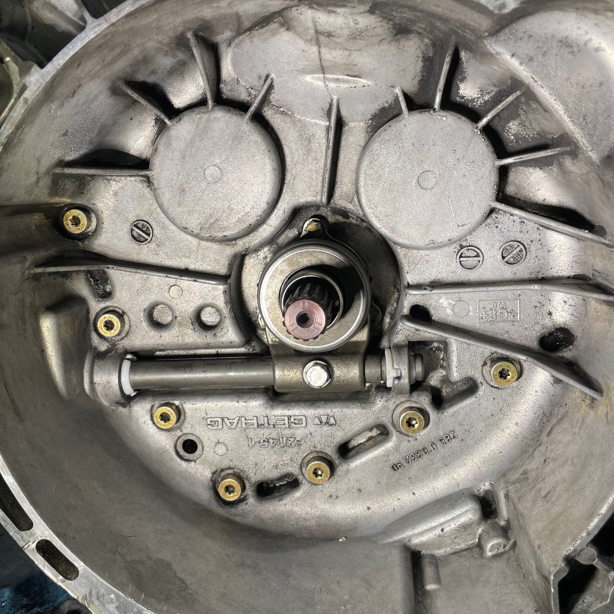

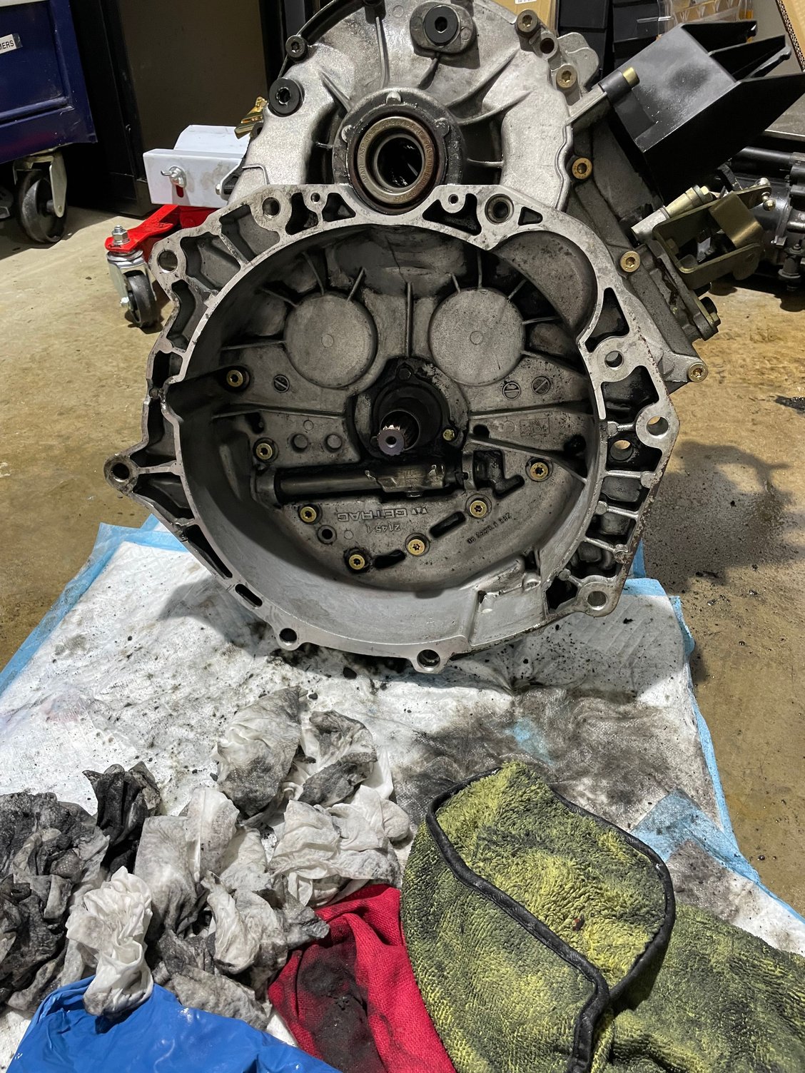

Hi Naysayer. Not sure you still follow this board, but now, a good friend has given me her old and somewhat neglected 2004 R53. I’ve been working on it for months, to give to my son.

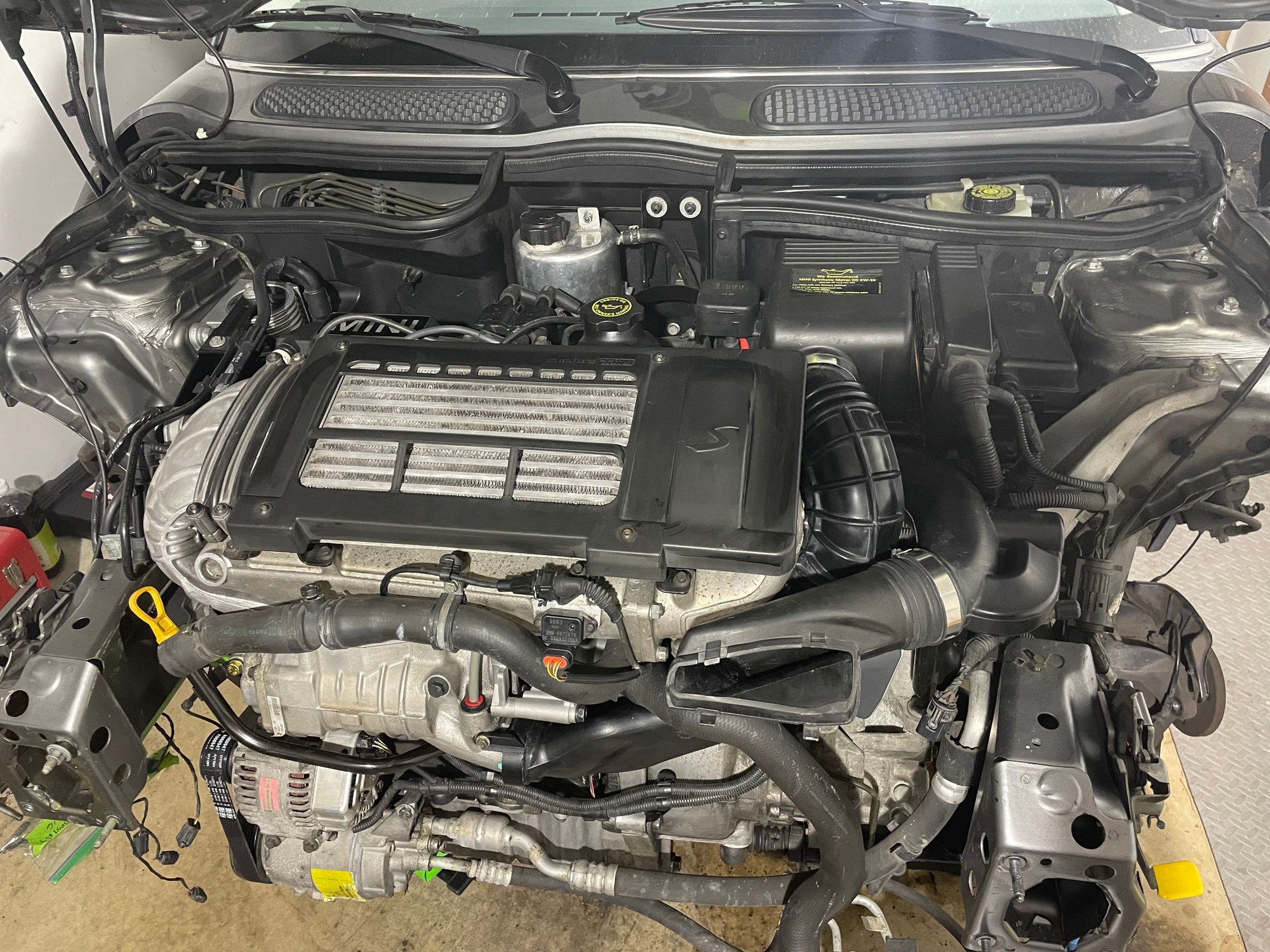

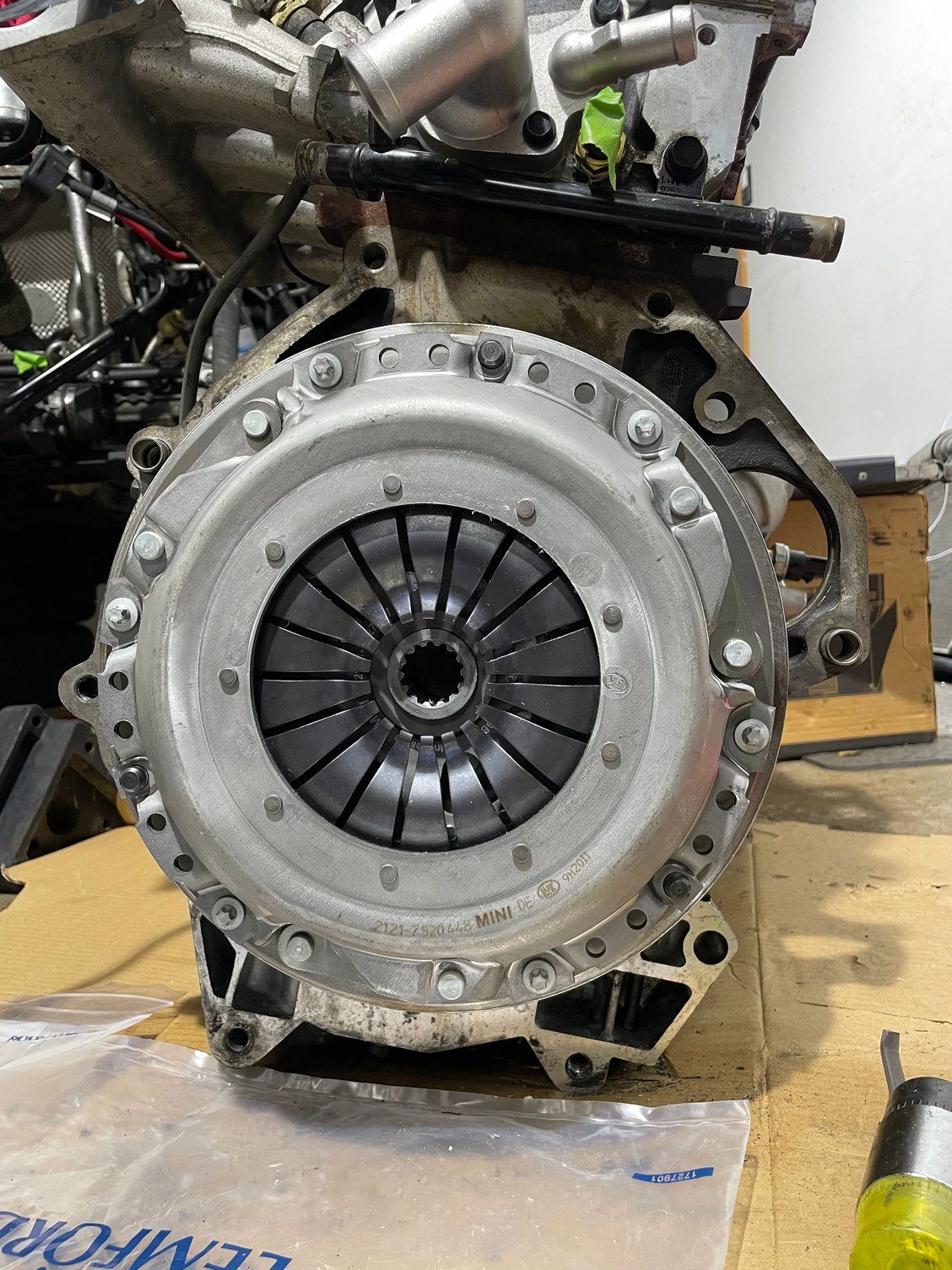

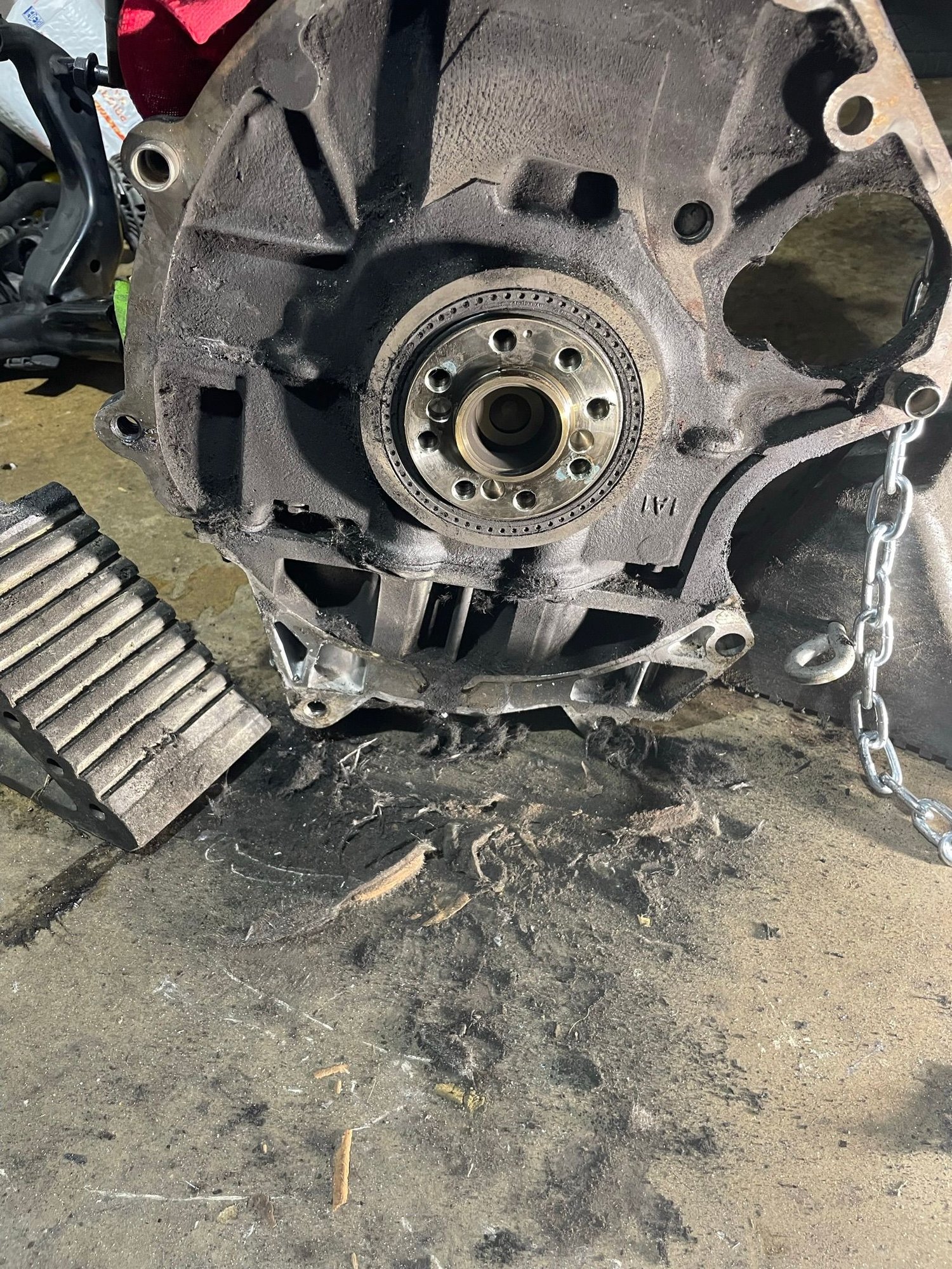

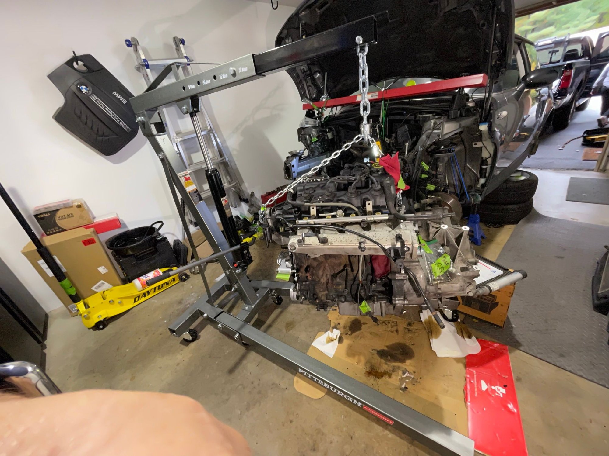

This car was leaking more oil than it held. I’m
hoping there’s no bearing damage, but I’ve replaced too many things to mention:
Clutch/throw out/Flywheel
Every single oil seal except the head gasket
One engine mount
All shocks
New brake shoes/pads all around
Control arm bushings
Control arms
All ball joints
Serviced the supercharger
New thermostat and housing
New water pump
I hope it starts.
This is the car today
A few days ago
Before putting the engine and trans back in
New clutch/flywheel back on
Oil pan removed for gasket replacement
Bell housing all cleaned up
Cleaning the bell housing. It was really bad
Bell housing after separation. Yikes!
Engine side after separation. Double yikes!!!

Wow shredded.
Old Oct 21, 2022 | 08:23 AM
Rebound's Avatar
Rebound
Joined: Nov 2016
Posts: 222
Likes: 78
Wow shredded.
Completely gone. And the throw out bearing looked even worse. It had been slipping for years.
