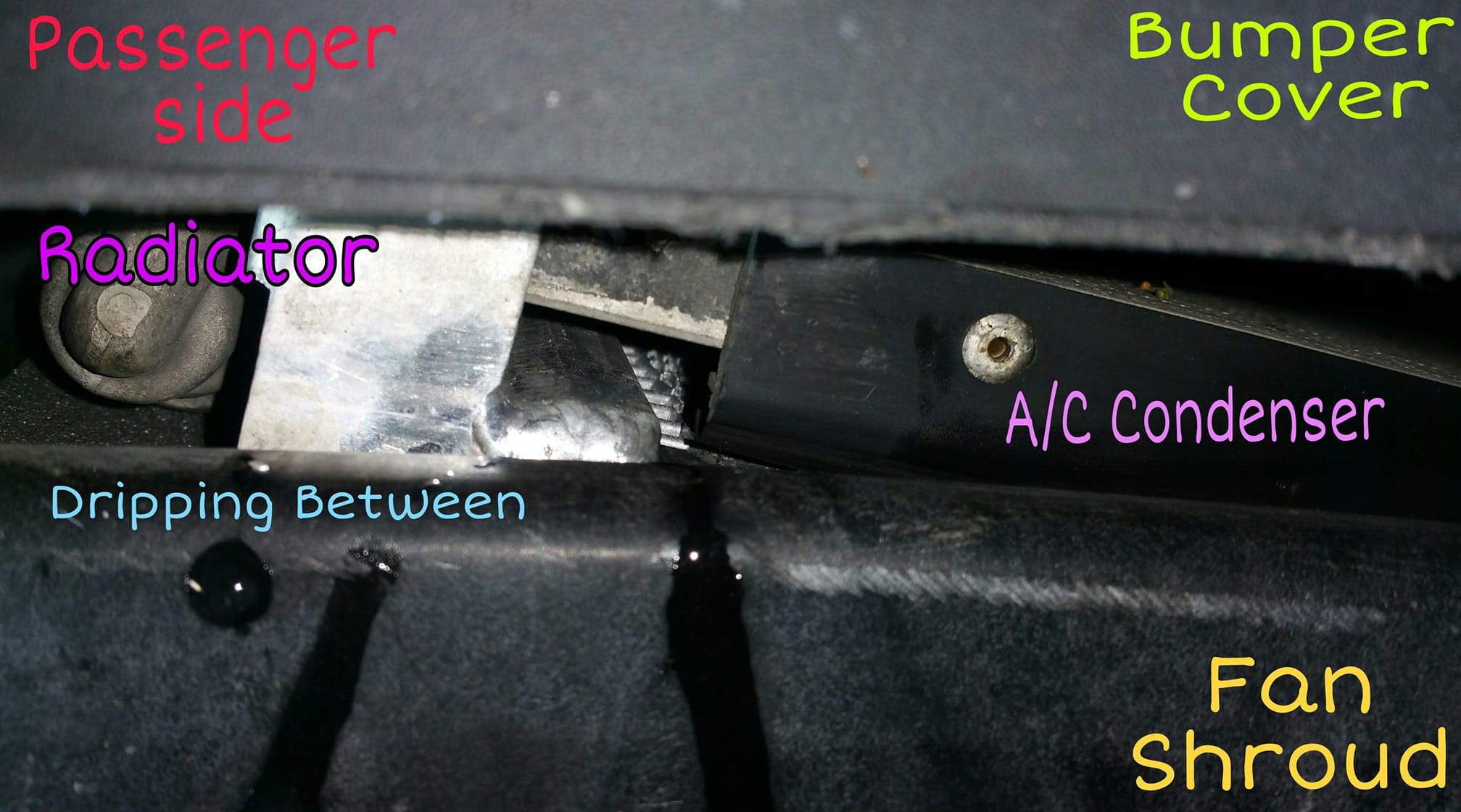

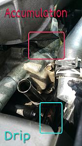

Looking for ideas on what might cause a pressurized coolant leak yielding accumulation on top of supercharger and around upper air duct when driving that might not be related to the head gasket. Fluid was running straight down onto alt. Everything else on top is dry. Coolant tank has obvious signs of loss from venting through valve (Canton tank.) Upper rad hoses quickly warm to touch, no leaks. Rad fan shroud is dry towards the inside of bay. Fluid drips from front of it, almost like its coming from between radiator and condenser. Slow steady drip at floor, tank loss aprox 1/2 after at max 65mi driven, fluid viscosity good, minimal discoloration likely from residual rust. No OBD2 codes coming up

Is it likely that the CSF rad has a leak less than 1 yr- 8mi?
