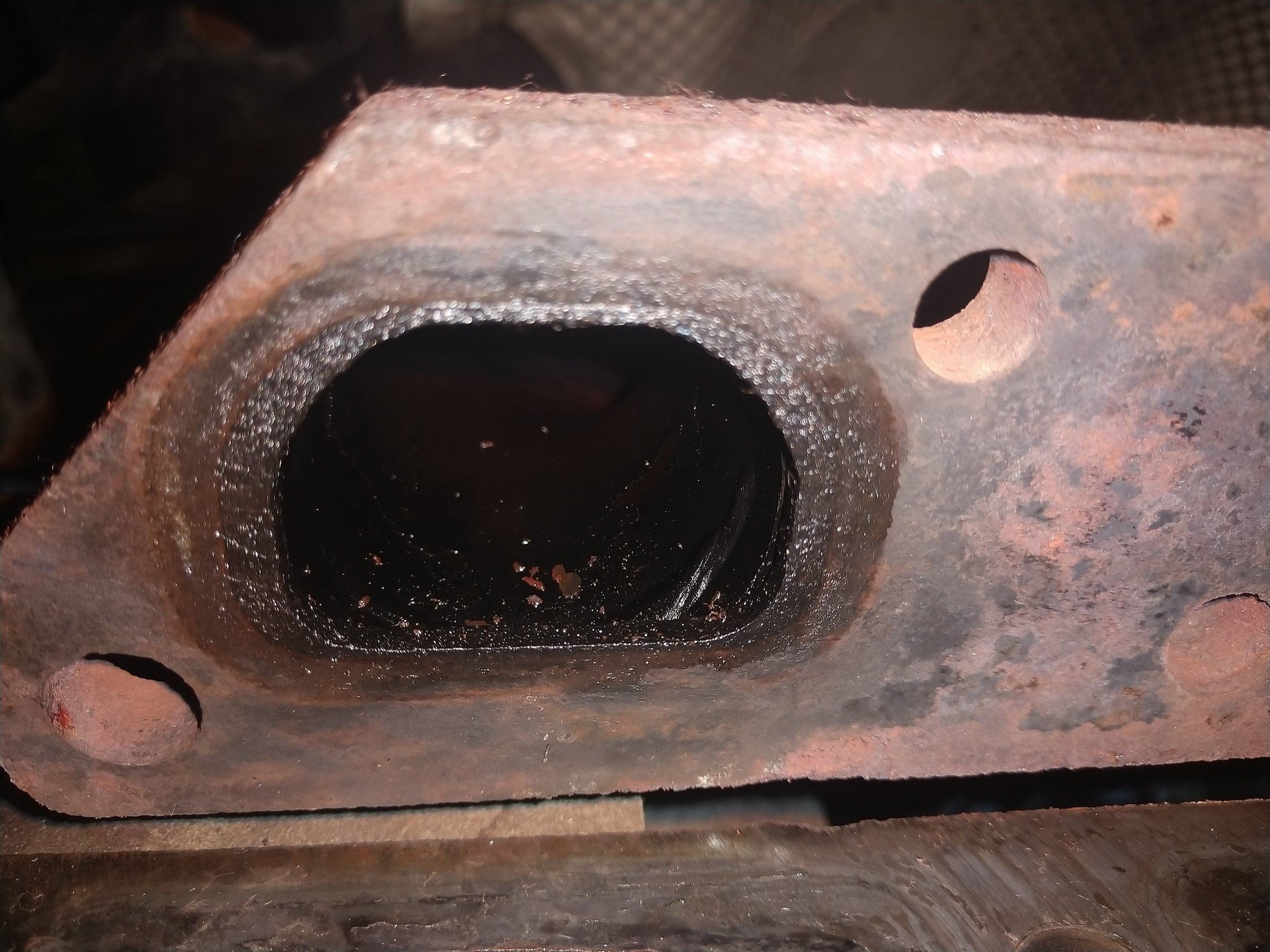

Some pictures from my mechanic. Coolant got blown into the exhaust on cylinders 1 and 2. 3 and 4 were dry. Cylinder head is getting checked out to make sure it is good to go. Still waiting on parts.

Cylinder head is warped.
looks like a new new cylinder head is in store for this nightmare vehicle... But! Good news is the car should run pretty good once it’s all put back together. Also replacing the timing chain. It had a little bit of play in it and since the motor is taken apart, might as well replace it now.
