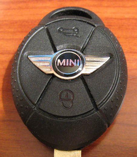

Yep. The MINI logo on my '06 locks the doors. The button near the metal key part unlocks the doors (one press = driver door... 2 presses = passenger and boot door... if programmed, press and hold = open windows and sunroof) and the other button opens the boot latch.
A pic for those members saying this thread is worthless without pics.
