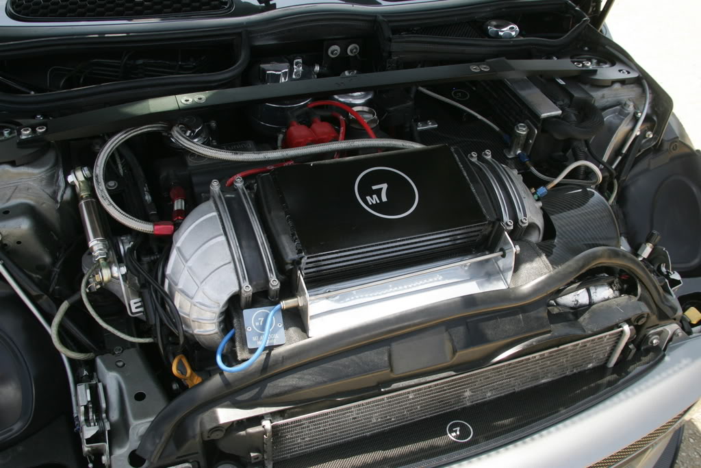

OK guys let me help you out a bit if i may. If you are going to go to the trouble to rip us off at least make it functional The only way it will work is if you close up those gaps . You need to enlarge that plate a bit to cover the front and both ends as well . The photo i have here is not that good but Will give you an idea as to where the errors are . As a side note we are coming out with a fiber glass unit with the proper shape at a considerably less price than the CF piece.

First of all I like this thread . I think DIY projects are part of what make modifying cars such a fun thing. I have done a ton to my own car and it is very rewarding . When i see something like this though , when the size shape and even the name are the same as something we designed, developed and tested it does stand out. Perhaps " ripped off " is too strong a word for you but what else fits this situation ? Put it this way if we had not made one would this " version " exist ?
In any event my original intent was to help you make it at least work if you are going to the trouble to " create " one for yourself. Its not the first time our products have been " replicated " by the end user and I am sure not the last . It is in its own way a form of flattery.
As for the price , yes the CF is pricey, our parts are not for everyone . And again I will say that we are comming out with a less costly version for the more budget conscious.

Randy - thanks for being a good sport.
The M7 version is truly a work of art and I suggest that anyone who does not want to build one, purchase the M7. It does look great on the car and M7 did do all the testing.
Just for the record, I built mine mainly to create a rigid platform to mount a future oil cooler.
Thanks Randy

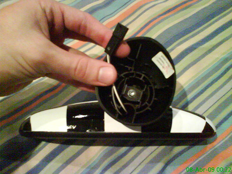

Well, finally after time thinking about, i just finished my checkered rear mirror for my r53 FROM 2003, after seeing that only was available for cars after july 2004 painted with a first layer of primer, then black shine and finally with adhesive and white paint, im very very happy now and looks awesome, check pics:

Great job!

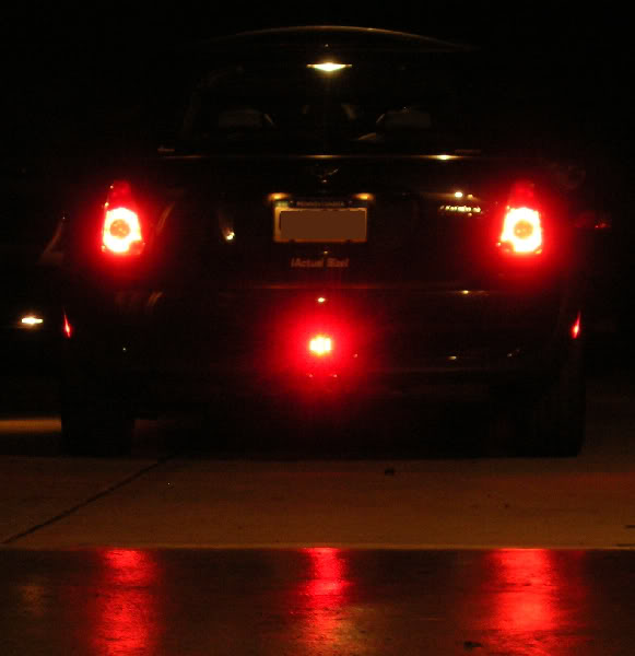

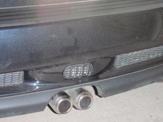

I'm DONE with my LED rear foglight! The cost was about $20-30, the results are good, but it took a while to think through and wire up. The how-to can be found here. It's brighter than brake lights, and almost completely stealth when off. I wired it to my trailer rear taillight wiring, so it can only be "on" when the parking lights are on. It's run off an armored switch in the center console that's impossible to turn on accidentally since rear fogs are OBNOXIOUS AS ANYTHING when it's not seriously foggy... but they're great for backing off tailgaters!
The same technique can be used for other kinds of accent lighting I suppose, or to put a rear fog on the R56 rear grilles...
Looks like this off:

And like this on (my camera takes bad night shots):
