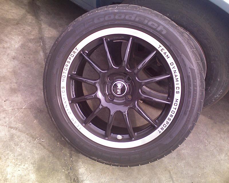

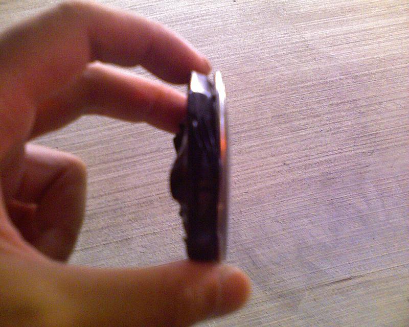

This is an awesome solution. I had similar gripes about the center caps on my Team Dynamics. I did the same thing after reading this thread. I couldn't find plastic ones at my local hardware stores, so I went with metal. Still around $5. Instead of 2" I used the 1.5" and just expanded the prongs out a bit. They sit in the hole perfectly flush.
They were rattling like crazy as I tried driving so I wrapped like 6-10 winds of super 77 electrical tape and popped them back in. Super snugg. I went to the dealer and bought some of those sticker backed metal wheel cap covers and "Goop"ed them permanently to the wheel caps. They look really slick! Match my wheels perfectly and very OEM looking.
Plus, I can very easily pry them off and pop them back on without damaging them if need be.

Here are some pictures. Sorry about the quality, they're off my phone.

Does MINI make JCW centers pre-made? With these that I bought from the dealer, they have a bit of a radius to them so I ended up using "Goop" to stick them on there and fill the gap. If you can't find those JCW caps, you might consider getting a vinyl shop to make custom stickers for you. It'll cost a little more, but then you can put any design you want on there
