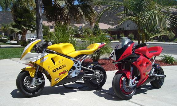

NewB here ....... Just got my 06 MCS and looking to find a hitch that will give my MCS a clean look and to alow me to two my 3 minimoto bikes ( see pictures attach ). Any info on where to get one ????? Thank you

Sorry ...but they are not scooter .... Scooter is what my kids ride on the side walk, these machine are call "Minimoto" build by the Italian and can go up to 60mph ( strictly for racing on the track )
Thanks for the props though :smile:

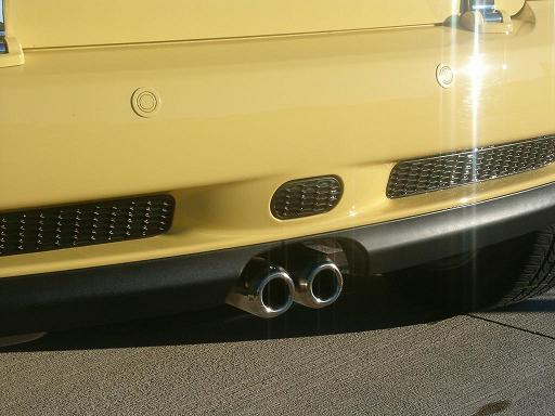

DAMMIT DAMMIT DAMMIT!!!!!! I wish I would have seen this style of hitch a month ago, before I spent close to a $1000 for the sport link, bike rack, and tow hitch. Took me 8hrs to install and now it looks like I have two more exhaust tips sticking out my bumper.
Aww come on man, they're cool... just say they are the oil slick nozzles.
Seriously, it would be cool to have little stickers (legible though) to put on the back, pointing to them and calling them that hehe.
