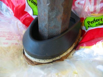

Pictures of a Kludge :)
How to do a Kludge on the Clutch Pedal Pad Thickness; and, did it do any good.
I used several layers of leather, and some Gorilla Glue, to increase the thickness of the pad between 1/2 and 3/4 of an inch.
Did you ever use Gorilla Glue? First time for me. It has to be clamped, which is what the steel rod is doing; the plastic keeps glue from getting on the towel (which would make my wife unhappy); the towel serves to distribute pressure over the curved surface.
A closer view. Note the Gorilla Glue oozing out the edges.
This is my foot pressing the clutch pedal to the floor. Think how the angles work: the raised pad gives my toe more clearance from the clutch lever. It actually works.
The kludge in place. If I do it again I'll try to fix the layers in place, to keep them from sliding sideways.
I'm pleased with the result but wondering whether another 1/4 inch would be even better. It's snowing out, so this will have to do until spring.
