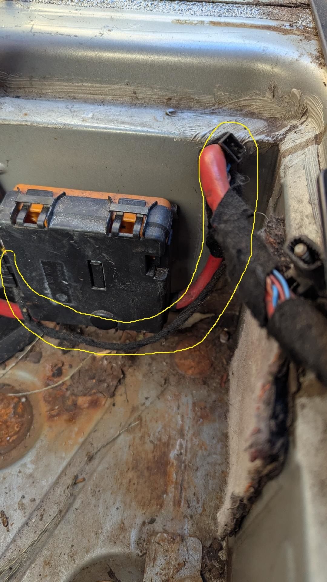

It doesn't look bad here
But in this picture there is a plug taped to the positive wire and nothing around it to plug into it
Gas is only few months old. I drained it about 3 months ago and put fresh gas in just before I replaced the fuel pump and both filters. I did look at BST and looks intact but there is a random wire that comes of of it and has a plug on the end and nothing plugged into it

the squib thing, if it were blown, would break the positive side of the circuit to your battery. Since you are getting crank, thats not likely

what is this supposed to be pluged into???

i see. missed that. not sure. i can take a look at mine later tonight

Well, I was hoping to get to my laptop to draw/ indicate what I thought might be a slight breech in the black plastic casing that houses the BST/detonator in the second pic of your post#16. That black plastic cylindrical thing.
Like I'd mentioned in my scenario (occurred years ago)...
the large positive cable going into the squib/ BST/cylinder somehow was pulled and pulled the end of the metal end of the cable away from the inside of the "explosive" end of the detonator ....sufficed to say ; My BST did not detonate. The 2 contact points were pulled apart and barely making contact completing the circuit....
I'm not suggesting that is the same in your case.... I just find it interesting.

"Check the BST: Look for a yellow connector and a small, damaged/disconnected cylinder on the positive battery cable."
i think op's yellow connector is not plugged in.
