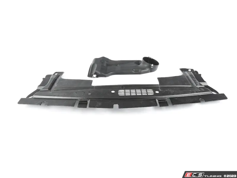

That factory skid plate w/snorkel to the PS fan seems to be rather rare. Ive always wanted one. I'm not sure what they're called - Do they still make them...or is it just another gem item to look out for at the junk yard?

Yep,
I have seen people do this as a mod. Thing is it still does not protect the underbody near the engine. More of protection of the fan and those shopping bags that can get sucked into the fan and ruin the pump.
https://www.ecstuning.com/b-genuine-...51757201784kt/
