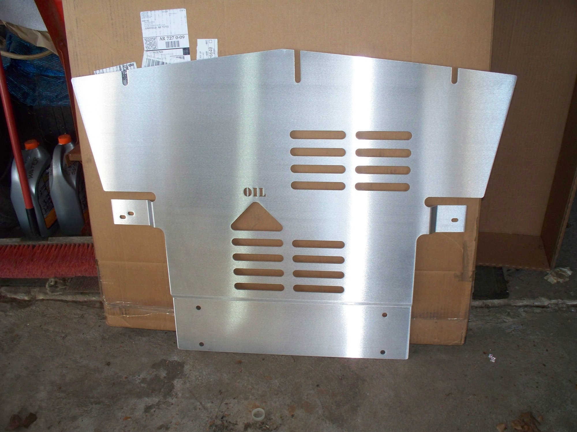

Look up Skid Plate Guy on Facebook. I have bought several from him for different cars. Always good quality and fitment.
Picture below is for my daughters 2003 S model. It installed in 30 minutes, with real bolts, not plastic clips.

It was just over $400 shipped.
It is 5mm aluminum.
It uses existing holes in the sub frame and frame horns. Steel U-nuts, with a real nut are slid over the holes and a bolt goes through the skid plate into the nut.
I am NOT a fan of having the access holes for service. It tends to encourage debris to accumulate on the pan (like rocks) that could lead to problems - like wearing a hole in the oil pan on our Rallycross car. Holes would also let stuff in - compounding the problem.
It is removed in minutes with 4 bolts. Three or four times a year is not an issue for me.
Regarding ground clearance - I also have an Audi A6 S-line with a skid plate from Skid Plate Guy. 6mm aluminum. This winter the frozen snow clumps have done a job on that plate. One dent is over 1" deep. It bent the whole plate upward.
The Mini has a full 1" less ground clearance than my A6. My daughter doesn't drive it in the winter due to it's low miles and great condition, but we live out in the country and have other hazards to deal with in the summer like road kill, dried clumps of mud and rocks falling off farm machinery, construction debris, firewood. This car sits very close to the road, the power steering assembly and cooling fan are all exposed and would be the first to go.

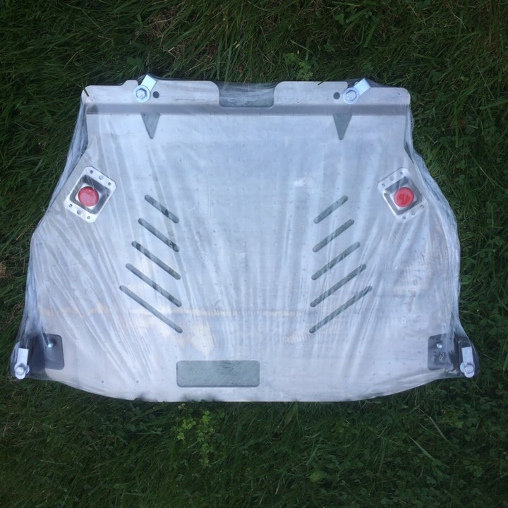

Here is my Rennline skid plate. It didn't keep a mouse from nesting on the fuel tank and eating through my fuel pump wires, but I've had no damage in the front with the Rennline. Gives me some peace of mind.

Looks great, i need to get that for my R52 since i am lowered now.
