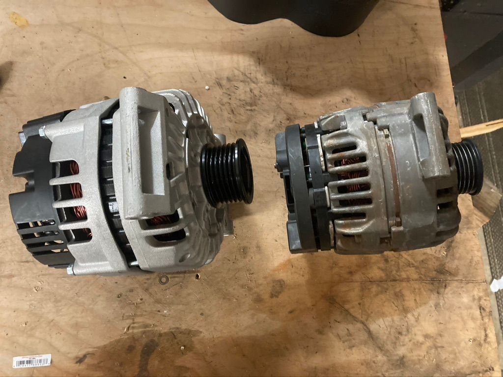

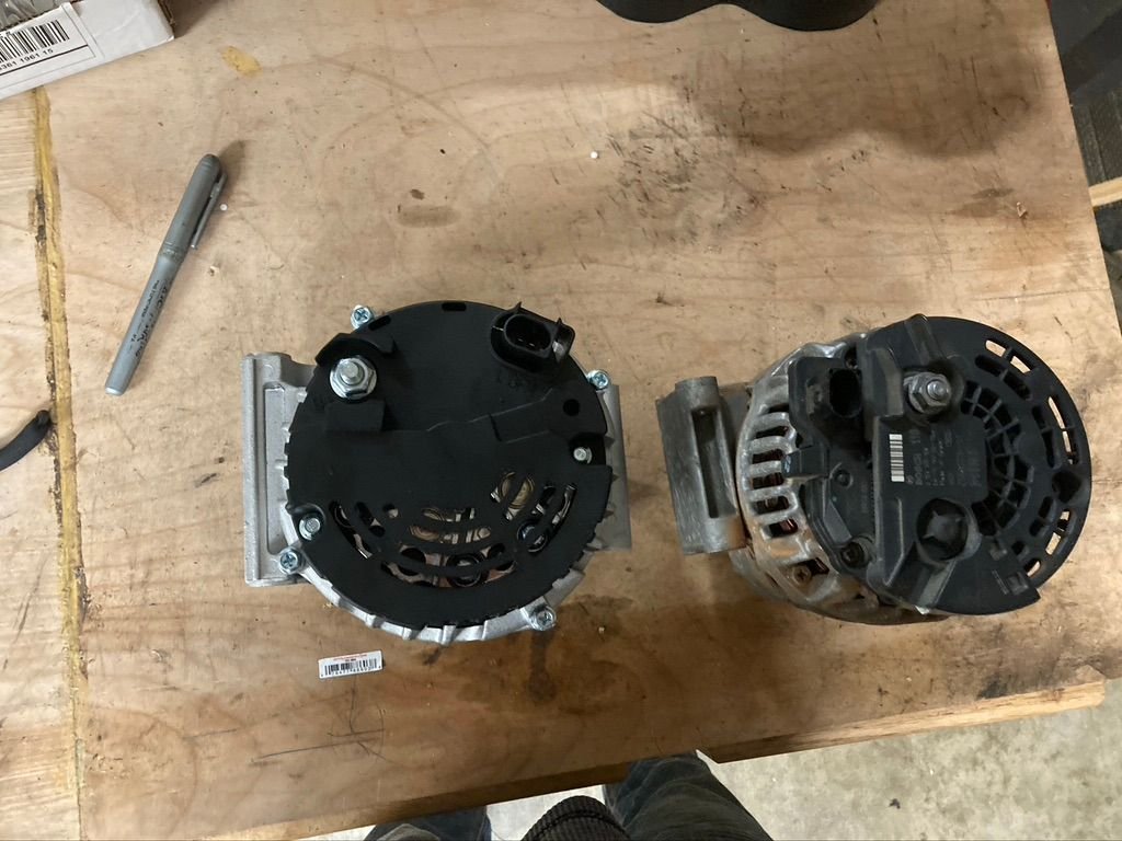

hi- I have a 2004 base model with an r50 engine and simply trying to replace the alternator.
I ordered one but what came was different, in a few major ways than the one that was in there. I assumed I was mailed the wrong one but when I went to the parts store they pulled they same one. So i had them dig out all the mini alternators they had in stock and the exact match was for a 2005. (yes i've run the VIN and looked at the title; my car IS a 2004).
I waited too long to do this work and can no longer return the new part.

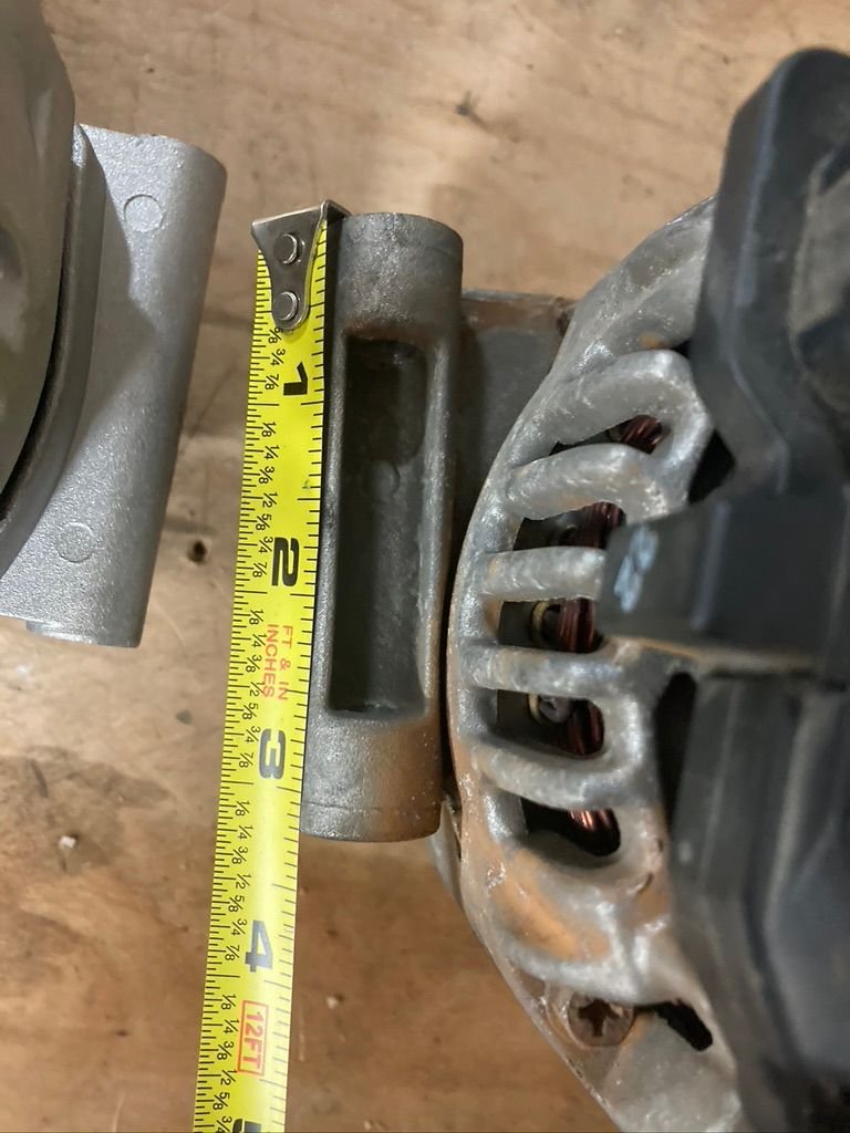

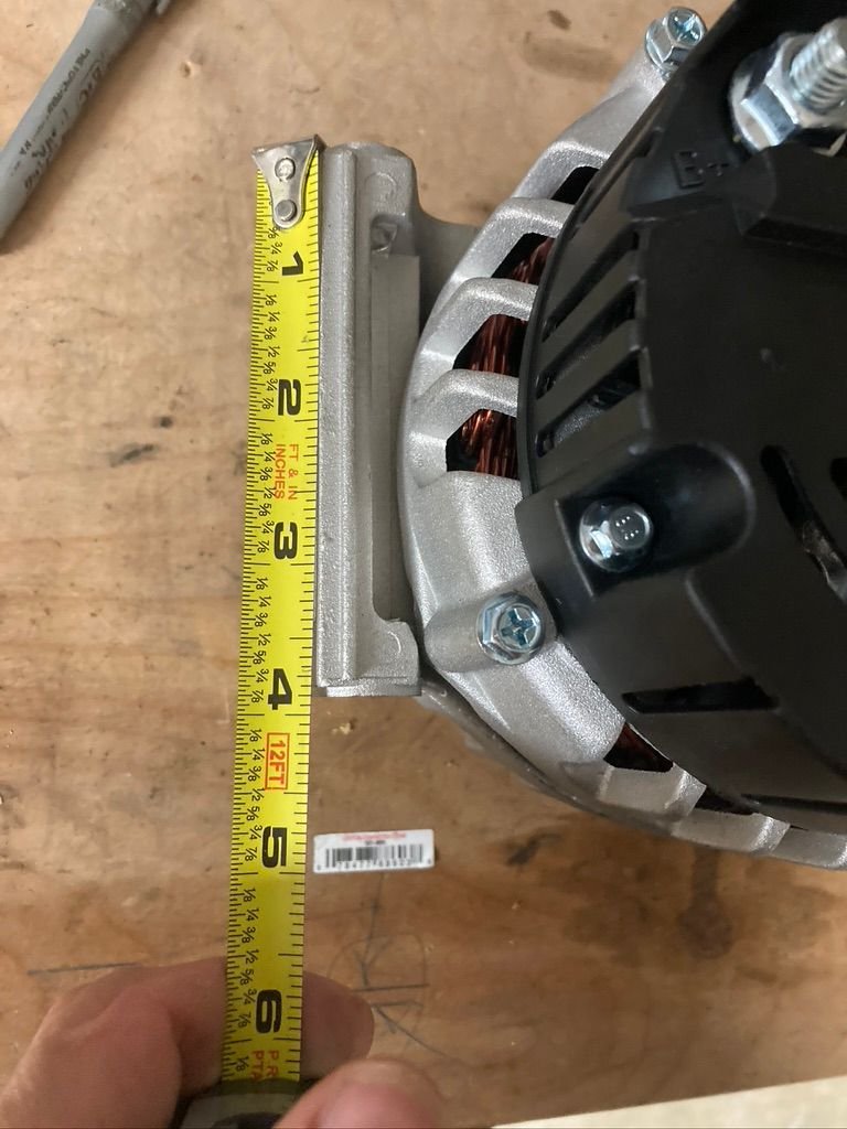

The one that came out of the car is a Bosch 14v / 110A while the one that parts stores have listed as a fit for a 2004 is a 12v / 120A. Also the bolts are too short for the replacement since the mounting slots are longer on the new one. I've measured the new one from a few different angles and i think that the pulley will sit in essentially the same place when mounted in the engine with maybe an outward a variance of 1/8" at the most.
naturally i don't wanna buy a whole other new alternator -
Can I just buy longer mounting bolts and install the new one i am stuck with?
Attached some pics of the two-
Thanks in advance.

Have you owned the car since new? I'm wondering if the engine may have been replaced at some point (2005+ engine on the 2004 chassis).
I did a quick search on realoem.com and then ran an google image search for the alternators this is what I came up with:
June 2004 build - part number 12317515029
June 2006 build - part number 12317550997
As you can see, it came up with two different alternators with different mounting points.

I bought the car from a friend who has provided me with some fairly details repair records. Swapping an engine I have to assume would be something he's remember. Pretty sure he was the only owner but will double check.
Thanks for the image search. The one on the bottom is what came out of it. Do you know if there's a serial# stamp somewhere on the engine I can get a pic of? This is all so bizarre.
