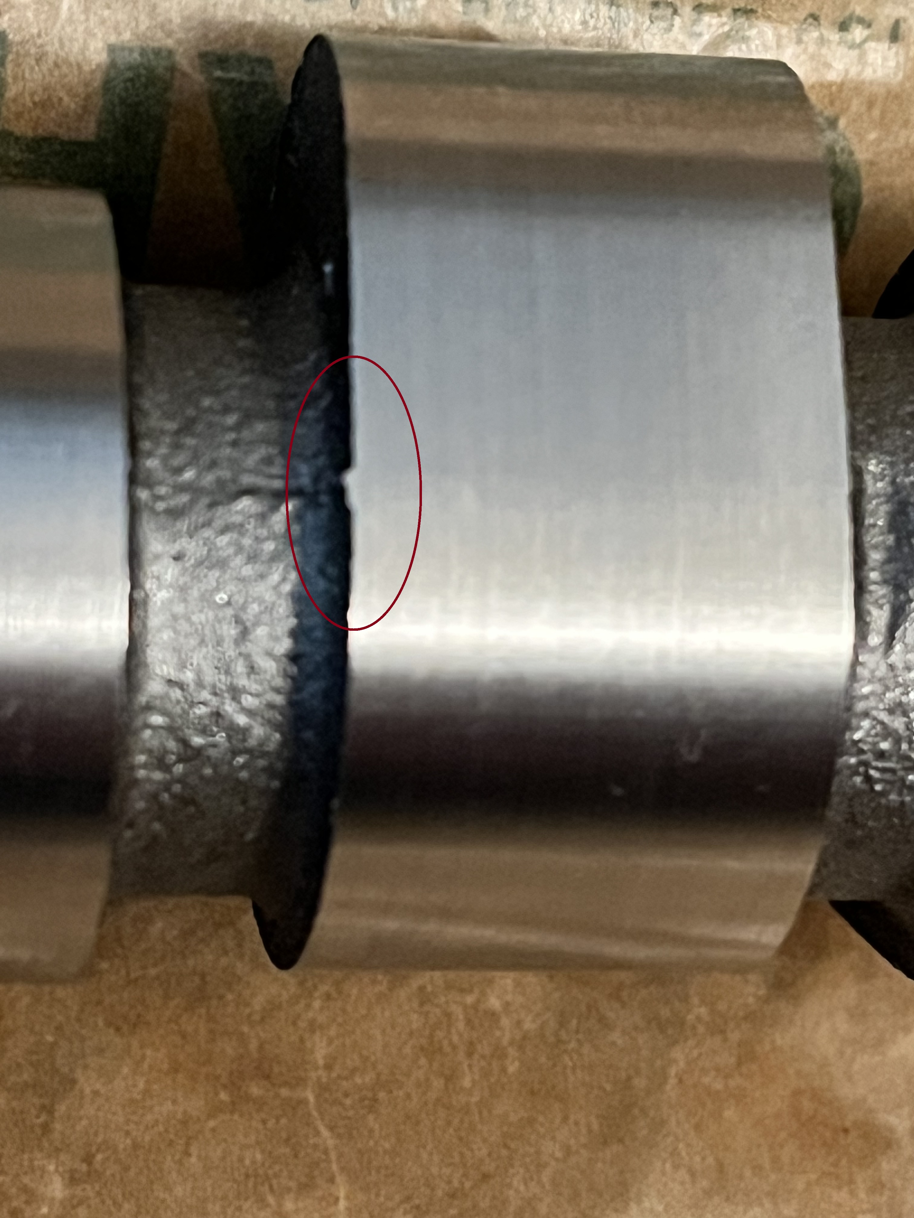

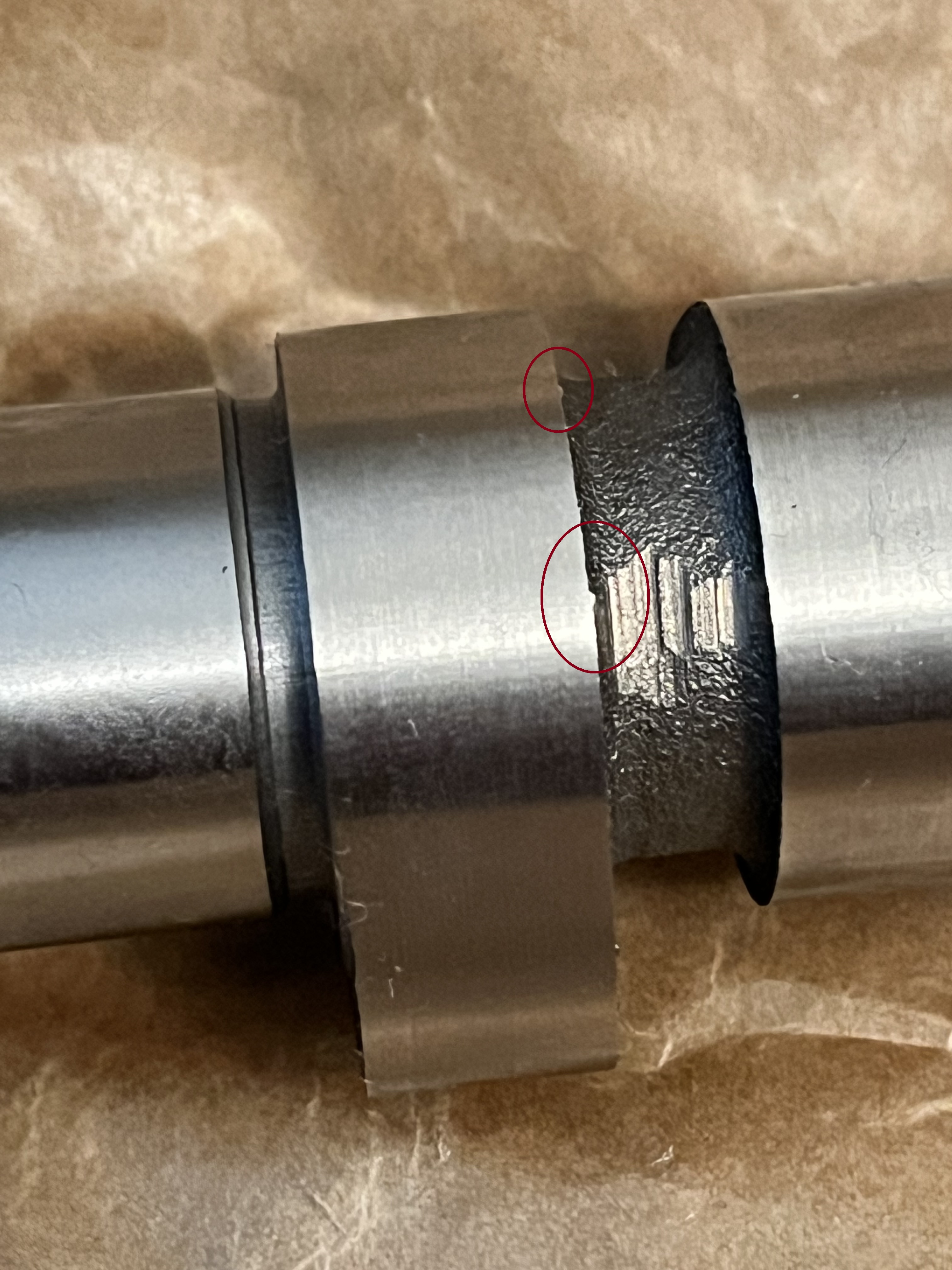

I just received a new Newman PH2 Cam for my R53. On inspection it looks like it has a few imperfections. Should I be concerend or are these normal since it's a modified cam?

Looks like poor quality control. I would be more concerned with the scratches on the lobe in your third attached photo. Send it back.

Thank you for the info. The I cleaned the lobes and they look pristine. The vendor said that that the imperfections are from the cam casting process and won't interfere with anything. Should I just sand off those imperfections carefully or leave them?

Shouldn't matter one way or the other as long as you're careful and don't remove additional lobe material to negatively affect balance.

assuming its balanced i would leave them.
i dont know enough to make a judgement regarding the scratches

The scratches were just dust fibers. Thank you bot hfor your advice!
