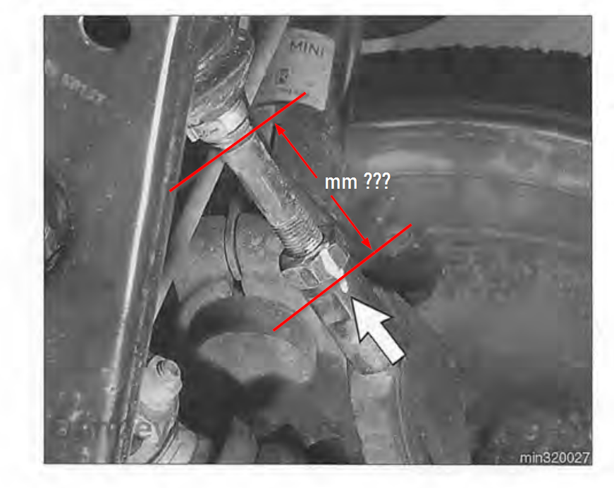

Hello,
I am planning on refreshing my r53's outer ball joint and inner tie rod.
My question is here is, what is the default length specification of the inner tie rod and the outer tie rod ball joint?
I looked everywhere even in manuals there's no mention of this. I am sure they have atleast a standard length when they first assembled this from the factory, then calibrate\ or align later at QC department.
Here's a sample of what I am talking about, this one is from an infiniti sedan they have the exact measurement.
Now for R53 minis what would this be?
Thanks in advance.

Never come across that in the world of euro stuff ( Volvo, Audi, SAAB, BMW or Mini. Measure / thread count the old, compare lengths of new parts, adjust as close as you can.

There might be something like that in the Assembly Instructions at the Factory, but us lonely wrench turners have to do it the practical way ... measure the old one (the one on the car) then set the new one to that measurement, the front end will still require an alignment, but this should get it close. You can also use the "String Alignment Method" to set your alignment but I would still recommend a full blown alignment when done.

I can't believe the europeans don't have the standard measurement for this. So you are saying say we have 5 Assembly Techs doing the same thing assembling the inner and outer tie rod, Tech1 is putting 2 inches, Tech2 = 1.5 inch Tech3 = 3 inches and so on., each one has its own ? depending on what what the tech put in? there's got to be standard measurement, these guys are assembling from scratch.
I know what you're saying "measure the existing one" but I am assembling this from scratch I am bringing it to stock factory then after that I will bring it to Alignment shop.
The reason why I want to do this is for some reason the mechanic who worked on my r53 put in different brand Inner and outer tie rods with different sizes ( i want to replace it with OEM, or original ), so now which one I am going to measure, I mean which one is closest to factory based on what I have?
That's why I asked for this.... there's got to be standard when they assembled this.

see the problem is the freakin tech put in two different no name brands, with different sizes so which one am I basing the measurements? It look like tech didn't do proper replacement, like they replaced only one side with different side then say 2-4 years later replaced the other side with a different one totally different from the other side. The other one is shorter, so when I measured both big difference it's like one is compensating for the longer length.
What I want to do is replace both sides, with a proper one, set it to standard factory defaults this way I can drive it to alignment shop.

Very little benefit using OEM BMW / Mini tie rods, other than the weight reduction from costing more than aftermarket. If you are worried about each side being a different manufacturer, size, or quality, just make sure you get the same brand for your replacements. Lemforder is an OEM supplier. Here is a quality kit from a respected vendor:
https://www.fcpeuro.com/products/min...-32106777522kt
As for preassembly... I wouldn't stress over it too much. Remove the old rods, install and assemble the new ones so they are the same length on both sides, adjust the steering wheel pretty straight, and use strings to perform a preliminary front alignment. Then, take the car directly tot he shop for final precision alignment. Done.

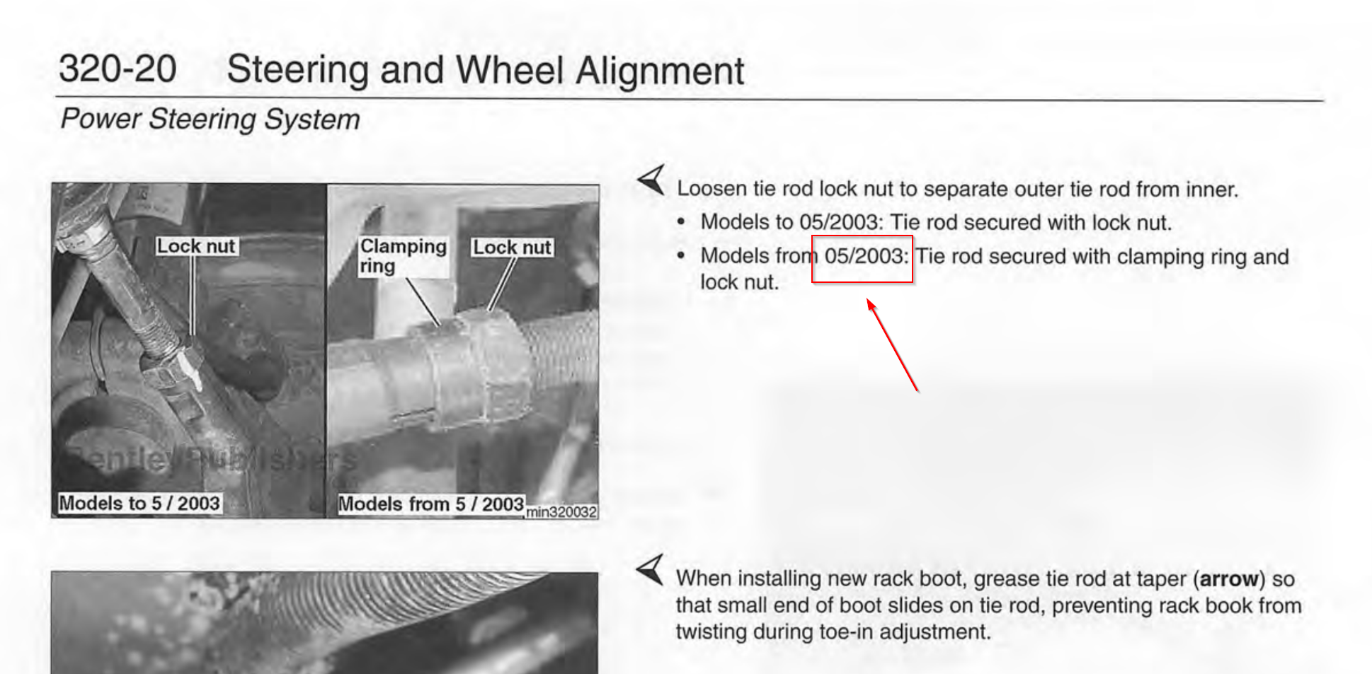

The here is problem mine is a 2004 it has different version outer tie rod version.
